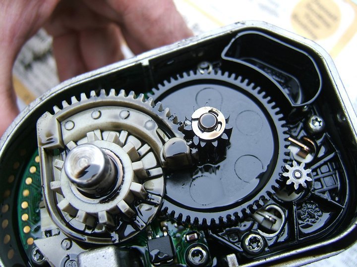

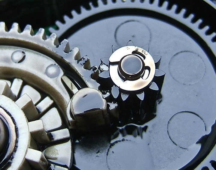

What usually happens with these is that the teeth on the cogs start stripping so might not flag as a VCDS fault until it either jams or no longer functions.
Best way it to open it up and check the state of the cogs.
