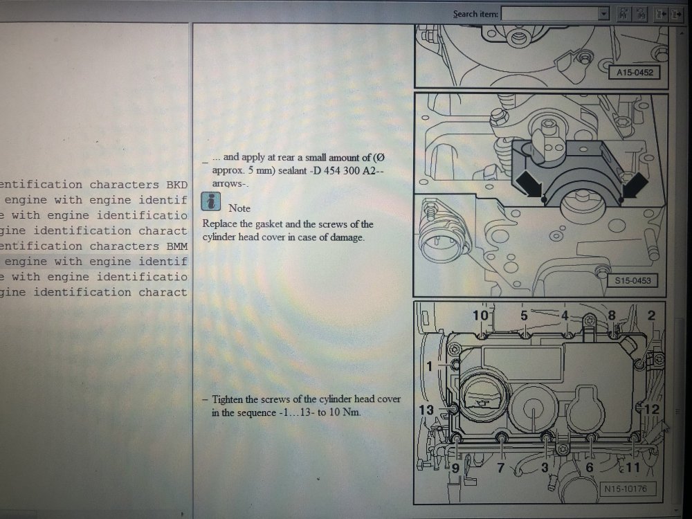

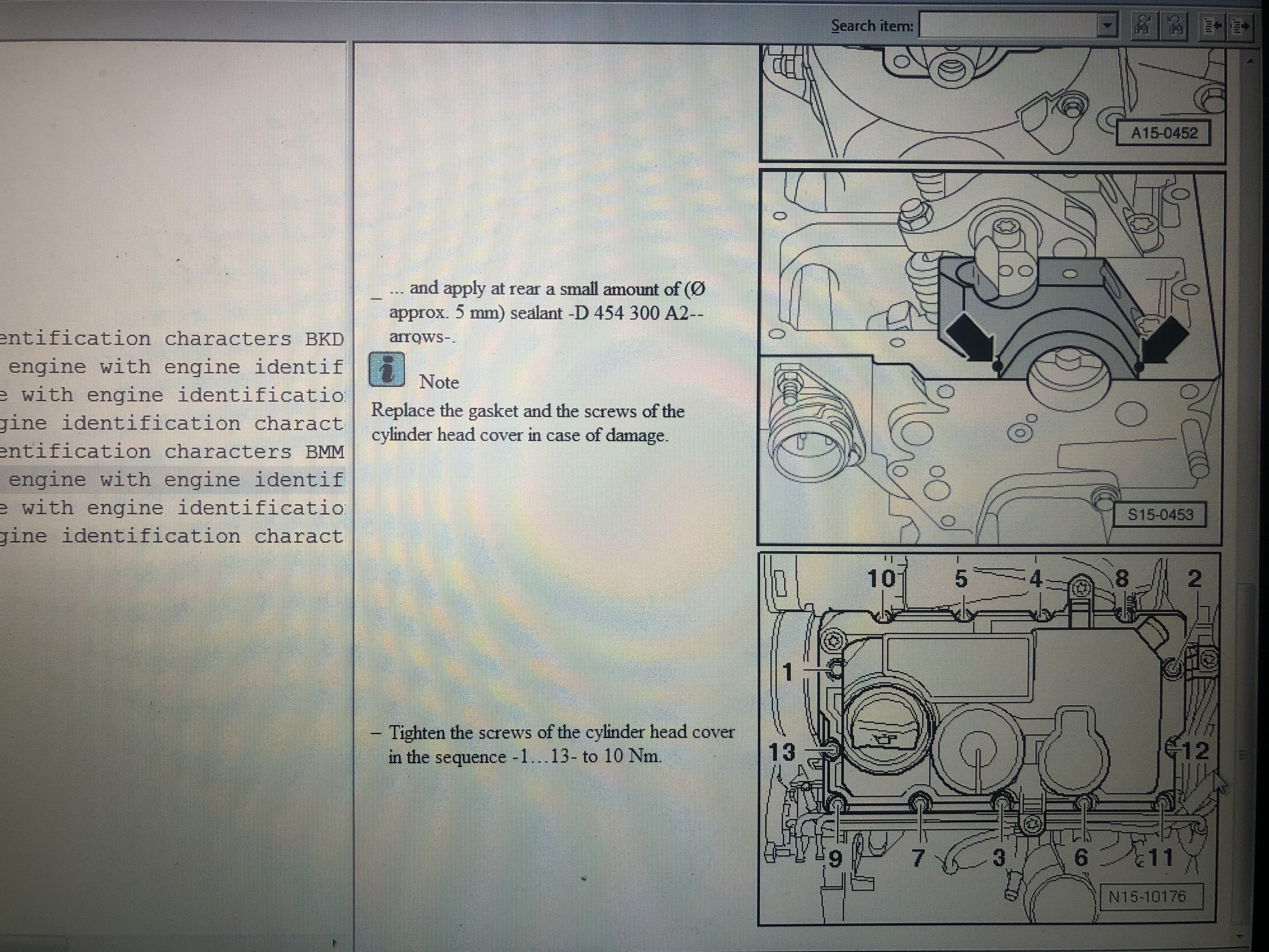

Just letting my dinner go down so got the laptop out
it asks to put a bit of sealant round the bearing cap, make sure the surfaces are nice and dry as well.
