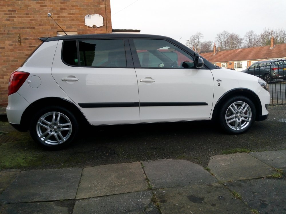

IMG_20191119_093435254.thumb.jpg.85535d8fd68edc54458201ffbadaec44.jpgHere's my Monte on 15 inch alloys and Michelin cross climate tyres, ready for winter, ride is a lot smoother.

What size of CrossClimate did you get fitted?
They look a bit small.
195/50/15.
195/55 R 15 would have been the size to match the standard tyres.

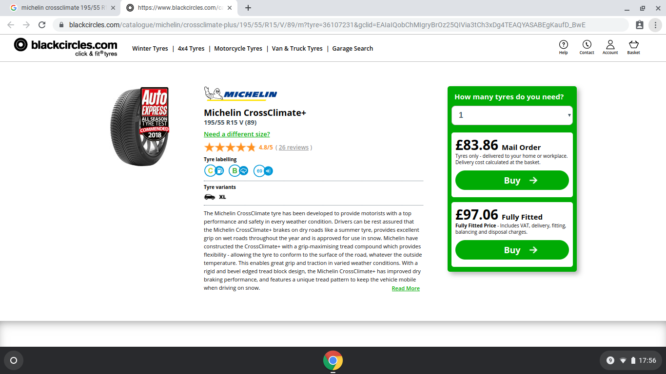

Just went with what the tyre fitter recommended.
Pity about that, did they not have 195/55 R15's or just could not be bothered!

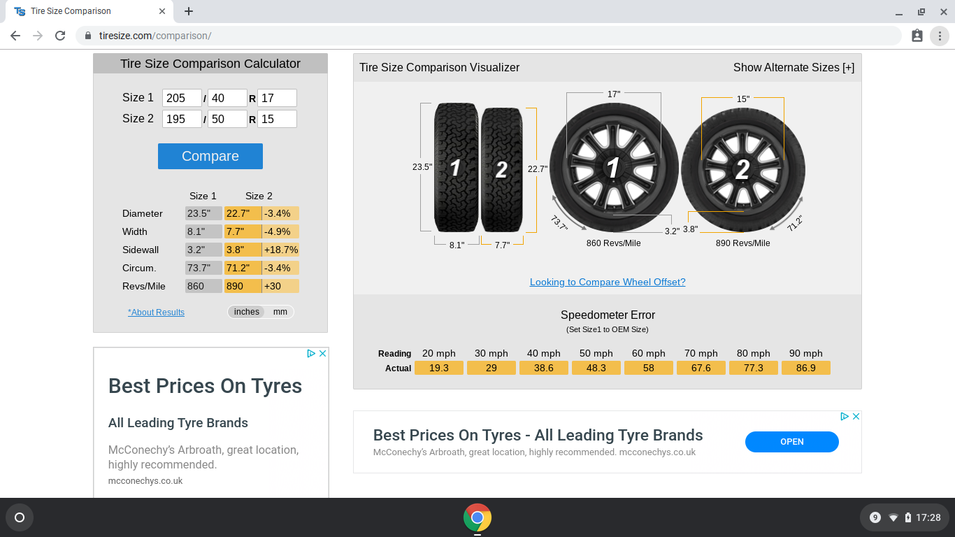

205/40R17 tyres increase your gearing by 3.4% compared to 195/50R15 tyres and 3.2% compared to 185/60R14 tyres.
205/40R17 tyres have the same outside diameter as 195/55R15 tyres, so the gearing is the same.
With 195/50R15 tyres you can lower your tyre pressures by about 2psi compared to 205/40R17 tyres. Check the inside of your fuel flap for the tyre pressures of the tyres that you can use. If it doesn't show the 195/50R15 tyre size, you can use the tyre pressures shown for either 185/60R14 or 185/55R15 tyres, as these have the same load index for non-XL tyres.
