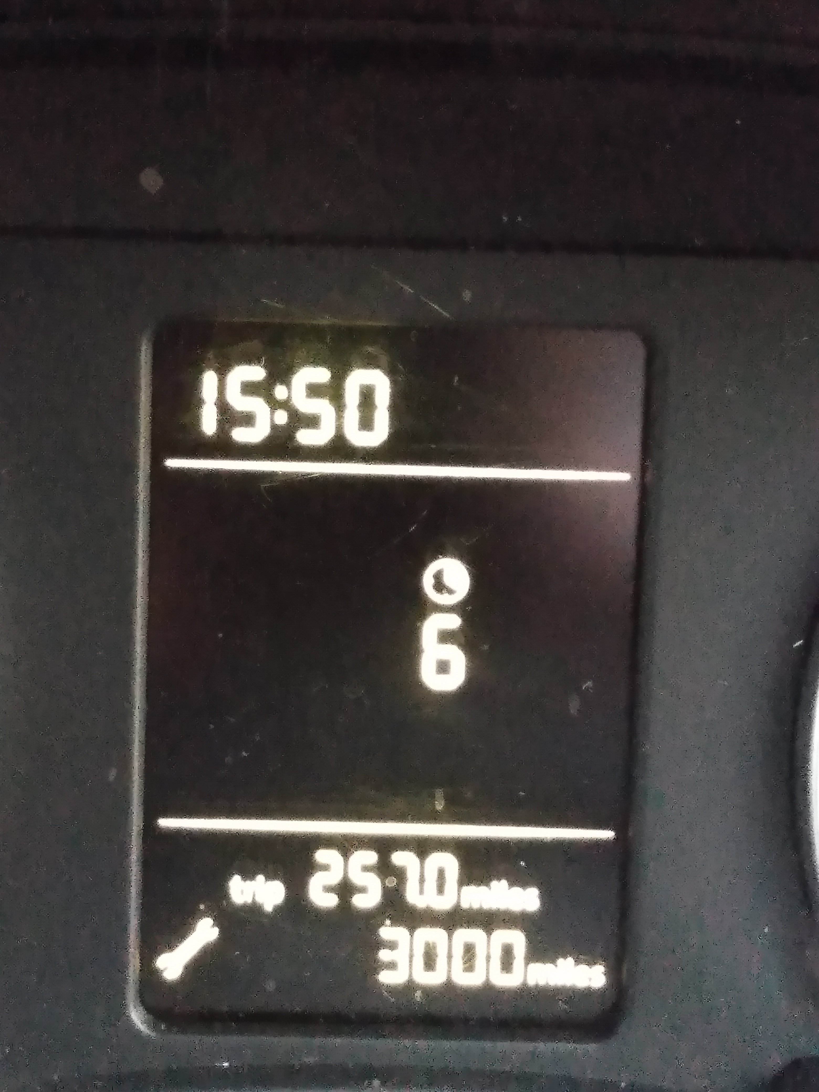

Quick question to see if anyone can tell me what a round circle with quarter filled in has appeared on the dash and counts down each day.
It's a Skoda Octavia 1.9tdi Estate...2010
Will have had it a year tomorrow and never seen it before
Attached a picture
Thanks in advance
Brian

Looks like a service interval countdown, 6 days or 3000 miles whichever comes first. It was probably serviced and reset just before you bought it.
@Sheriff Thanks for that, just found it a bit strange that the countdown should end a few days over a year since I bought the car.
I will be servicing it soon anyway so might just let it countdown and see what it says before doing it.
