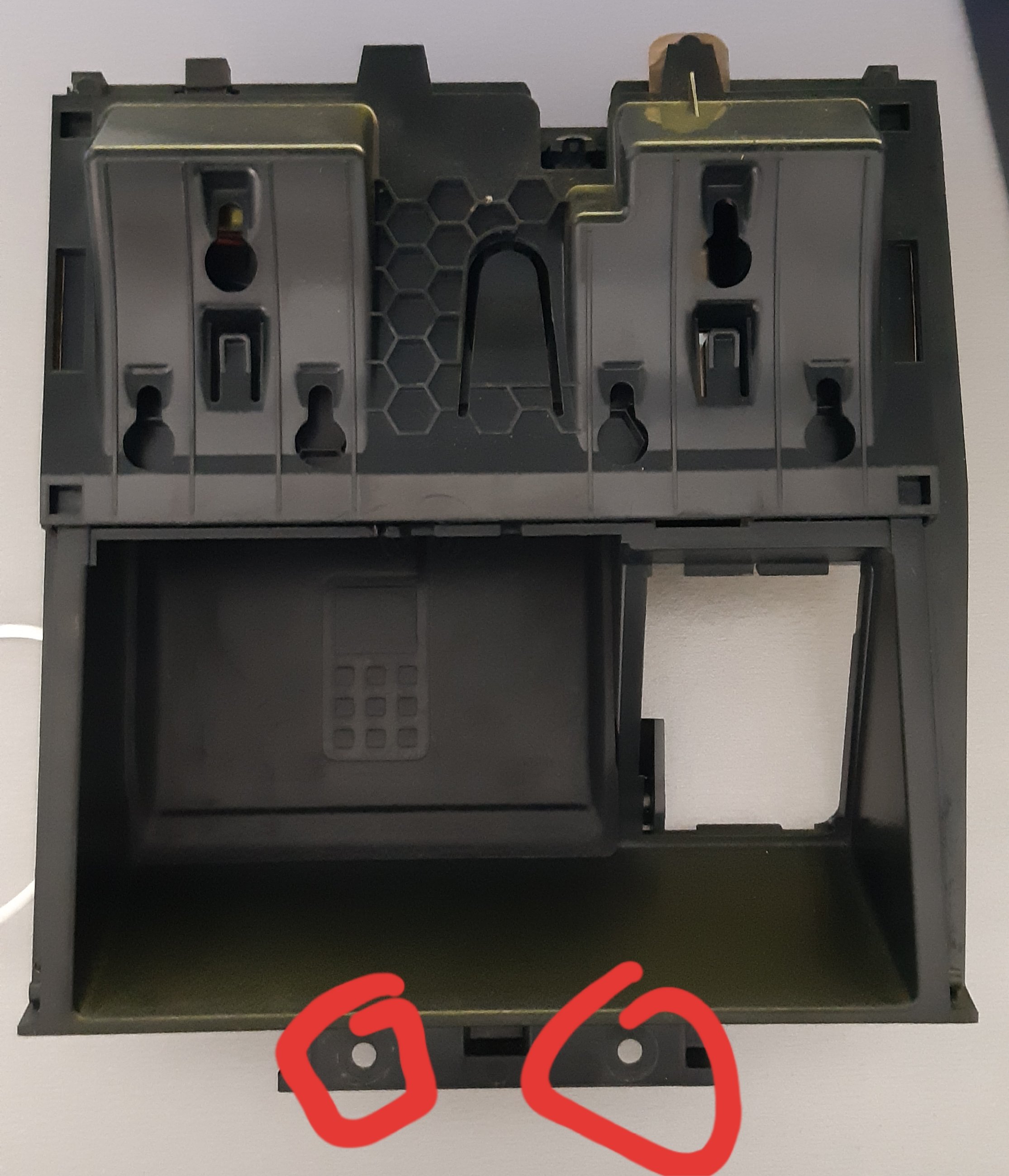

does anyone know how to disassemble the center console.
I want to replace the ashtray with a phonebox.
There are two screws in the front of the phone box, but to access it, I have to dismount the DSG cache without breaking anything 😉
Thanks for your help

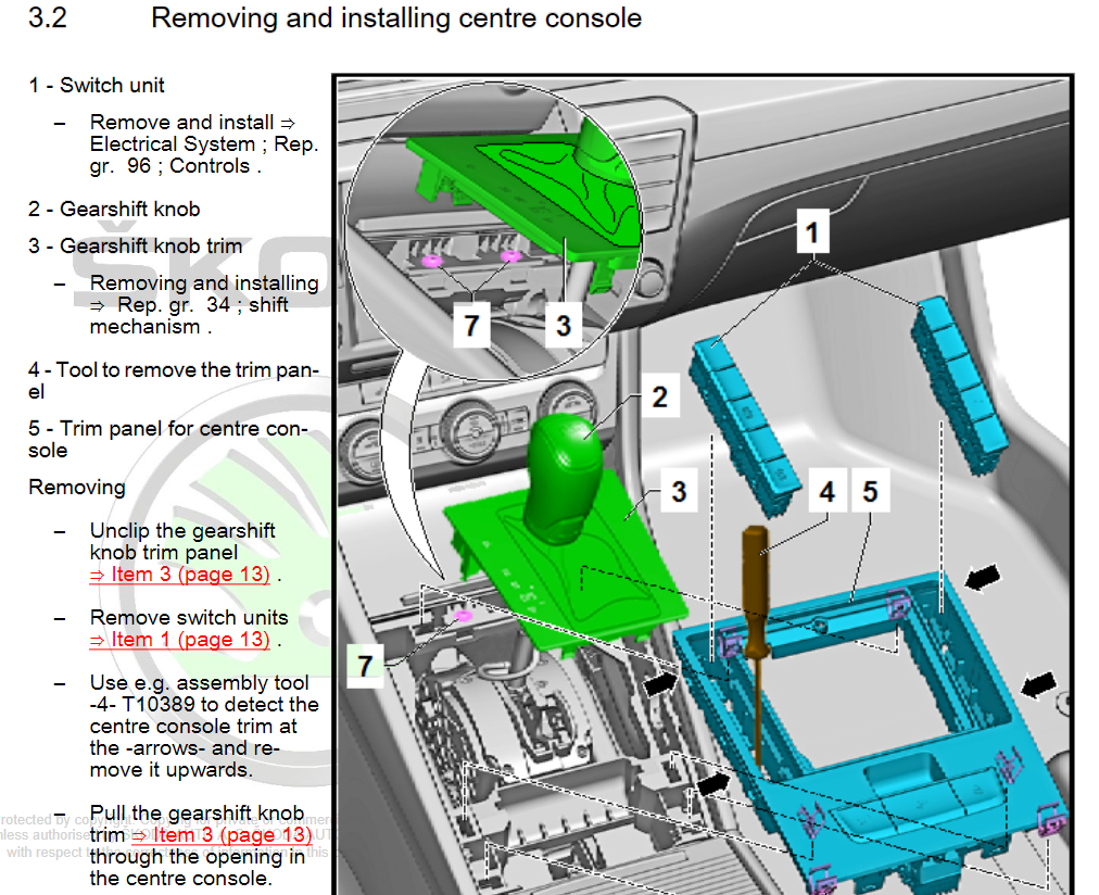

Are You looking for this?
Yes thank you very much.
Where did you find that? Can you give me the link?
Fantastic
This week, I will try to change my ashtray by a phone box.
this kind of documentation is available via official skoda technical informatio site called erWin
