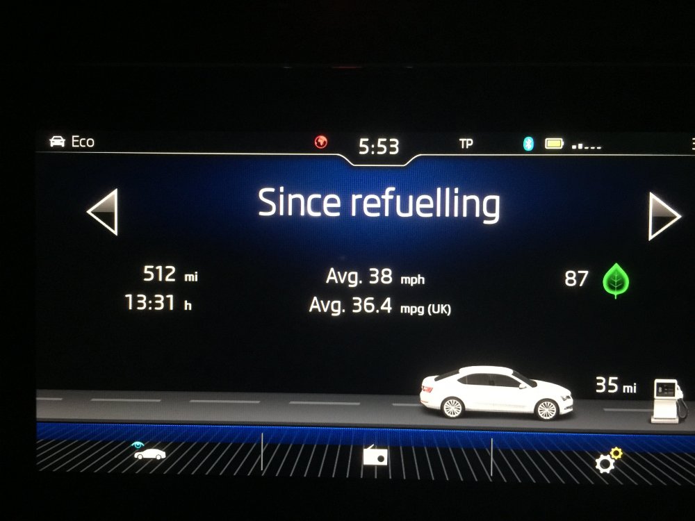

After driving 527 miles and a blizzard blowing decided to pull off the Motorway and put £20 of cheap 95 octane Sainsbury’s fuel with only 15 mile range left. Not worth the gamble and as soon as I started the engine the fuel gauge shot out of the red zone and range jumped to 215 miles with 16.8 litres put in. Tesco’s now in 2 days before my voucher expires. Photo taken after leaving the Shell garage 25 miles earlier.

That's the plan Wino as I have to pass it on the way to work so I will pull up to it buy no fuel and ask for my £10 back and see what response I get directly to my face.😉
So range shot up by 200 miles for 16.8 litres which means the average fuel consumption is expected to be 54.2 mpg
💹 Another Shy record!!! Yahoo!!! Congratulations!!!
Or did it shoot up by 200 miles for (16.8 + 7) litres which is an expected consumption of 38.2 mpg......dohh...
So the 7 litres have finally come out of hiding....or Sainsbury's gave you 7 litres too much fuel...🤔
As I tried to explain earlier (not that shy will listen anyway) a tiny refill causes only a small deviation at the (relatively sticky) fuel level sensor which the computer dismisses as variation due to inclination, fuel slopping, stiction, temperature/pressure/evap system, shy's body weight causing the car to lean etc. etc
The fuel gauge is not driven directly by the sender but by an algorithm. The alternative would be a fuel gauge that moves nervously to full or empty everytime you brake, turn or go up a hill.
Next, your water temperature gauge, is it really exactly 90 deg C constantly in your engine?  Really? Discuss......
