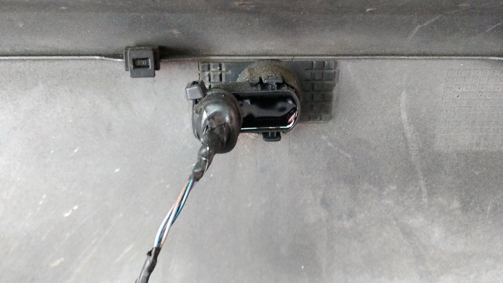

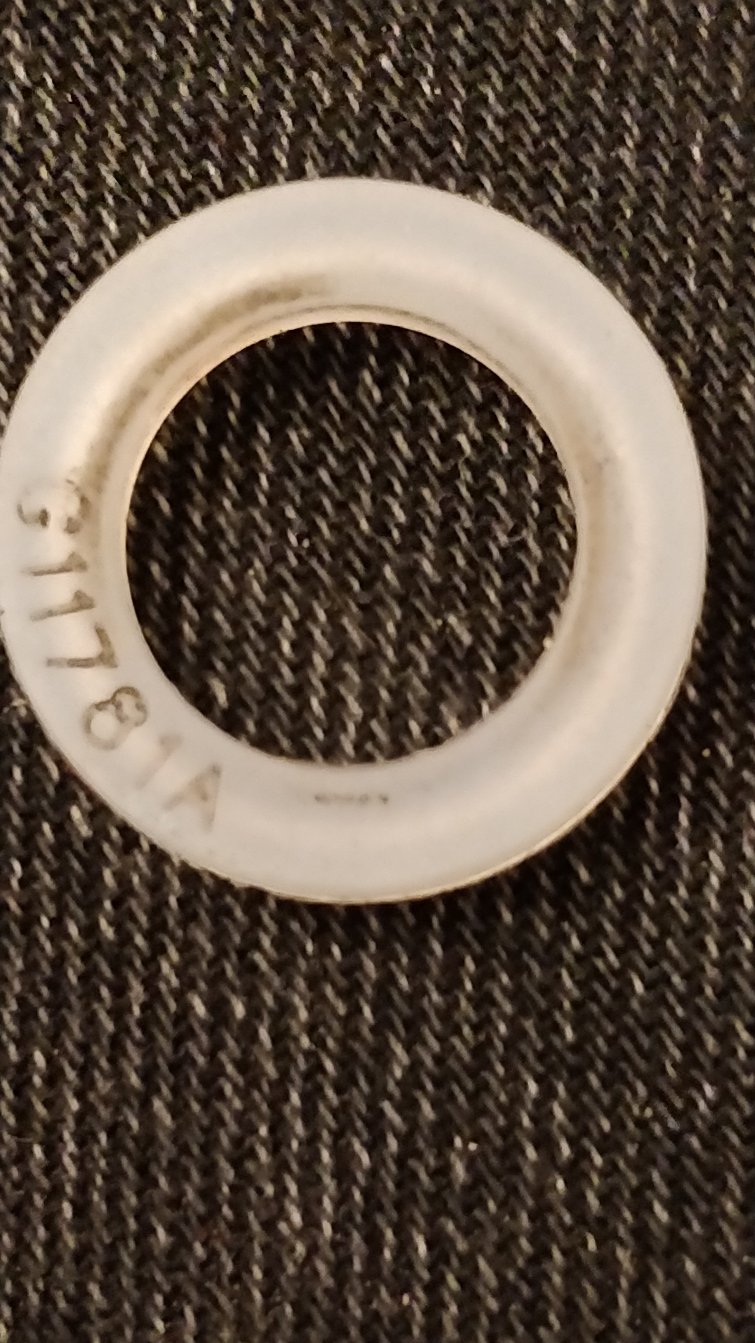

I brought originals as I've had trouble with the cheaper ones failing. Also make sure you get the little white rubber ring that goes around the round end before the sensor clicks in.
Sensor 5J0919275A
Ring 5J0919131

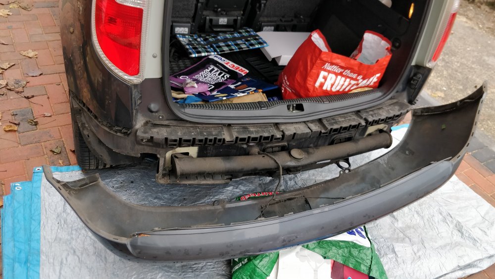

They were about £60 each so all 4 were not cheap, but after too many failures of the cheaper ones, they kept failing in a few months. I decided on originals. Maybe I was just unlucky earlier but the originals never failed.
I simply painted the faces with a brush before fitting and they looked fine once fitted. I also took the opportunity to wrap the push on connections in self amalgamating tape to keep any water out.

@aubrey, why did you fit new rings, they should be able to be reused I'd think, strange thing is, Audi provide maybe 3 different colours of rings to help blend in with the paintwork, VW seem to only supply black ones which don't quite blend in with the reflex silver paint on my wife's Polo - white or translucent one have!
Because I didn't have them on my old sensors. In fact I only saw they were there looking at those exploded parts diagram. I agree if you have then then of course they can just be changed over. Those I brought from Skoda parts were white as in the photo I added. I did always wonder why they were missing on a vehicle I purchased new. They are very cheap to buy though.
Possibly just sloppy production planning on the part of Skoda, I bought 4 when I retro fitted front sensors to my car.
