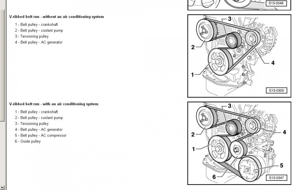

Need help again. I want to replace the serpentine belt on my 3 cylinder 1.2 Fabia 2011 Mk2. I thought it would be a simple job, release the tension pull off the belt and fit the new belt over the 6 pulleys
It looks more complicated then that.
Do you have to remove the inner wheel liner and lower the engine

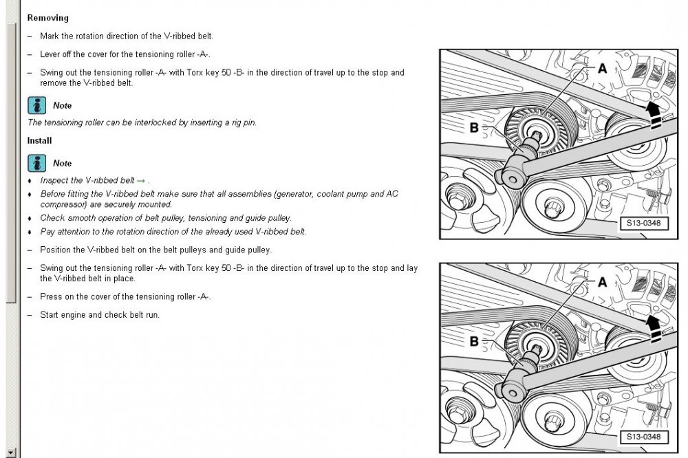

How do I remove the idler and tensioner pulley and how do I re-tension the belt
The videos on the net look different to what I imagined
Any help and advise would be appreciated
Dave C
auxbelt3cyl.thumb.jpg.ff85516664d644bf35f79aaf5eb756fb.jpgauxbelt3cyl2.thumb.jpg.7fcf3c24b401b0f54d209814ca0e11ee.jpgSeems pretty simple....
