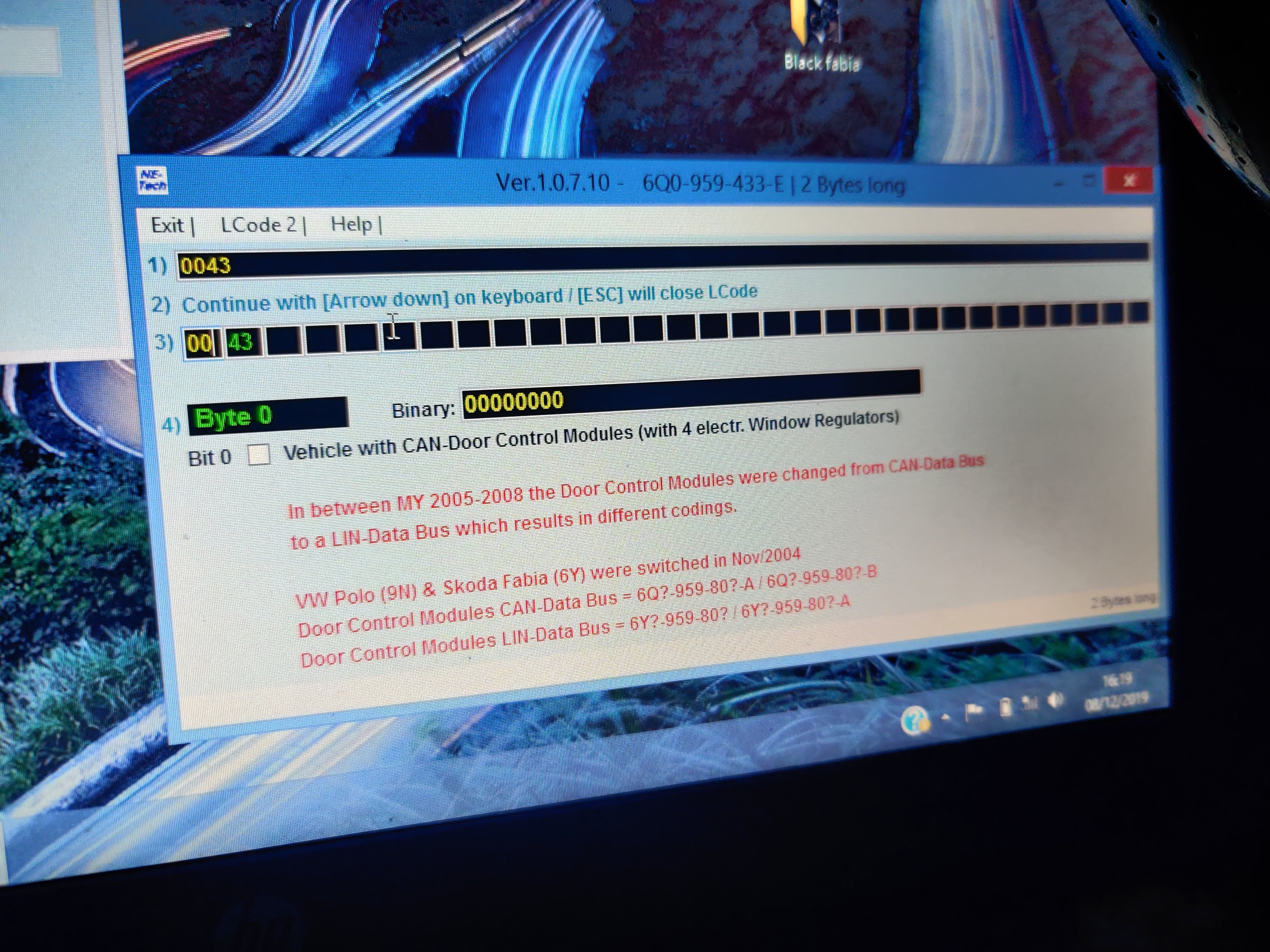

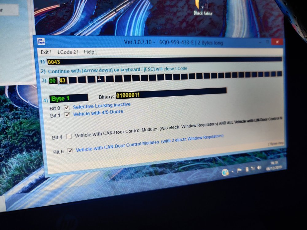

Rear driver's door won't lock, I believe something has been changed in VCDS because beeping on unlock had been turned on and other irritating things
If anyone could walk me though how to fix this it would be great
