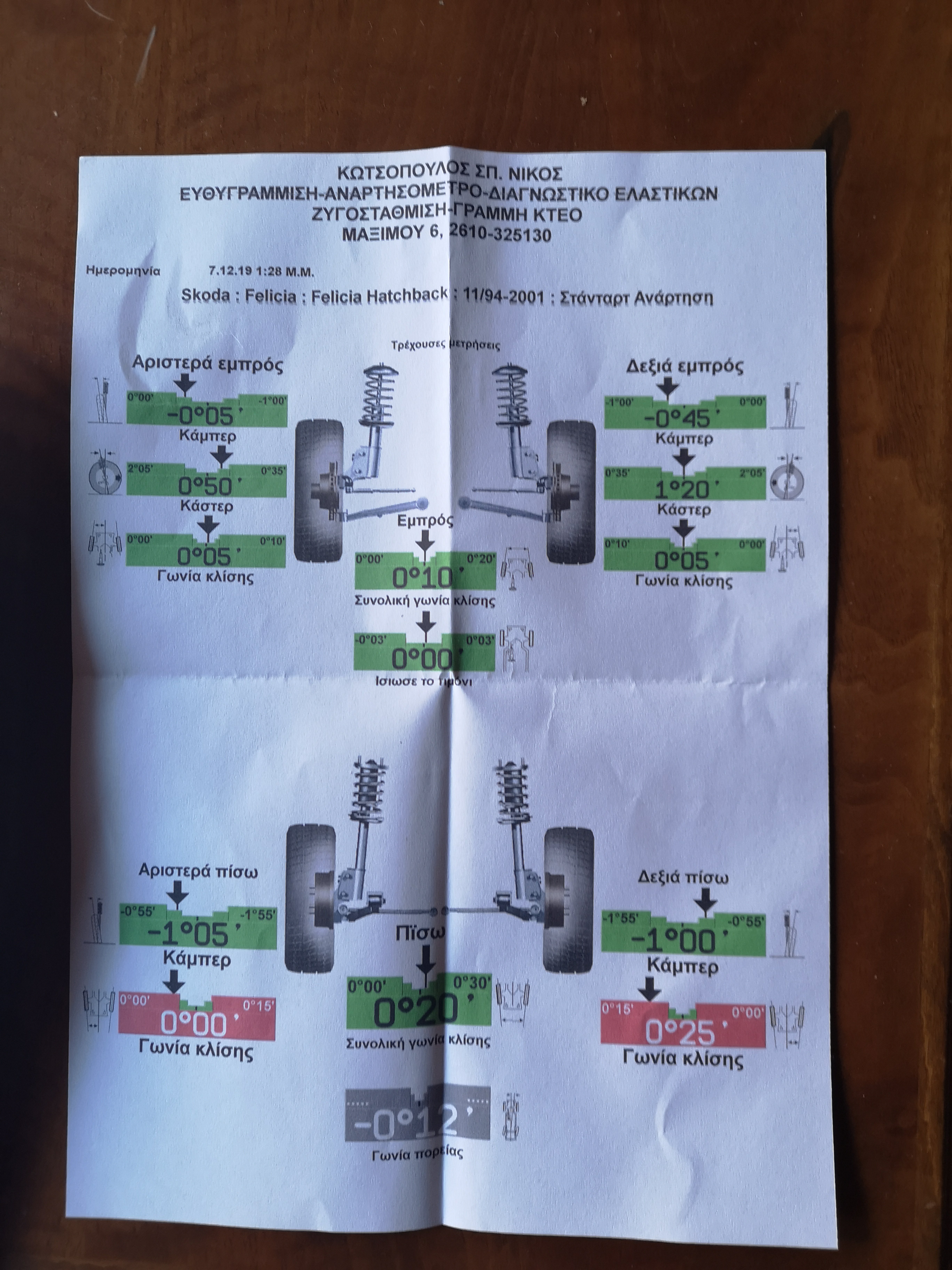

Yesterday I aligned my felicia 1.3l mk2 sport line here are the results?
What do you think 🤔?
Is it good?
Also do you know of any way to adjust camber and caster on my felly?
Camber-caster plates from a different car possibly?
Moving the subframe?
Who knows

On 08/12/2019 at 23:05, Thefeliciahacker said:
Is it good?
WoW... You get fancy print-outs (with colors!) after wheel alignment jobs? Yeah it's good. :D
The computers of wheel alignment shops have all the values prerecorded for almost all cars. When they install their probes to the wheels, they see the the upper and lower limits on the screen.
I've found these values for Felly. (Source: jltechno)
I don't read Greek, but that's the sort of output I would expect from an outfit using a Hunter alignment rig. Red for out of spec and green for in spec, for each of camber, castor and toe value for each wheel, before and after adjustment.
14 hours ago, KenONeill said:
I don't read Greek
Here is the translation:
Left Front - Caster, Camber, Leaning Angle
(Center) - Total Leaning angle, Level the steering wheel
Right Front - Caster, Camber, Leaning Angle
Left Rear - Camber, Leaning angle
(Center) - Total Leaning angle, Course angle
Right Rear - Camber, Leaning angle
We'd say LF - Caster, Camber, Toe (in/out).
Not least because camber and lean angle are 2 ways of saying the same thing.
Anyway, more to the point is that, aside from language, that's what I'd expect a Hunter printout to look like.
Depends what kind of equipment has each repair-shop.
