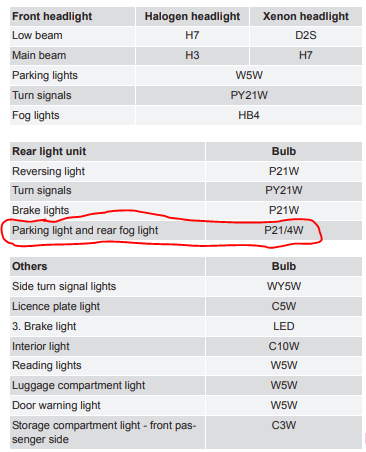

It was also very odd with the side/light fog light, if I wiggled it about the brighter filament would come on as the sidelight and the less bright one would then operate as the brake light. Yeh they all looked to be the correct bulbs, the brake light bulbs I put in the other day for some reason didn't work (maybe just age as I've had them a while, but the filament looked fine), so the fresh ones today did the job. I made sure the side/fog was a P21/W4, NOT W5 like Halfords and most websites seem to think. Another odd thing was the third brake light in the spoiler came on as a sidelight as well for a bit. Me thinks something weird is going on with the wires somewhere, anyway, all working... for now.
Was just going to ask, were you using P21/4W, a lot of people try to fit P21/5W and then get weird side effects...
