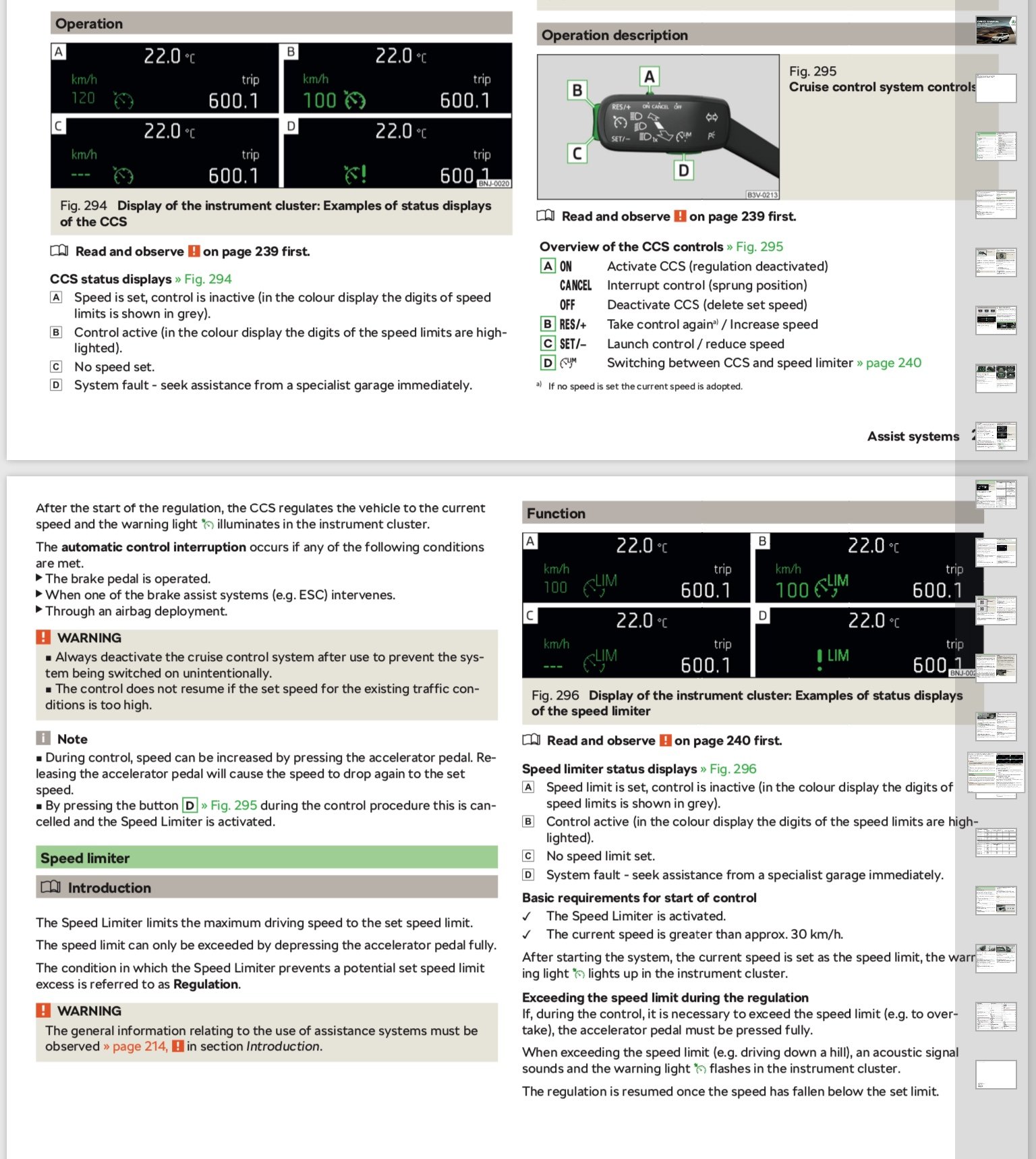

Ok picked up car yesterday and am in love already but one thing I cannot change.  On information display between dials where the total mileage of car should be displayed in bottom left I have the symbol for speed limiter with no limit set.  For the life of me cant work out how to change it back to total mileage and have given up with the Da Vinci code manual lol.

Turn off speed limiter by setting toggle A to off.
You can choose between speed limiter or cruise control by pressing button D on bottom of stalk.
Hi Kenny tried that but still cant get it to display total mileage
Do you have ACC and confusing speed limiter with ACC target speed
The lower left stalk controls it, see if it pushed forward towards the dashboard, might be getting this wrong way around from memory
Hi Surrey John - no ACC just normal cruise control
Then turn off the A switch - to turn off cruise control - should then show distance traveled all the time - not just when you are stationary.
All sorted should have looked on stalk properly in usual Skoda style off button is too the right not the left lol
