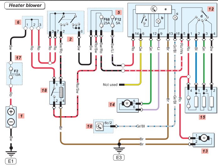

From what I can make out looking at the Haynes wiring diagram, the blower switch sould have live at its red/white wire. This comes from fuse number 68 (25A). Check for 12 volts at that fuse as the only circuit it feeds is the blower.

Have you checked for 12 volts at the fuse connectors though? I mean by removing the fuse and checking the metal connectors. One side should be live with key on. We need to establish if a feed is getting as far as the fuse. If it's not getting to the fuse then there is indeed a relay shown in the manual that is next in the circuit - item 18 here.....

If there is power at the fuse then the problem can only be after it. It can't possibly be the relay as there would be no power at the fuse because the relay feeds the fuse. Next thing would be to establish if there is 12 volts getting to the red/white wire at the switch.
This really isn't a difficult problem to fix, you just have to be methodical.
Speed 4 totally bypasses the resistor so I doubt very much it's anything to do with that.
