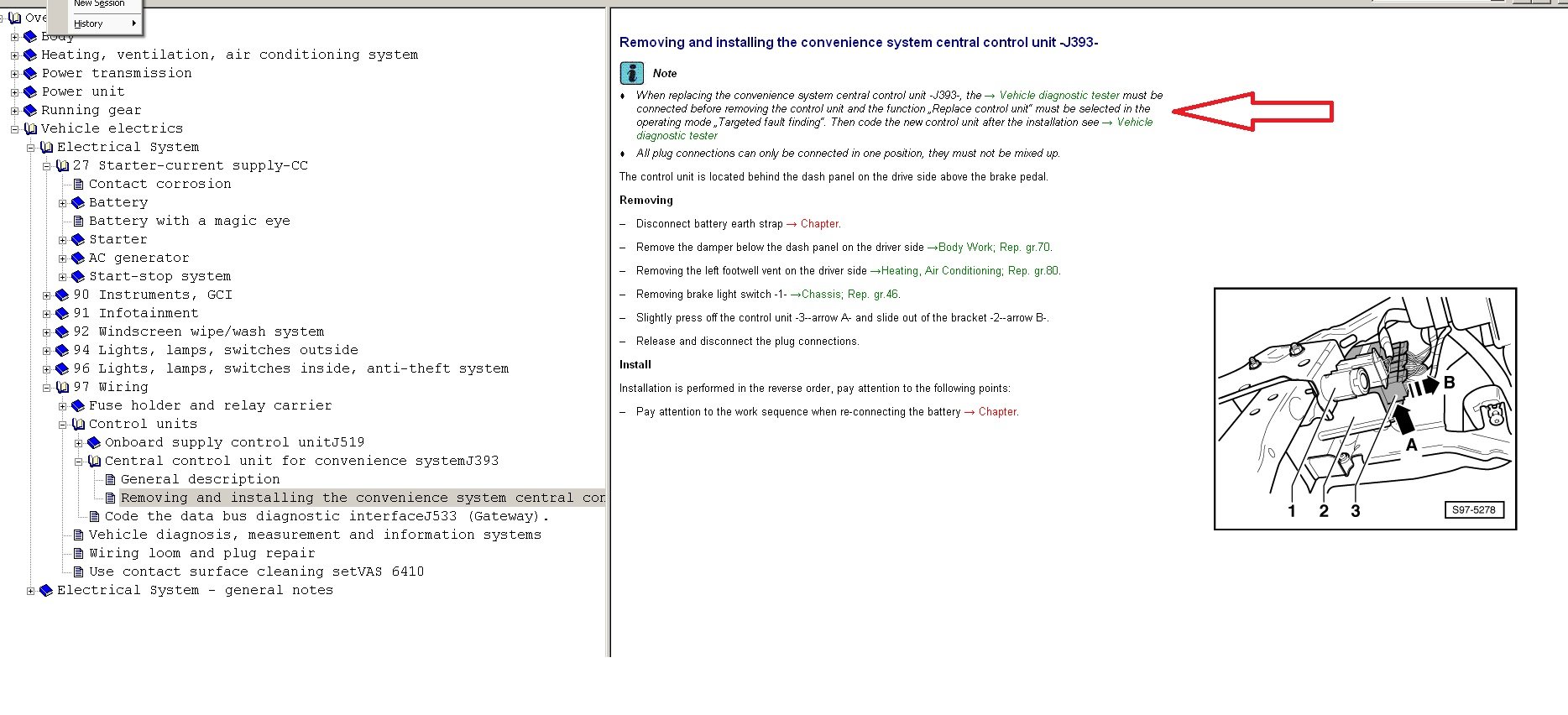

Unit WILL need coding 100% and thats after copying code from the old one, unless you know all the coding for the equipment fitted to the car. (see diagram / arrowed section)
