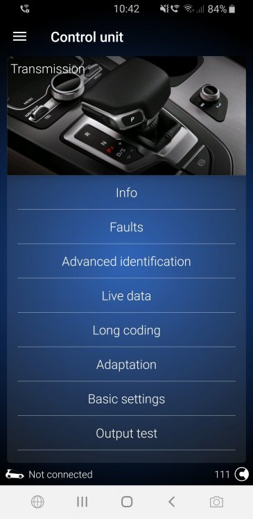

In OBD11 do a scan of the car, it will pick up any faulty control units, when complete, go back to the main screen and find the Info line.
Touch that and it'll come up with another and provided that there's a network connection, it should check if there's a new software version available..

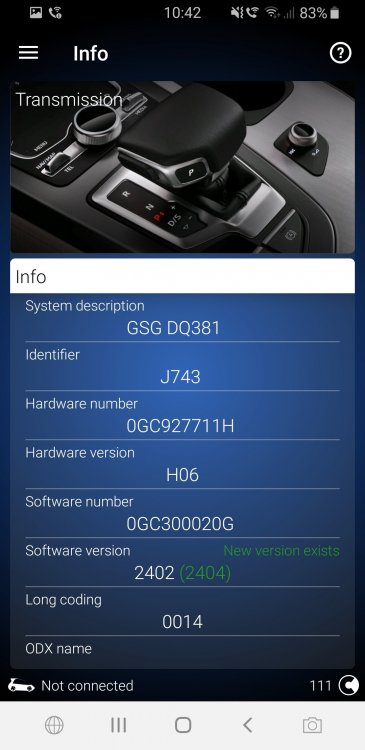

As you can see from the second picture it has found that the current software has been superseded by a newer version.
This applies to all the control units, you just need to check each one individually.
