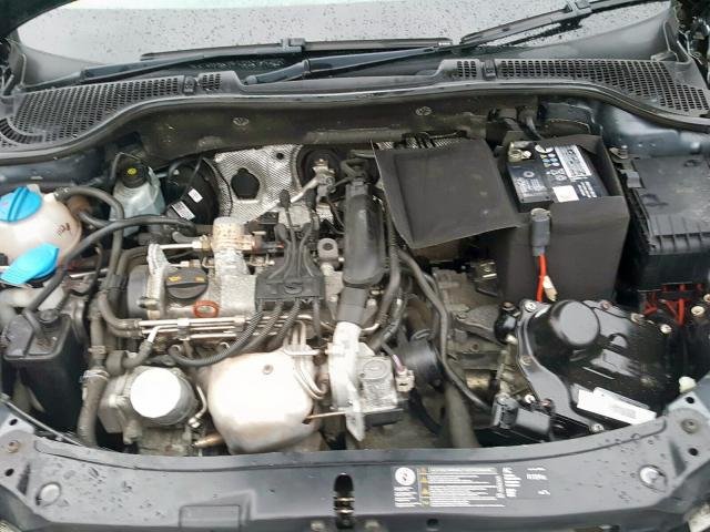

I am new to Skoda and new to this forum I am looking for some advice I recently brought a 2011 Skoda Octavia SE TSI 1.2 Automatic at auction. I was told that it needs a new gear box as you can see from the photo enclosed the part that should be under the car is just left loose on top of the engine and leaking fluid. This is a great shame as there is nothing wrong with the car body work wise and it is very clean for 114023 miles. I did put it up on Ebay for spares or repair but I am in two minds what to do any advice would be greatly appreciated.
The only part I can see vaguely conforming to that description is the battery box cover; 10s to close it.

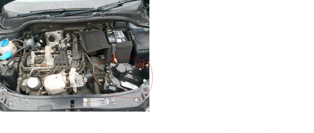

it starts but does not drive
There is fluid Leaking from this part in the photo

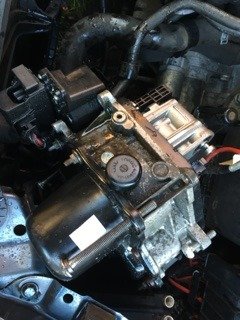

I had a guy do a diagnostic check on it and he told me gear box problem with gear 6 to 7 ?
Leak from motronics housing, dq200 indicates the common failure of the hydraulic pressure accumulator (cracked).
Repairable with new accumulator.
See this thread. Other videos are on YouTube showing repair procedure.
Thank you would this stop it from driving ?
Yes, because the accumulator is leaking, it cannot build up enough pressure to operate the clutches.
It would also throw up a P17BF or possibly  P189C error code on diagnostics.
That bit you have circled looks like the mechatronic unit which controls the gear selection on the DSG gearbox. Not a cheap part to replace sadly.
Edited by Plantman
It is a shame as it is a really nice car as I said I have it up on Ebay spares or repair but in two minds to keep it or sell it I have been helped alot by the members today and feel better about it as now I know just got to think what to do next.
The mechatronic unit is probably £1200 or more plus fitting new from Skoda so depends if you can find someone to supply and fit that unit for a reasonable price, perhaps second hand or reconditioned.
Depends on how much you paid for the car in the first place as well of course and also what else might be wrong with the car or its components.

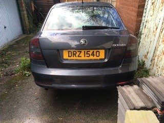

Strange for the previous owner to tint the rear lights, usually reserved for boy racers!
A mechatronics failure will often result in a 'spares or repair' listing on eBay.
Yes I thought the same but I am no boy racer lol I have listed it on eBay.
