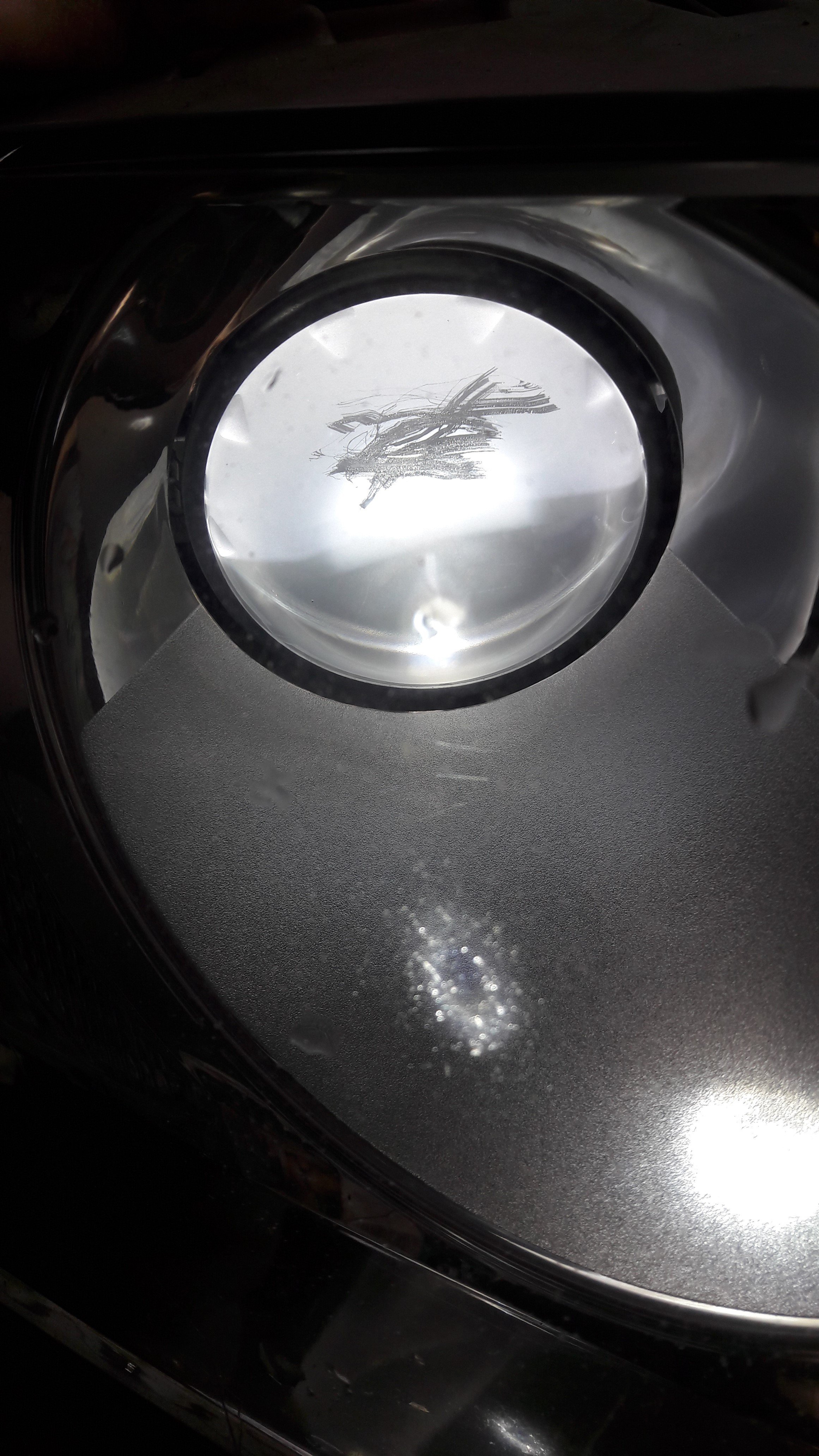

I've just cleaned the inside of the lenses on mine, (the 'eye' piece from inside the headlight assembly), after reading someone else's mention of there being a build up of dust (or muck) on theirs.
Mine is 14 years old....... there was a considerable amount of muck on the lens....... I have taken a photo.......... with a little of the muck removed and then a torch shone through it. I will post if i get chance, but definitely worth taking headlights out and cleaning inside the lenses IMO.
