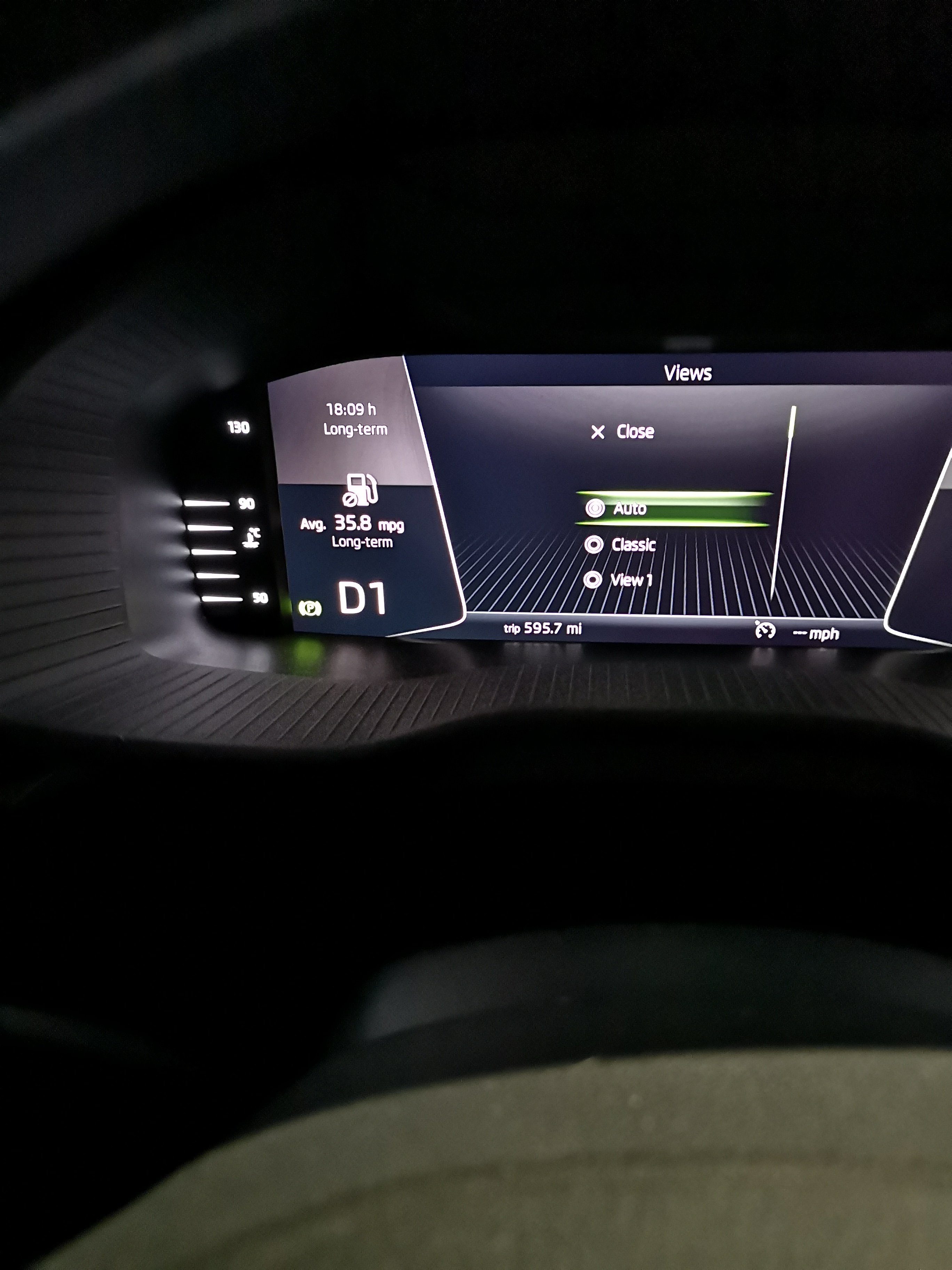

I have a 68 plate kodiaq. My question is on the digital dash. A few weeks ago I was bored and messing around in menus and happened to change a setting or customisation so that the digital dash on the modern look displayed the long term driving data (as you can see in the pic, top left and middle left; driving time and consumption). I can't figure out how to change this back to the since start data. Long term data is largely irrelevant to me and I liked having the since start data displaying to see how much time I have wasted commuting!

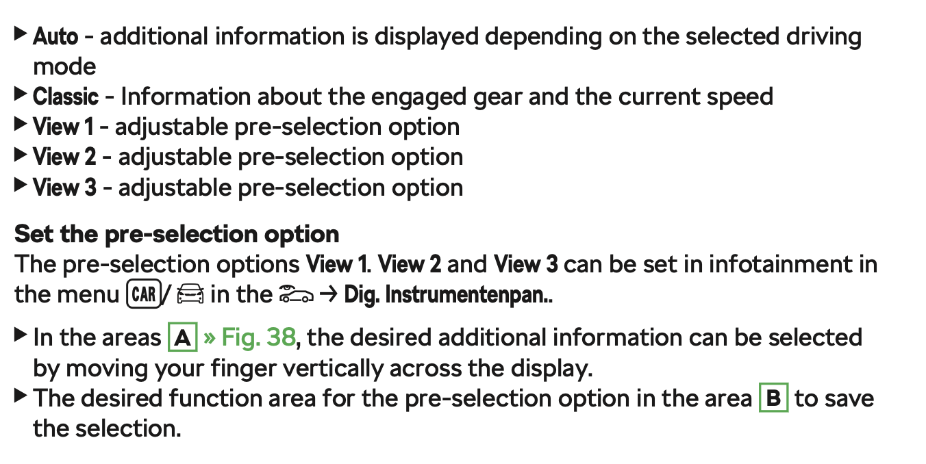

I have the VC in my Octavia Vrs. I don't think you can change the settings in Auto or Classic,  you need to alter things in one of the other views and use that view.
368427427_Screenshot2019-12-22at10_22_49.thumb.png.72ff92e2b926c6274bae0fec030f1733.png
Screen shot from the Octavia Hand Book
Edited by Auric Goldfinger
Yeah seen that, the issue I have is that I can't get the driving data to show since start, It shows long term i.e. long term consumption and long term driving time.
I have tried navigating lots of different menus but doesn't seem to work.

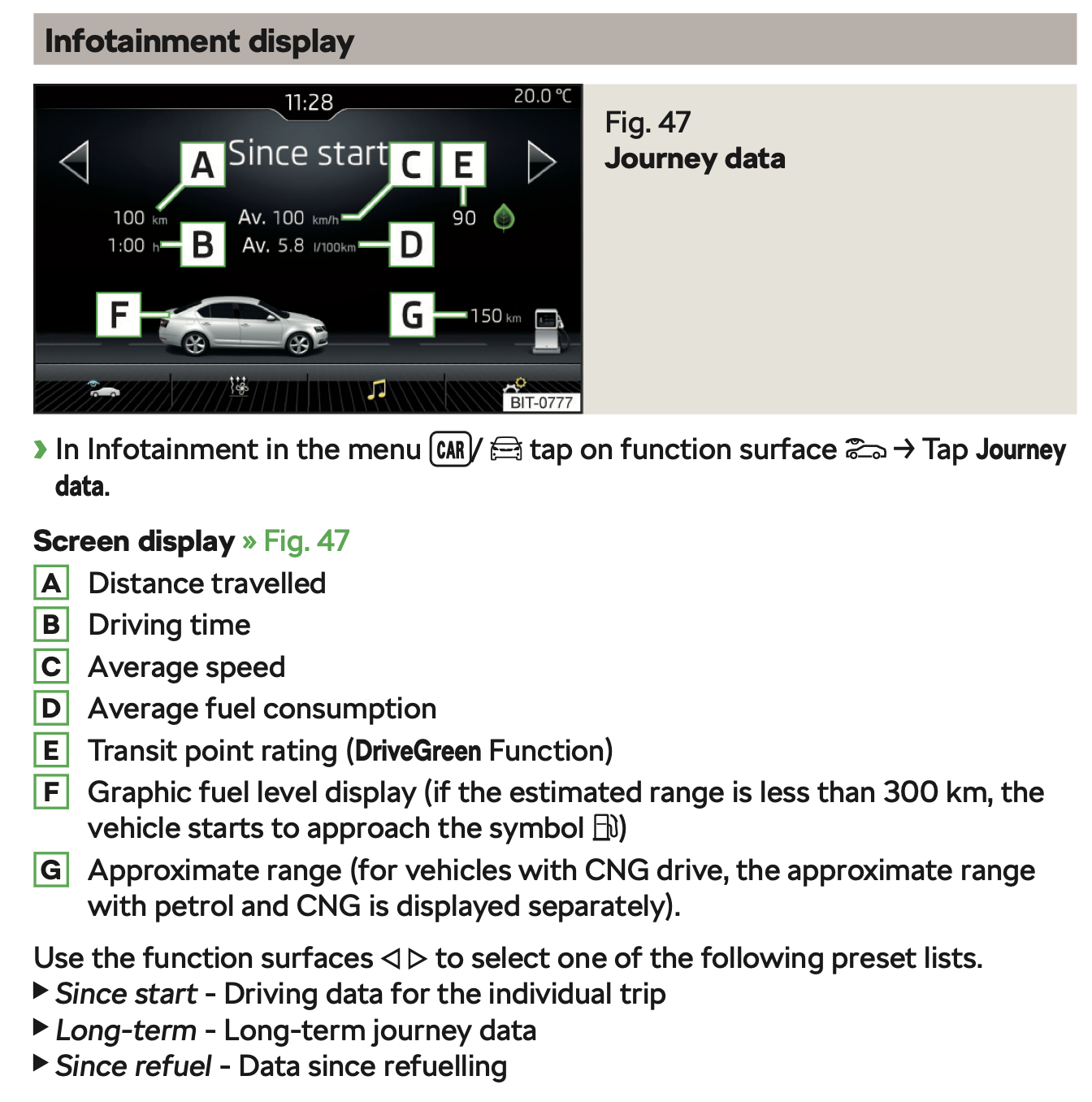

In the menu you posted there isn't an option to change the data to since start, short or long term.
I'm out in the car later, I'll have a play and get back to you.  Just a thought, if you press " Car " on the Radio you get a picture of you car on the screen Is the information you require there.

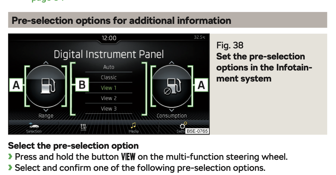

Had a play around myself but still can't figure it out. The menus don't seem to let you change whether long or short term or since start is shown. But I've done it somehow as I used to have since start displayed but now it's long term...
