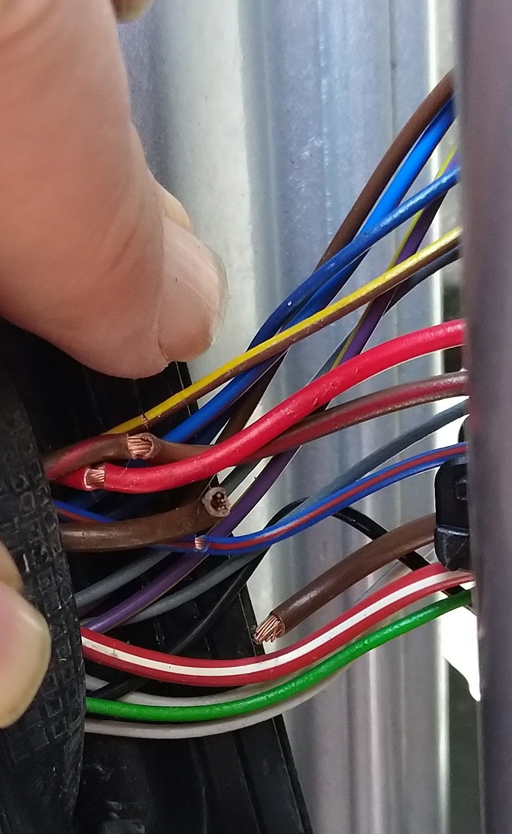

Thanks for the pointer to the door wiring. Doesn't look too healthy, does it? Shame as I was hoping it would be the fuse.
The wiring is quite tight. Does this involve a door off to resolve or is it possible to get the door side rubber boot off? Is there a connector behind it ? I had a go but the boot didn't seem to want to come off easily at all.
Classic "broken". I think  the parts are only about £20 from a dealer.

it is the whole door harness and you have to remove door trim and speaker to do it, this allows easier access to the door boot as it can be tight and easily damaged.
You will need to drill out speaker rivets to remove it and obviously have rivets and riveter to refit.

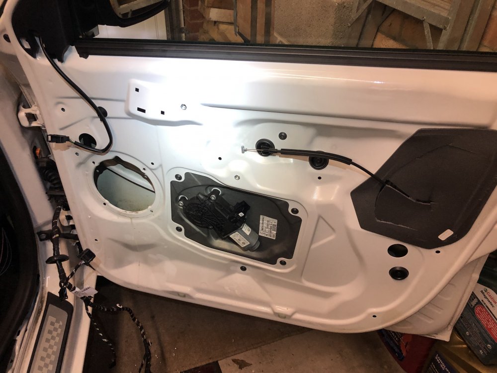

Heres a piccy showing the speaker and loom removed, and what it looks like back together.
Thanks for the reply. Now I've seen inside the door, it doesn't seem too bad. My mate was moaning about all the clips breaking off etc but, if it's just the speaker, this doesn't seem so bad. Are there a lot of clips on the Mk2?
