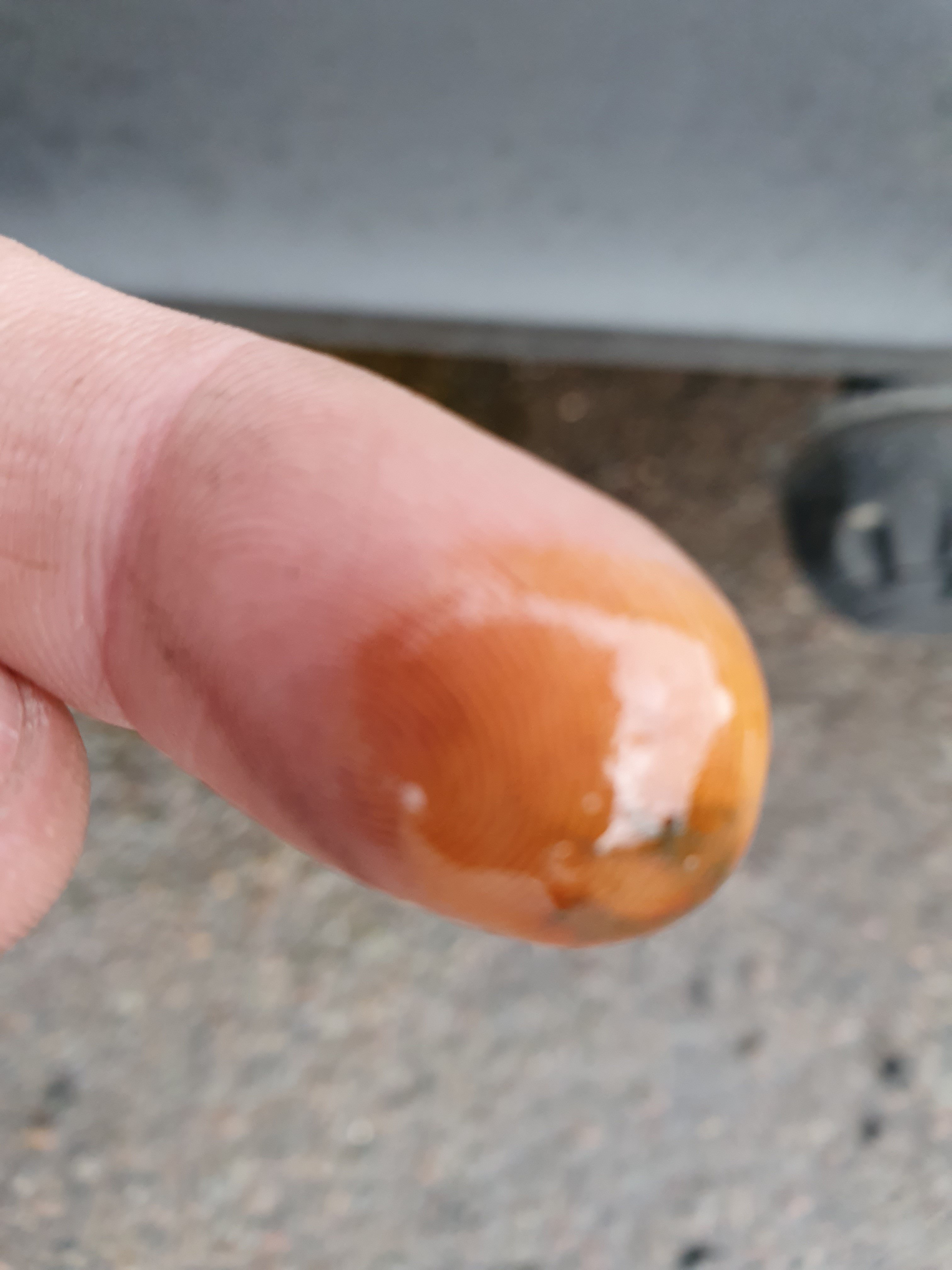

2014 Fabia diesel with just 24000miles, was travelling at approx 50mph up hill, glowplug light illuminates and within a few seconds the revs hit 7000rpm and smoke fills the car. Switched straight off and on looking there's a pool of oily orange liquid come out the exhaust pipe!
Recovered car home and next day checked oil and water -both OK. Try to start car and it starts fine and sounds fine. Leave for a few minutes and raise revs. Engine gets to approx 2500 rpm and revs shoot up off the gauge again and more orange liquid from the exhaust.
The only liquid that could come out the exhaust as a "pool" is coolant. Bad head gasket.

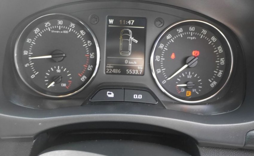

Doesn't feel like coolant as has a definite viscosity to it and orange rather than the pink coolant in the system. Don't understand the over-reving either. When the engine takes off the needle spins right round to 7000+ rpm in an instant.

Its def running on its own oil / fumes to runaway on its own.
Sounds as already mentioned the headgasket has failed
