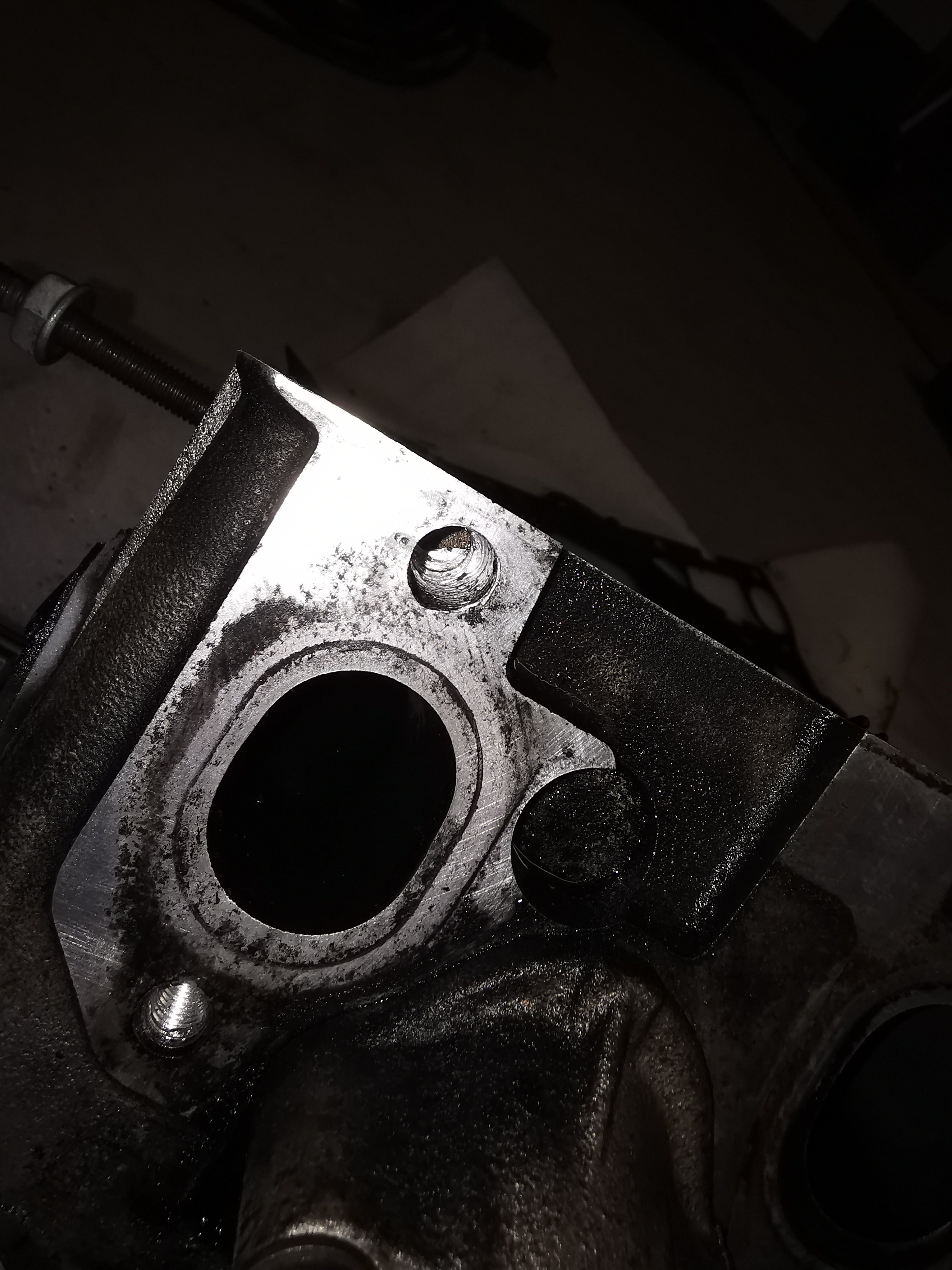

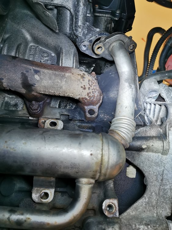

The workshop said it was the egr that was leaking and wanted 25000sek for the job. Was just about to take off the egr when i saw that one bolt was missing from the header and to me it looks like there's where the leakingproblem is. What do you guys think?
Try more like 4 bolts. I'm not saying this is the problem but that's how many I can see missing in that picture!

If the answer to the above is exhaust gases then yes, the manifold leak would be my favorite and certainly the cheapets and easiest to remedy.
Sorry about not making that clear. It's exhaust gases that is leaking and you only notice it when you strand still with the car. The garage just asumed it was the egr valve i guess quz it's rather common.
Definitely replace the stud and check, if there is still a leak it could be the gasket is burned.
Minor manifold leaks usually only manifest themselves and are audible when running under load, driving up a hill on full throttle etc not at tickover.
In any case dont rush to replace the expensive bit till you are sure.

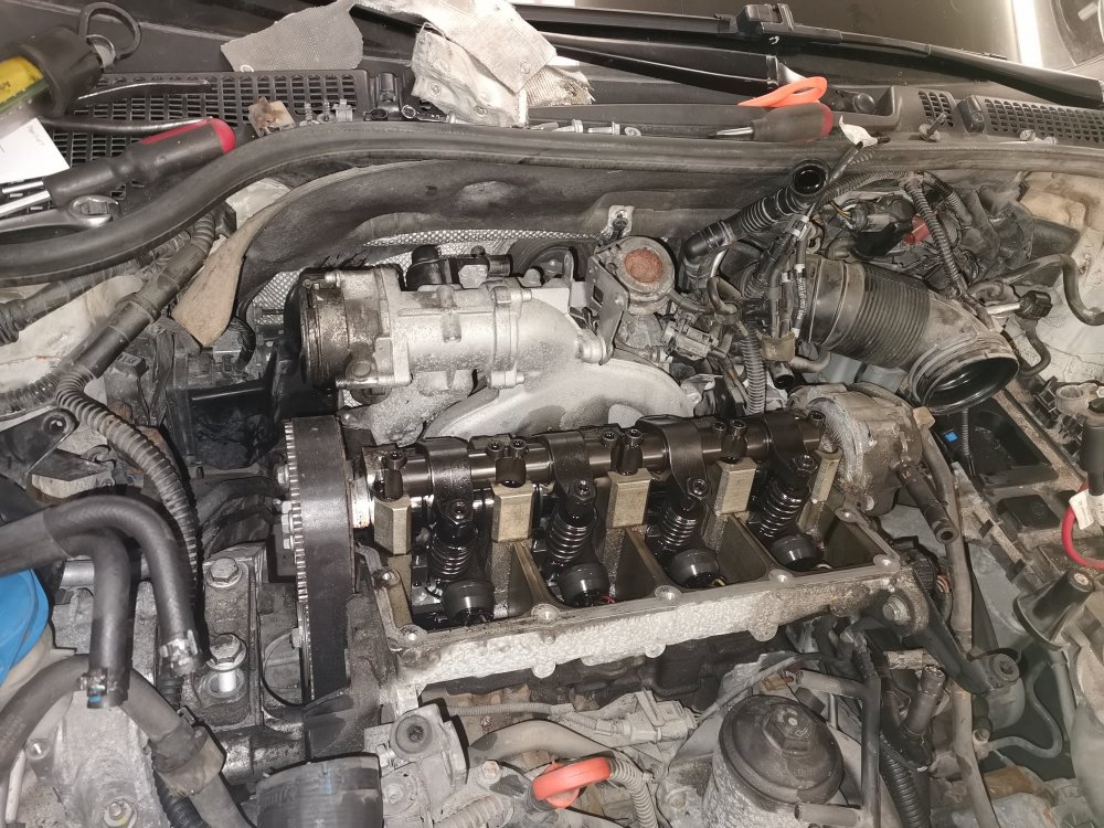

Fixed the stud and didn't change the header gasket (big mistake). So i've taken everything apart once again and it seems i'm going to have
to remove the cylinder head to change the header gasket?.
My question is if there's any guide on how to get the timings right (for the cam/valves if the engine is in TDC).
This is where i'm at atm:
You shouldn't have to pull the head but you may have to remove the inlet manifold in order to get to the exhaust/turbo manifold.
I would have thought just replacing the missing stud would do for that. If still leaking there try a smear of exhaust putty over the moon and let carbon fill the inside.
I actually drilled the hole do deep for the exhaust header so this is why i pulled the head( to embarrased to tell earlier) 😋
