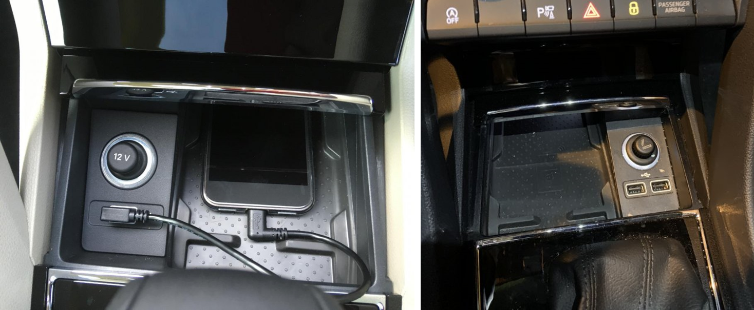

As I understand it the Kodiaq comes with a double USB charging point in the phone box if the vehicle is destined for mainland Europe but vehicles destined for the UK only have one. Does anyone have any experience of swapping the single over to a double or ideas where one might get one? It's can't be that hard to do!

This has been discussed before, but no one has attempted to retrofit the twin-USB insert into a single-USB UK-sourced Kodiaq.
The main issue for me would be that they're on opposite sides of the compartment, in the UK it is on the left, mainland Europe on the right.
Could this mean that the fitment might be slightly different? If you look at the lower left corner of the panel that the UK USB is mounted into, it has a slight radius / curve to it...
Left-side = UK - Single USB / Right-side = Mainland Europe - Twin USB

I trawled through service manuals and parts catalogues to try and achieve this, but gave up before purchasing anything. The curve in the panel was one problem that I couldn't work around without replacing all sorts of parts.
In the end I just purchased a twin USB port to sit flush in the 12V adapter. This one.
Mike
Yes.... having looked at both photos it would appear that may fail the 'is it really worth all the faff?' test. Ho hum, might have to go for the plug in adapter.
