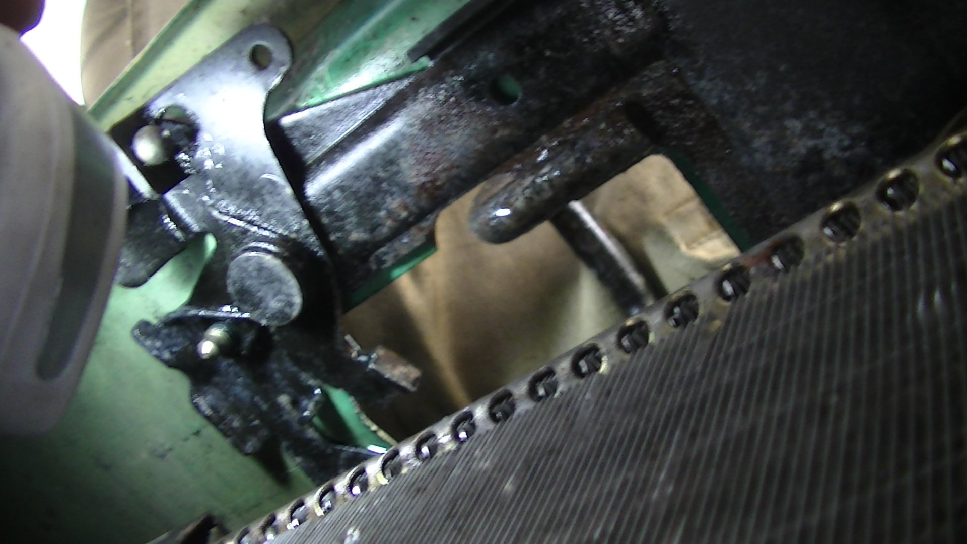

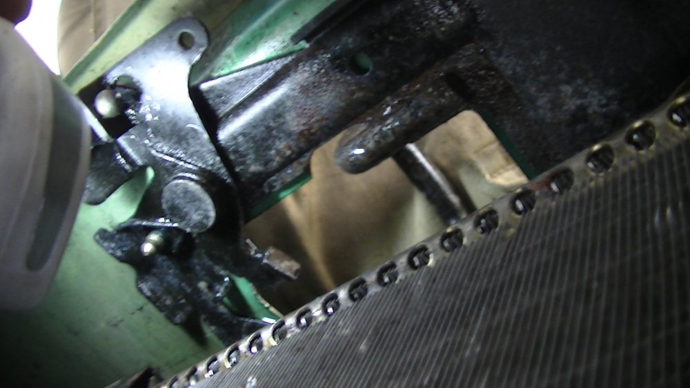

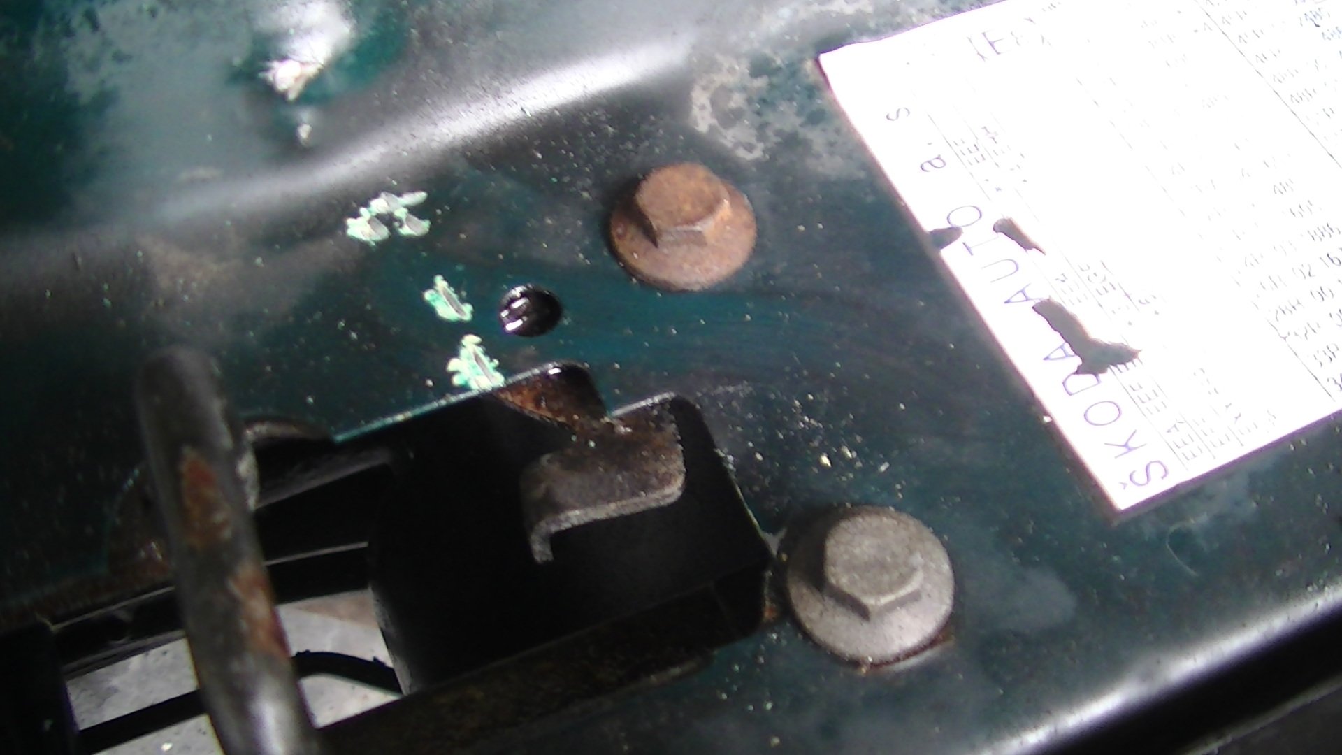

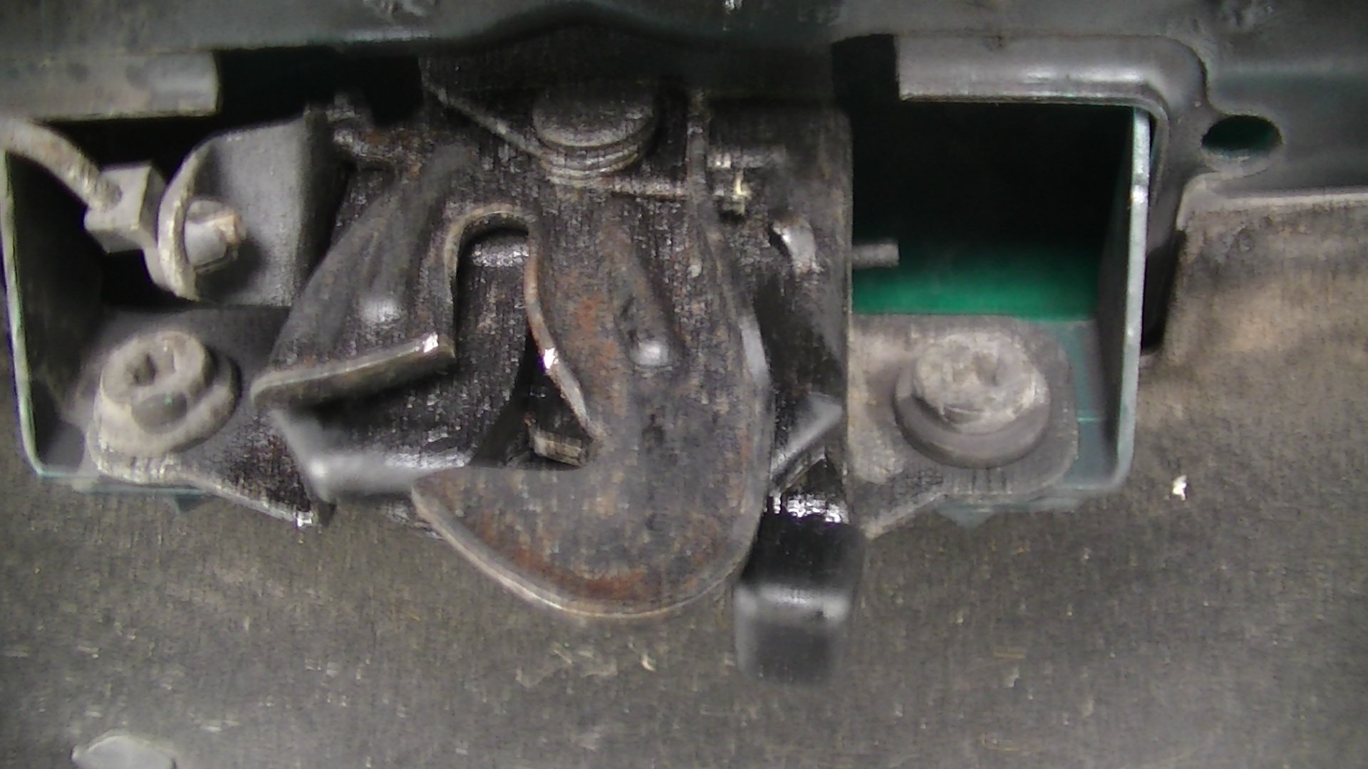

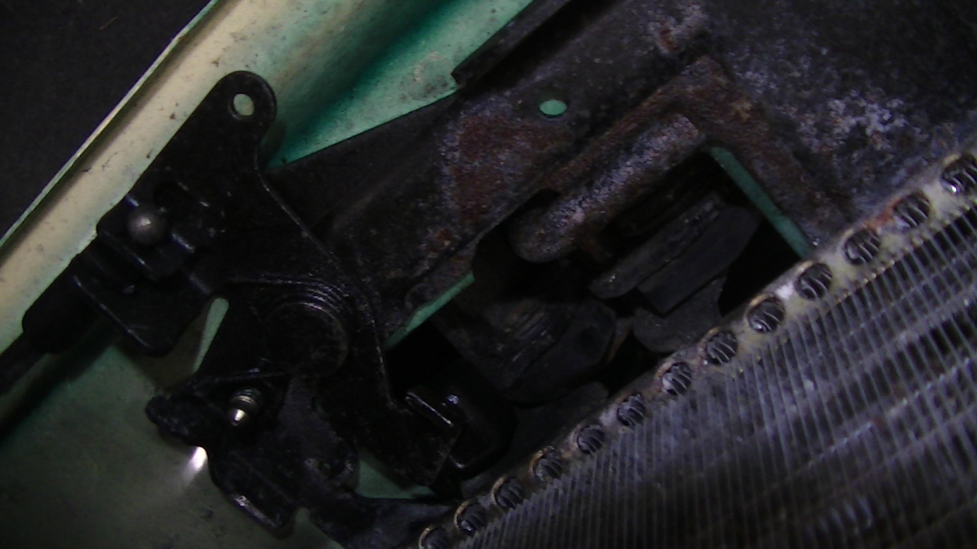

for now fixed the problem off the bonnet, at least i got it opened
hereby some pictures for the convenience off others
so, the lip in pic 0117 was over the cubic black nob on the right in 0118
i pushed very hard the black nob away with a long concrete steel bar
