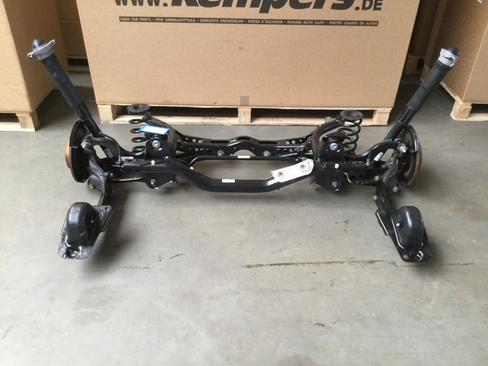

First step, I found this for aprox. 700 euros in Germany:ghukiyk.thumb.jpg.989a7558d431fde28b2e1d58aa8e7293.jpg
