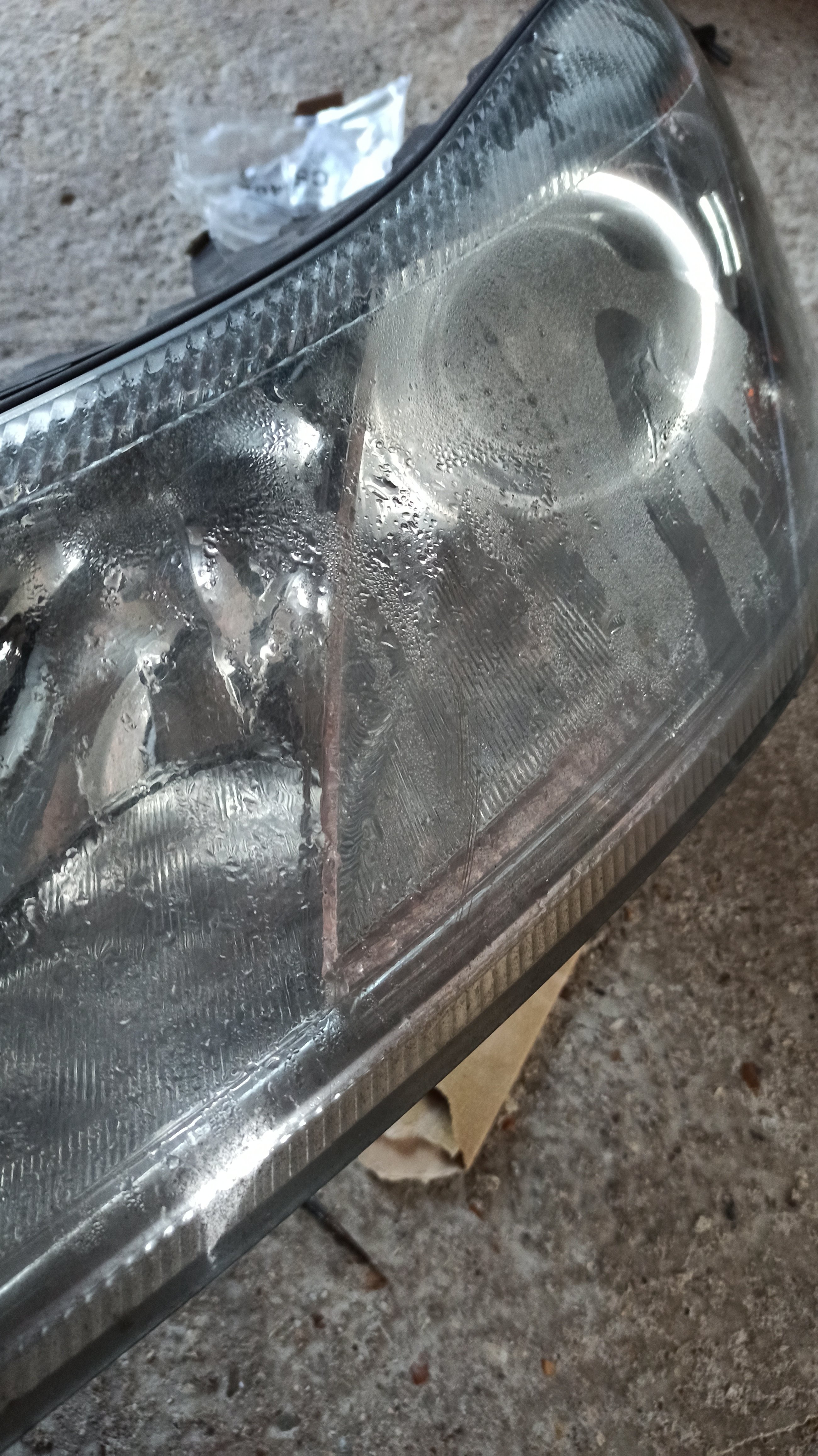

After all this torrential rain we've had I've had some moisture in one of my headlights. I've managed to dry most of it out by removing the headlight unit and keeping it in a warm room for a few hours. However, now I can see water marks on the inside.
Does anyone know if there's a way of getting inside to clean it or is it a completely sealed unit (which I'd expect)?

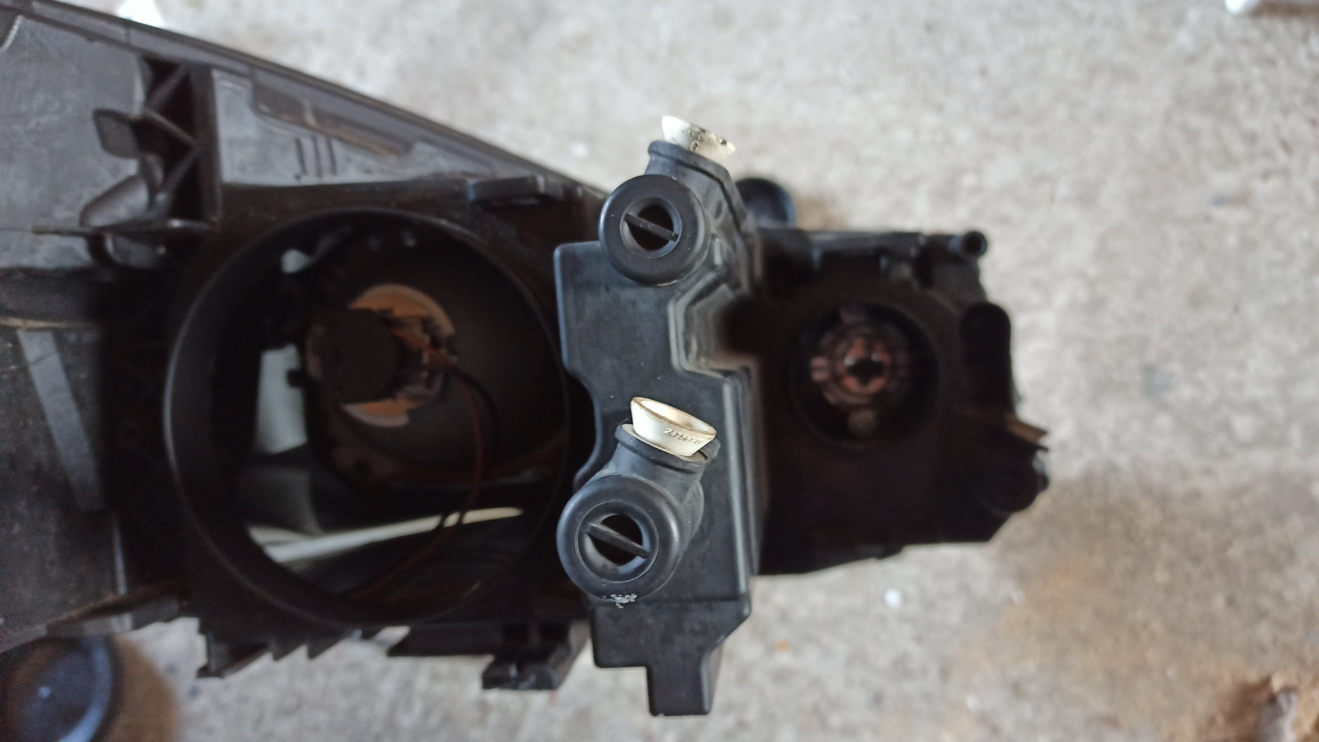

Can't see a way through past the bulbs to wipe up though.

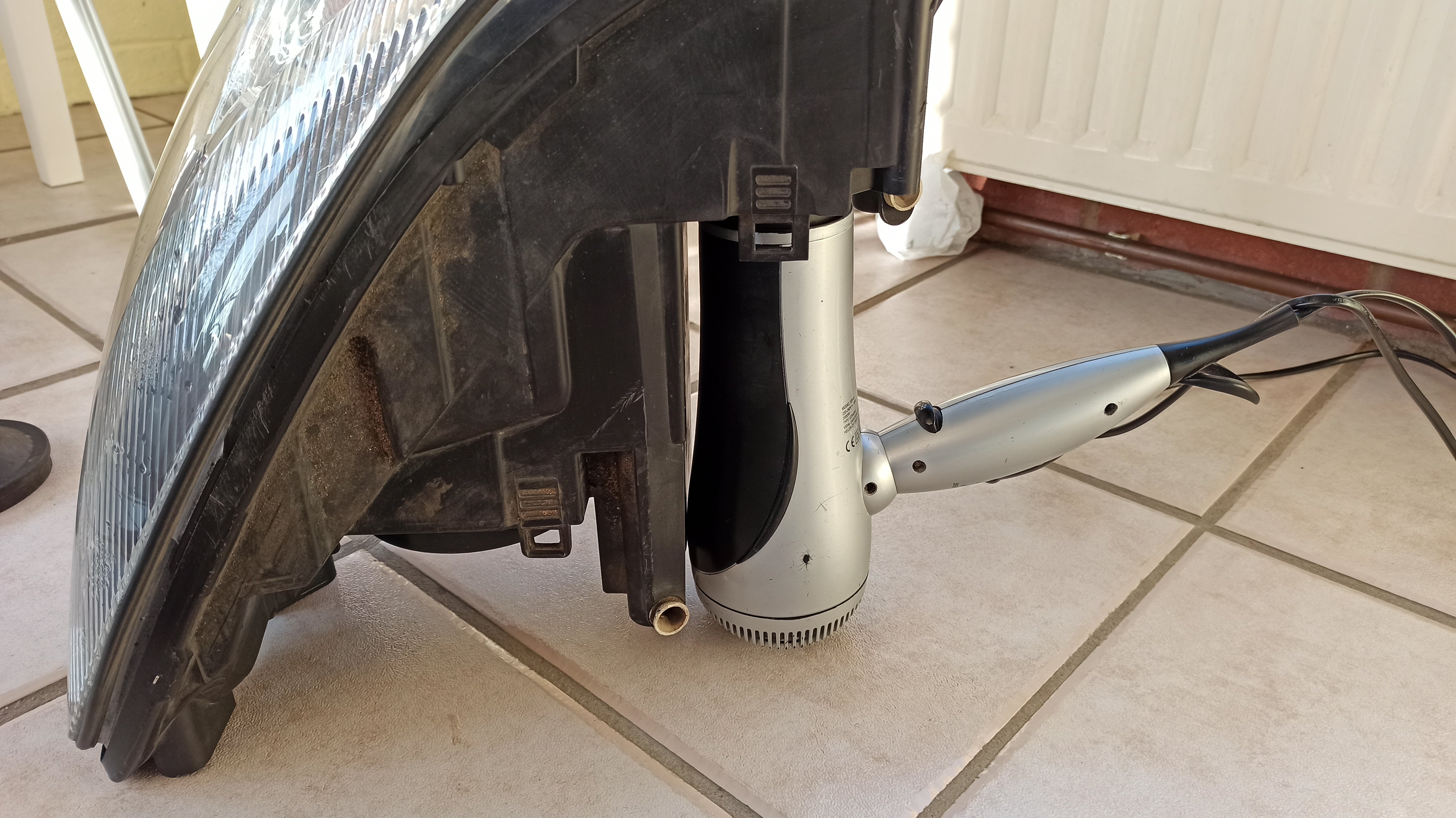

Going to try a hair dryer.....

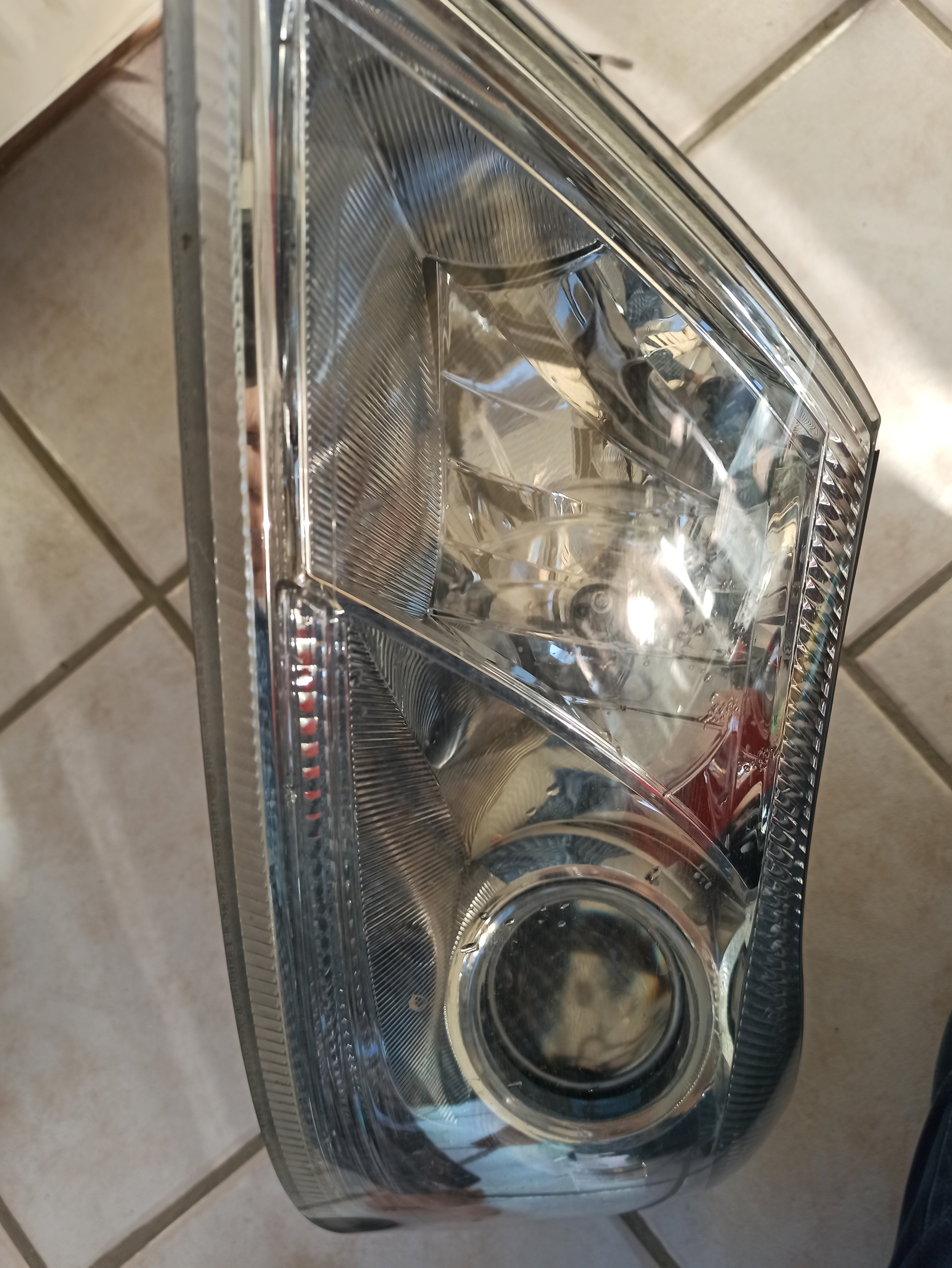

Hair drying in progress :)  Appears to be clearing up.
On lowest heat setting, so isn't heating at all really, just getting some air flow through small hole and then flows out the bigger hole.

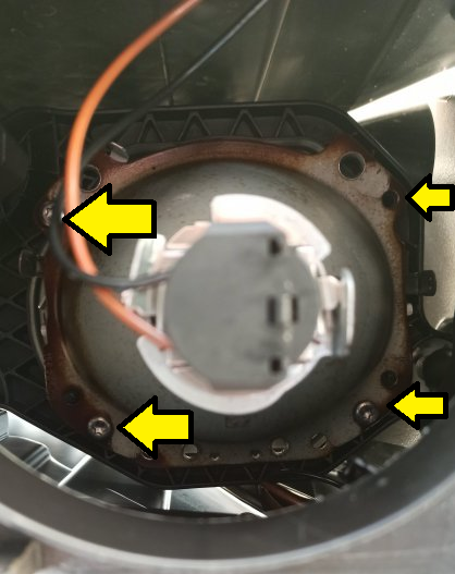

To clear the water streaks (mine are not too bad), I'd probably remove the following 4 bolts and then you should have access to the plastic inside:

When this happened to me on my old car I simply removed the high beam bulb (as it's in a reflector lens so leaves a hole into the main housing once it's out), and blew warm air from a heat gun on lowest setting for about 5 minutes. Completely dried it out.
