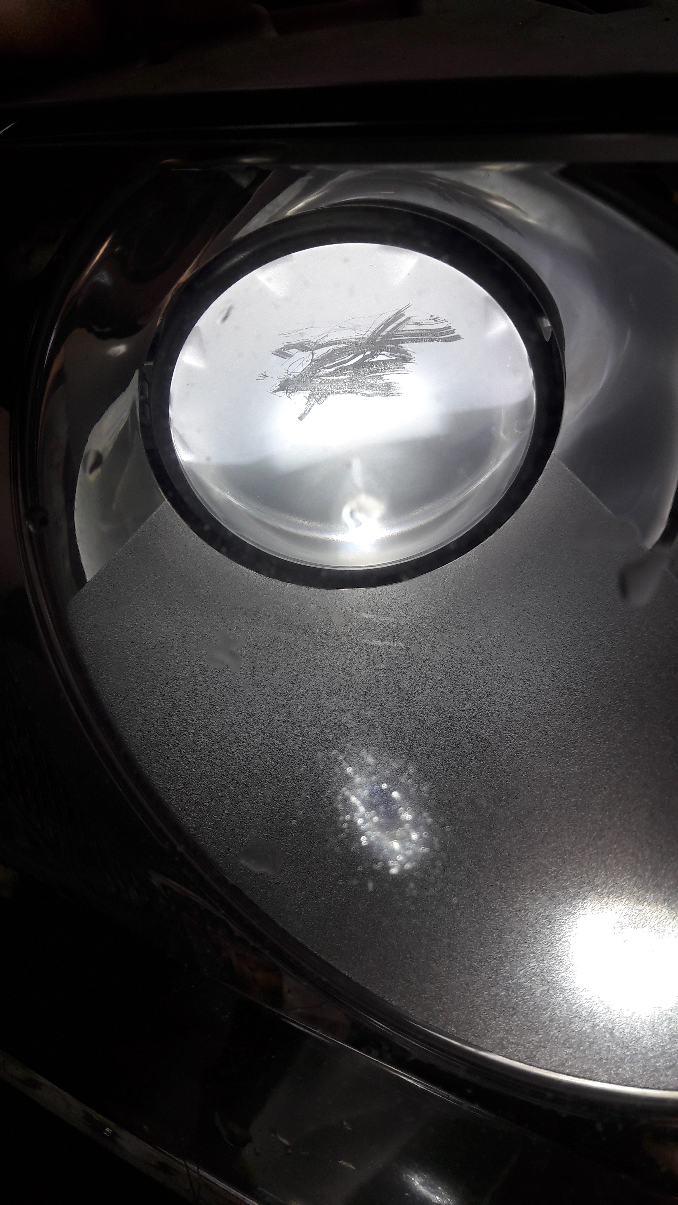

was going to mention cleaning inside the lens / eye, but as one of yours is new it will not be as bad as mine were
This is with a torch shone through it after showing how mucky it was prior to cleaning.

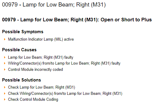

Headlight looks like 11.7 volts. Can this be increased??
Any other thoughts??

On 25/01/2020 at 17:36, FatblokeVRS said:
00979 - Lamp for Low Beam; Right (M31)
010 - Open or Short to Plus - Intermittent
