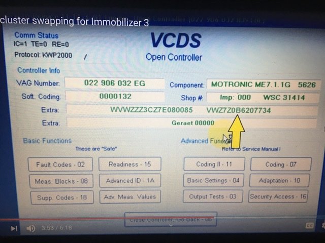

I think you mean the control number for the immo, but I’d like to know the immo ID. Please take a look at the attached photo, borrowed from a RossTech video.
