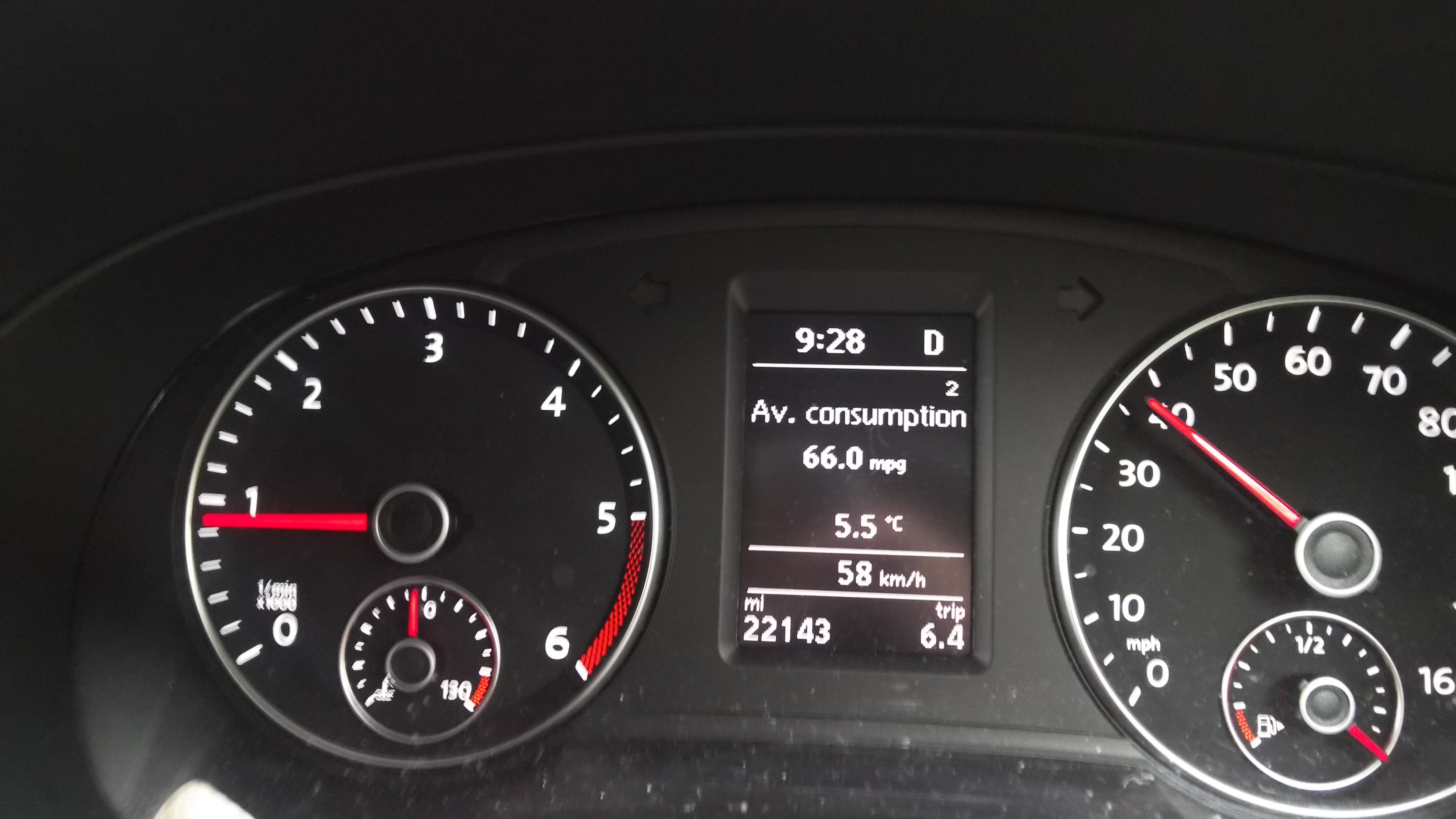

Hi folks - thanks for the replies so far....
I understand the display controls and how to reset......
My problem is..... I want to see the cumulative memory for my fuel consumption   BUT the car resets it every time I start the car.
@Dandazzle
Is it resetting setting 2 every time?
DSCN2349.JPG.e71cc2e8522beae0d2baea6e1a195f4f.JPG.f935b4b0e6e00084fa94cd5455a8f35a.jpeg
