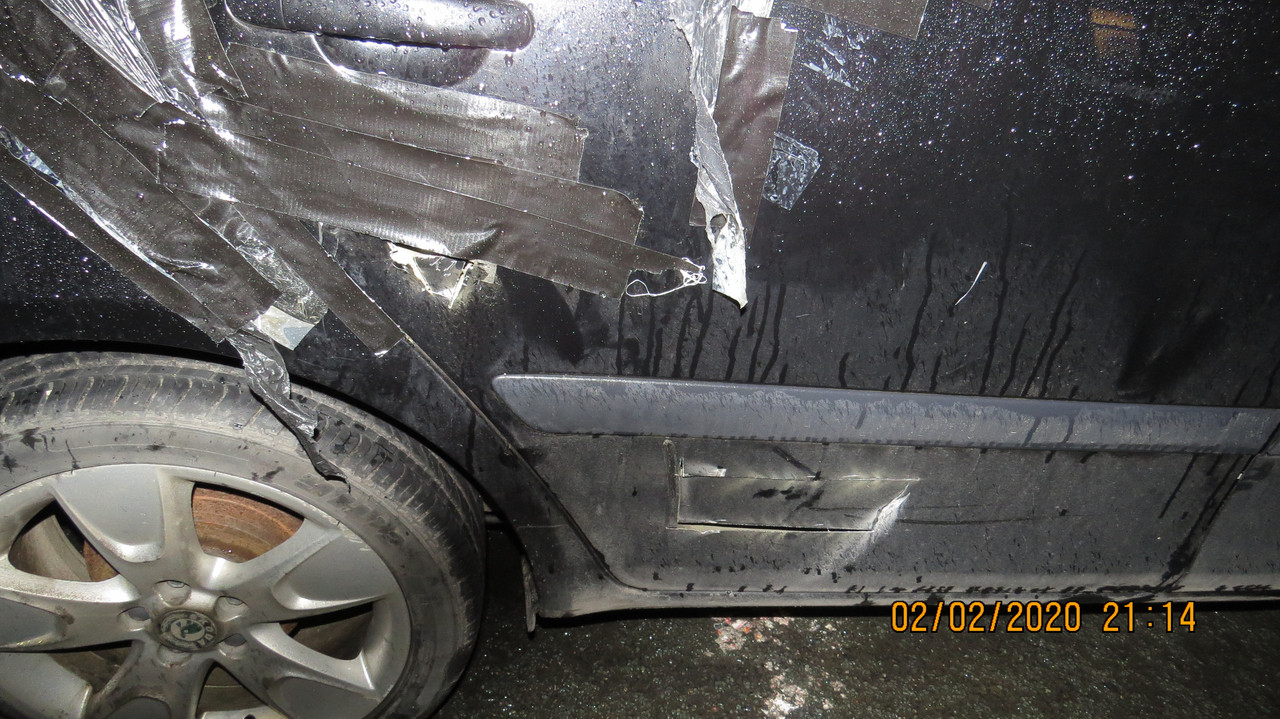

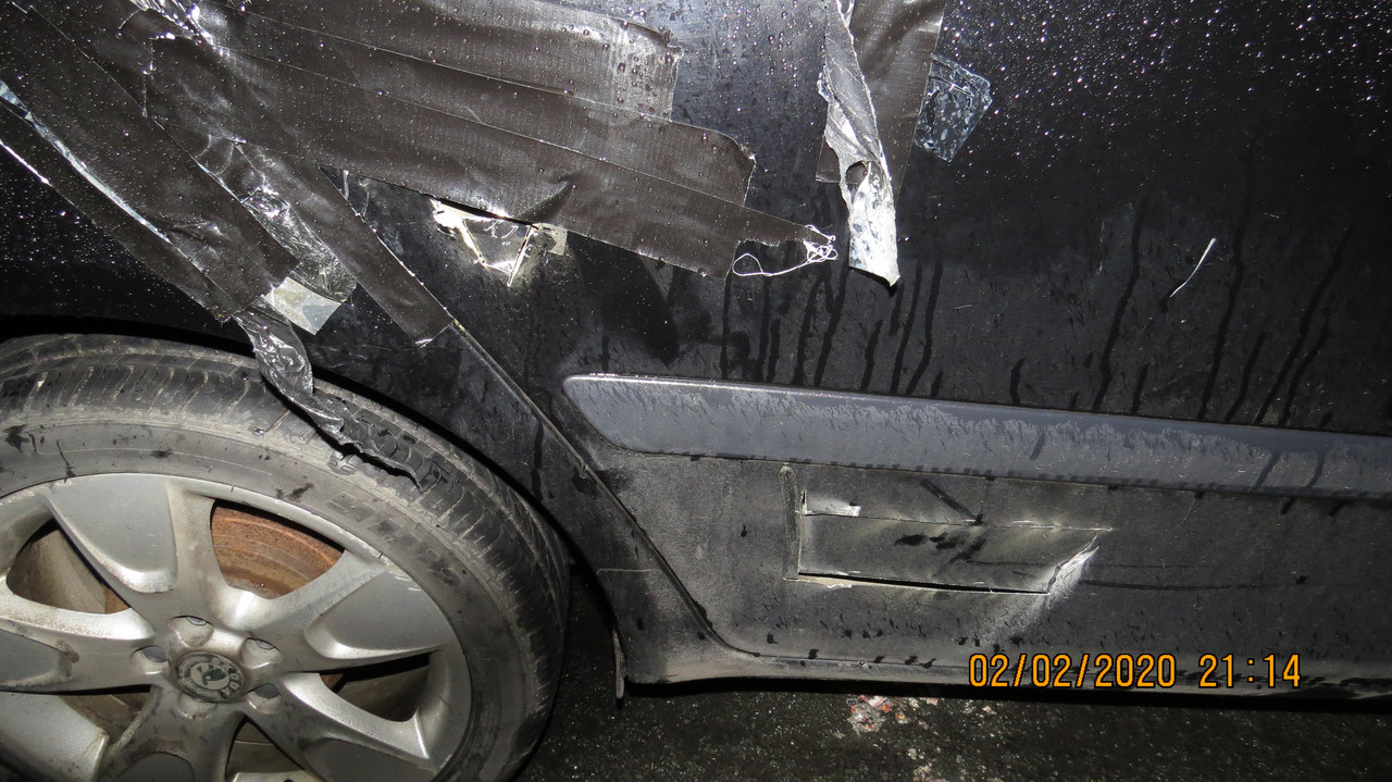

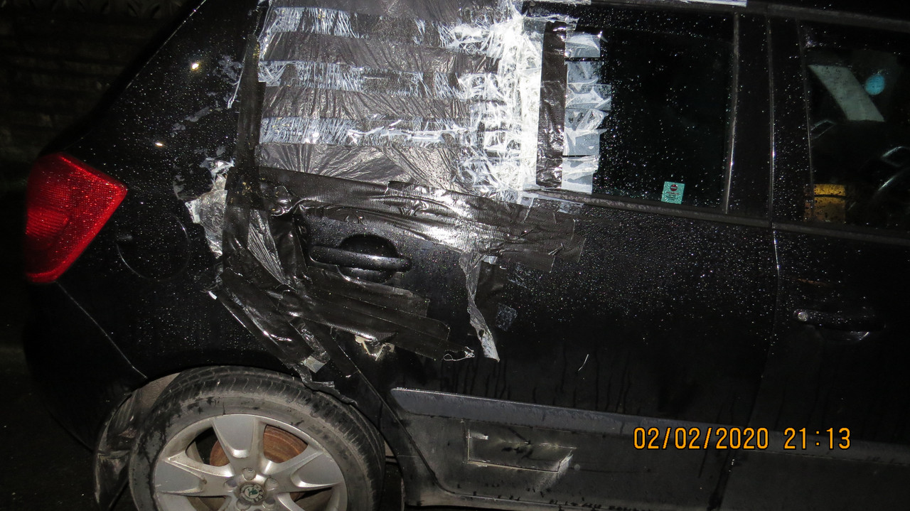

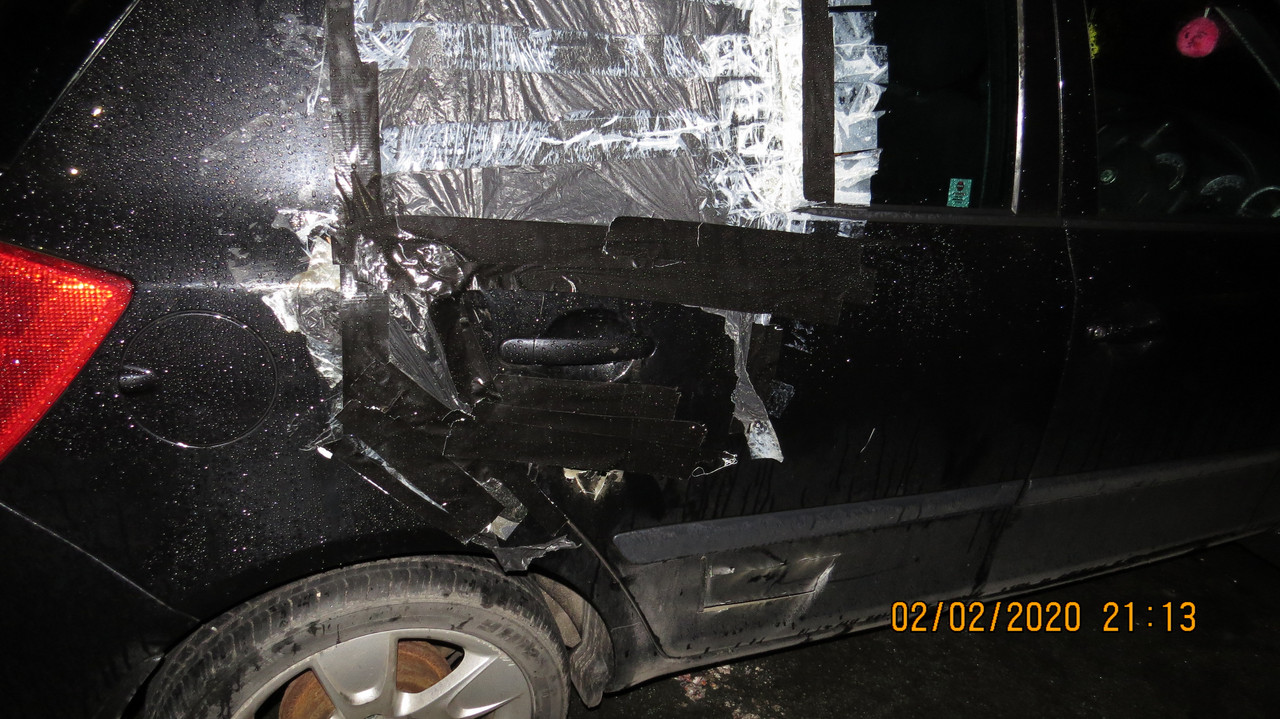

ok guys bit of an update:
the door is locked permanently, i had check inside the door and the locking mechanism will not open the door at all.
question is, how do i force the locking mechanism out from the door so i can open the door? i was thinking about a crowbar, i have already got another locking mechanism so i dont mind if this breaks, i will be putting the new lock into my new door.
i got a circular saw to it
can anyone help me try get the central unit out please? another thing i forgot to say was after the crash, there was a pin that was there but it came out but when i tried to put the pin back in, it wouldnt go back in so im guessing its broke.

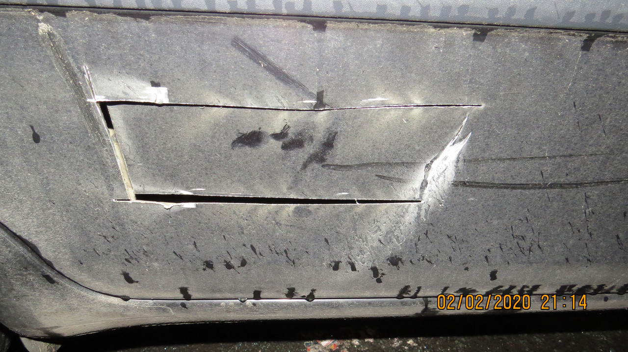

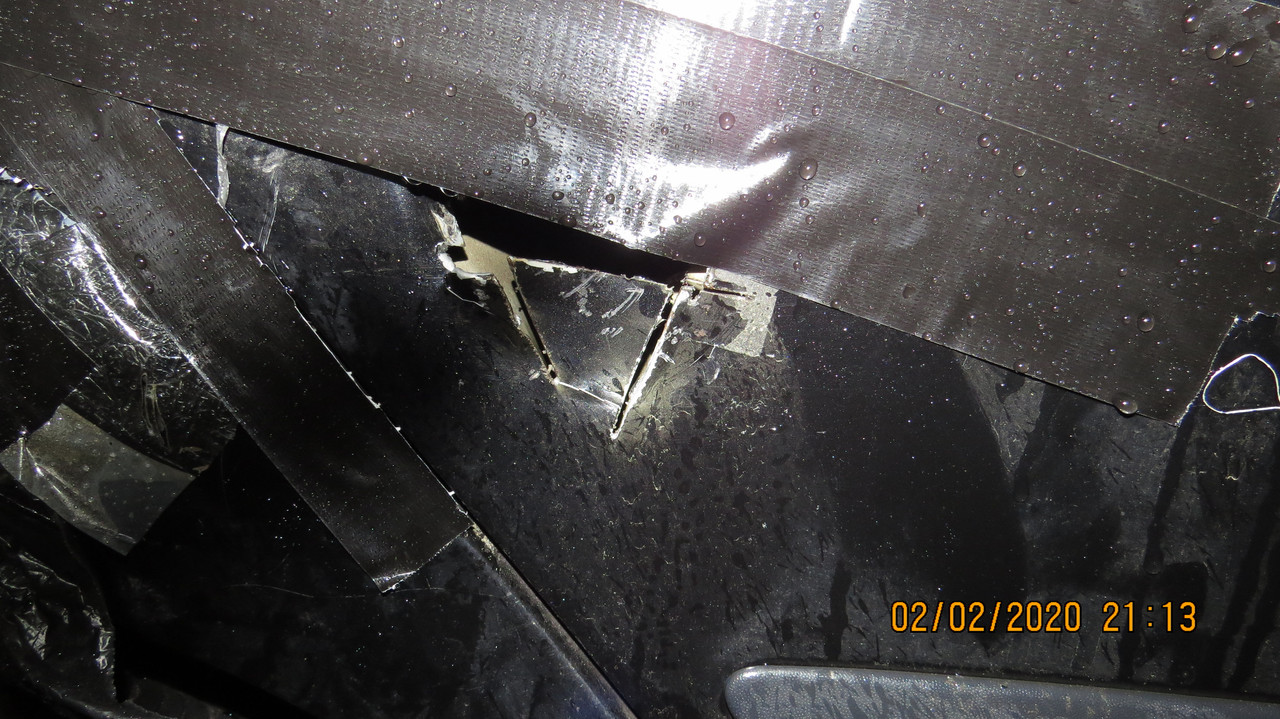

If the door is trashed, why not cut it right open from the outside, you can then attack the lock assy  ?
i have already thought of that but i cant just force it out can i? i will be ordering the locking mechanism when i know if i can take it out without damaging any other components as i still need to swap everything over to my new door.
If yours is a Mk2 hatch then yes.
does anyone know how i could somehow take the locking mechanism out please? bare in mind i cannot open the door to take the door card off. if i could take the door card off then maybe i could get to the screws that is holding the locking mechanism.
did you cut an access hole in the outside ?
If so, should not take much to break the lock apart to release the door,
