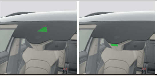

Most of the unlockable features come with the more advanced 'highline' windscreen mounted camera.
Here are the locations of the 'lowline' and 'highline' cameras...
You can also see the light sensor for the activation of the headlights, it is the black spot on the back of the rear view mirror.
You can also see the rain sensor for the automatic wipers, it is the grey circular sensor on the windscreen underneath the 'highline' camera.
If you have Lane Assist you can have Traffic Sign Recognition enabled easily enough...
