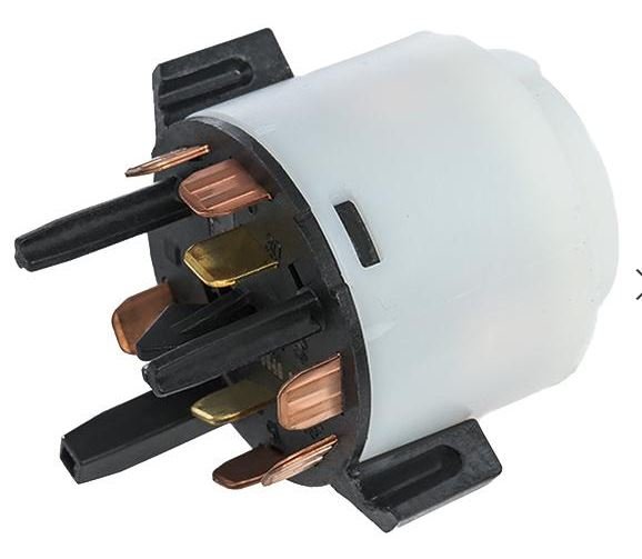

Got a tip from a skoda mechanic, replaced the bottom piece of the key ignition. Been working fine the last 5 days. Picture attached
