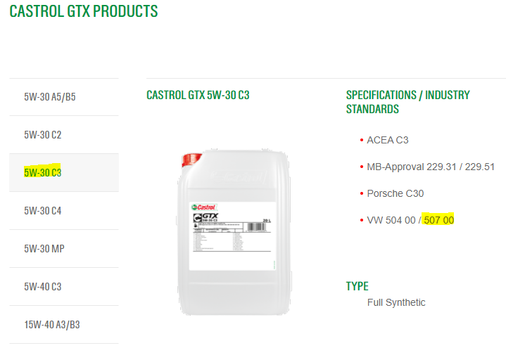

Your MkII Superb Greenline has a Diesel Particulate Filter (DPF), so you need oil that meets the Volkswagen (VAG) spec VW 507.00 (low ash).
The approved Skoda oil from Castrol is Edge 5W30...
However, there is a Castrol GTX that meets the VW 507.00 specifications...
5W30 C3
