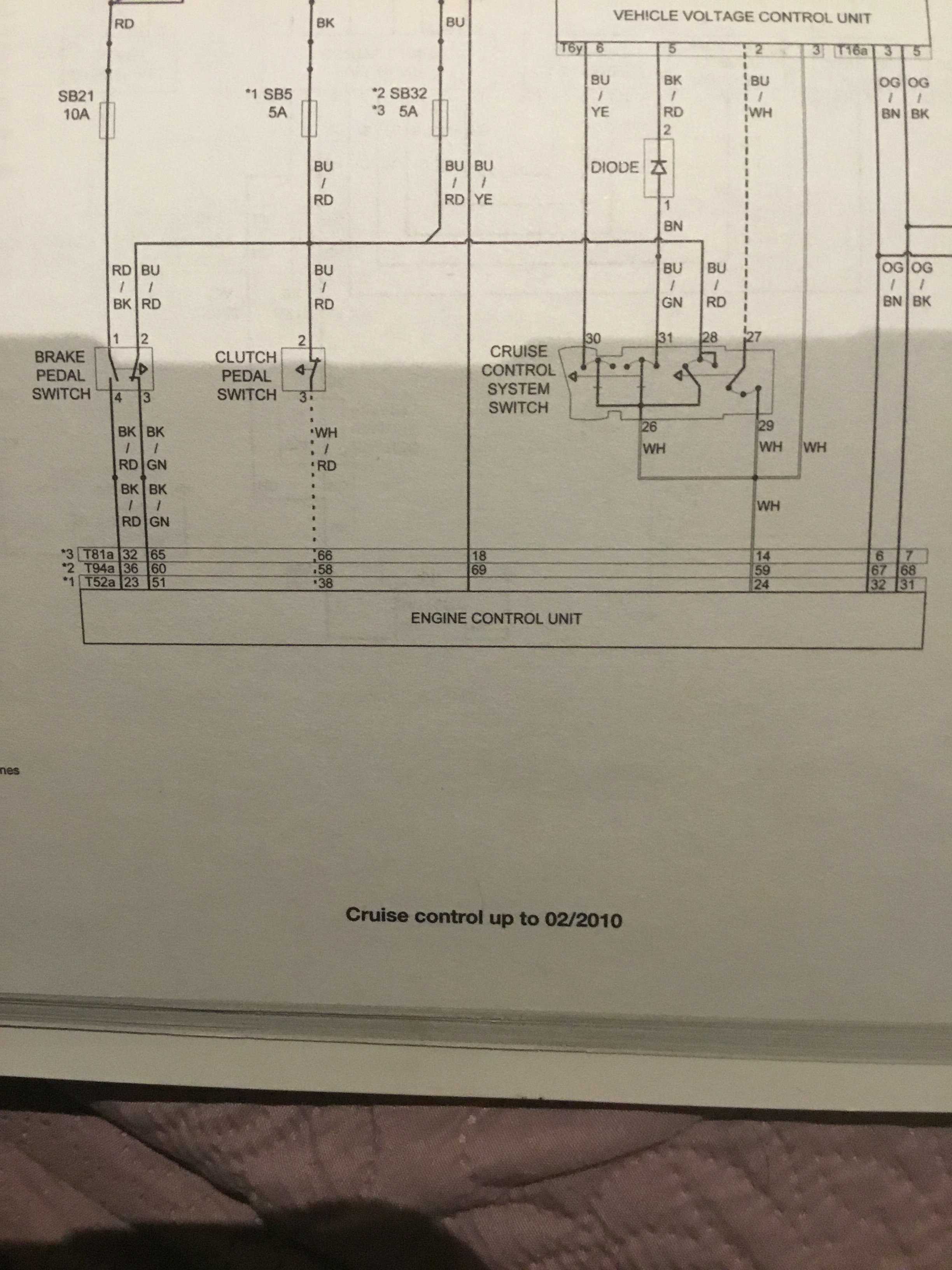

Wiring diagrams for tdi show that the white wire to ecu should be connected at pin 14,
But once i looked at the ecu t81a connector, pin 14 is taken by another wire.
I tried to bridge the white wire to the one connected at pin 14, but then engine light came on and gave some trouble codes about charge air pressure sensors.
The stalk works, it was checked by vcds on measuring blocks.
I just have no idea where i should connect the white wire...
Depending on engine code it could be pin59 or pin 24 according to my manual. This is fog cars up to 02/2010.
Pin 24 is taken .
I know pin24 ia for pertol.
Ill give a try to pin 59 it should be free as i remember
21 minutes ago, Constantine0901 said:
Pin 24 is taken .
Pin 59 is listed an engine code BLS Diesel and pin 24 is indeed petrol.
Edited by Wonky
On 04/02/2020 at 22:00, Wonky said:
My engine is bsw and the pin is 14.
I found it finally. I was looming wrong on the t81a connector
Glad you’re sorted.
