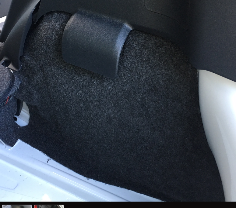

Hi I've not been on here for a while as I've got a new toy (1963 series 2A Land Rover) but I've driven Tasha's citigo in to work today and ive noticed when i went in the boot where there are just plain metal panels either side they have condensation on them, which i understand as its extremely cold today and the front of the car has been in the sun but the rear is up against our warehouse are there any panels available to fit so as to insulate them, ive googled it but cannot see anything any help would be great please, ps the car has been great no problems with it the mileage is now just shy 78K Cheers Paul Tash n Barney

I made some paper templates for each side.Then bought a piece of carpet remnant from the local shop,and cut them out.
Stuck them on with double sided tape I had. Boot is dry and quieter. Cost me £3.00 in total ,but I'm a cheapskate.....

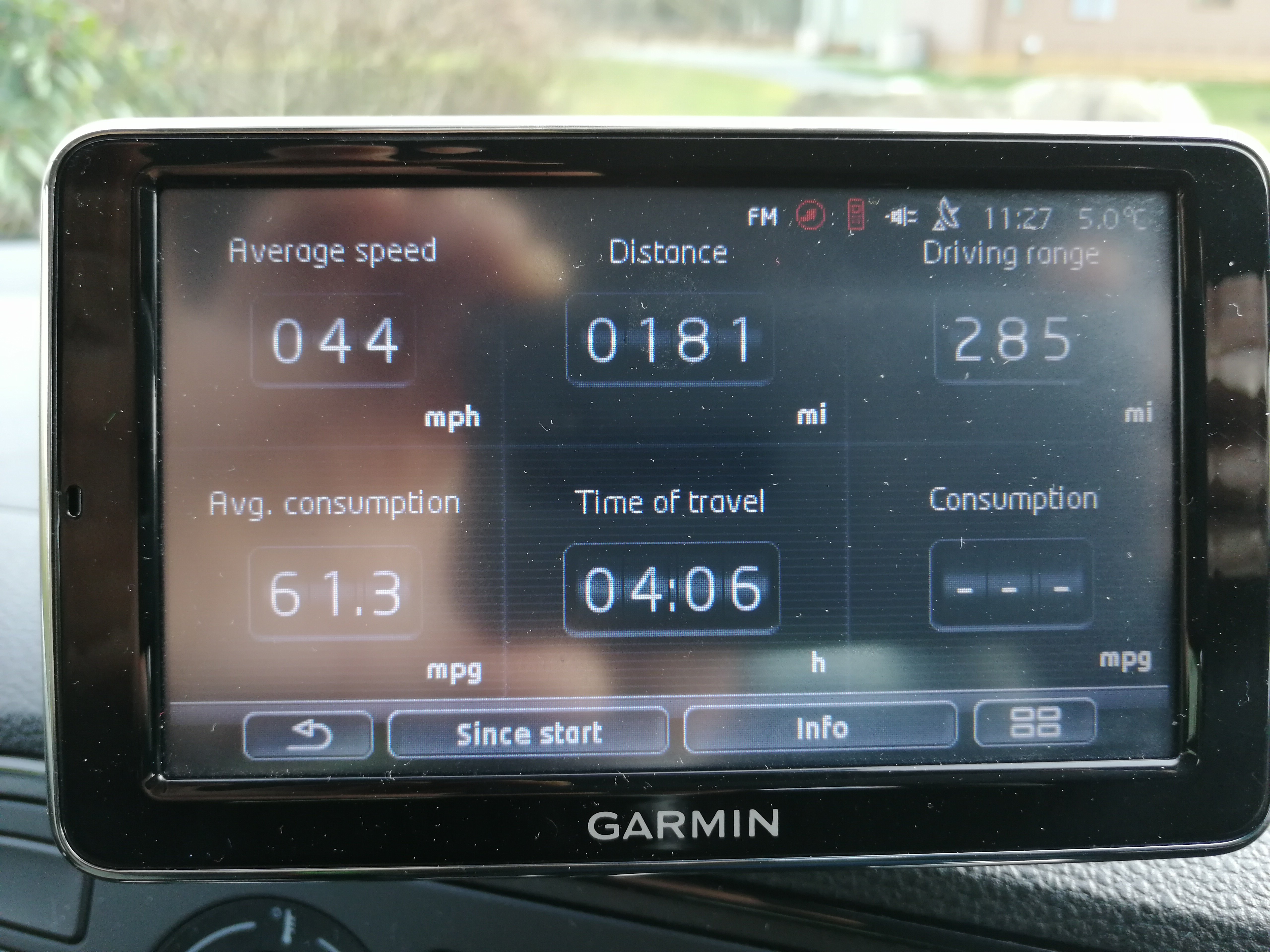

Hi thanks for the replies we've driven to snowdonia today in it for aong weekend it's the furthest I've driven it and was very impressed with it, we've just walked back from the pub and will have a look at that website 👍 here are the journey details very pleased with mpg 👍
