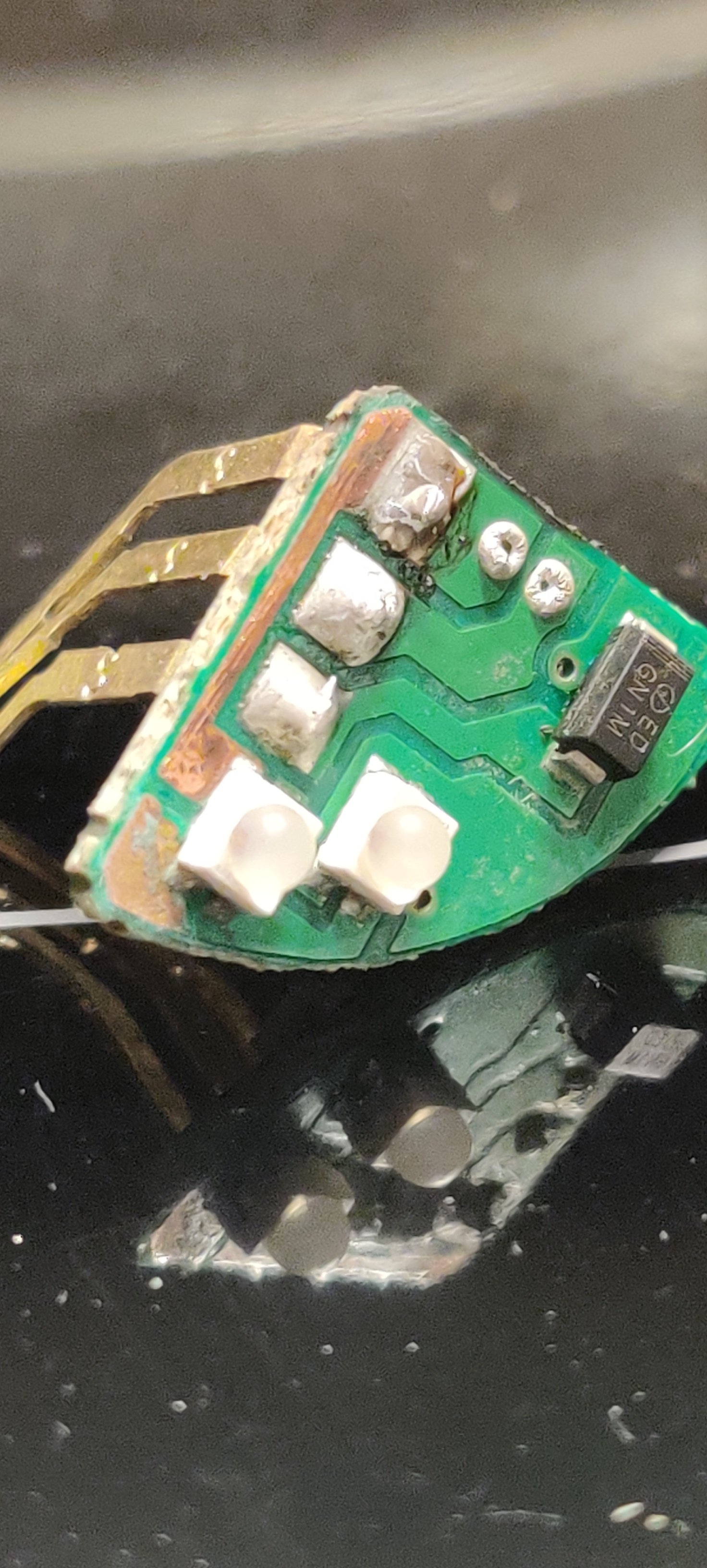

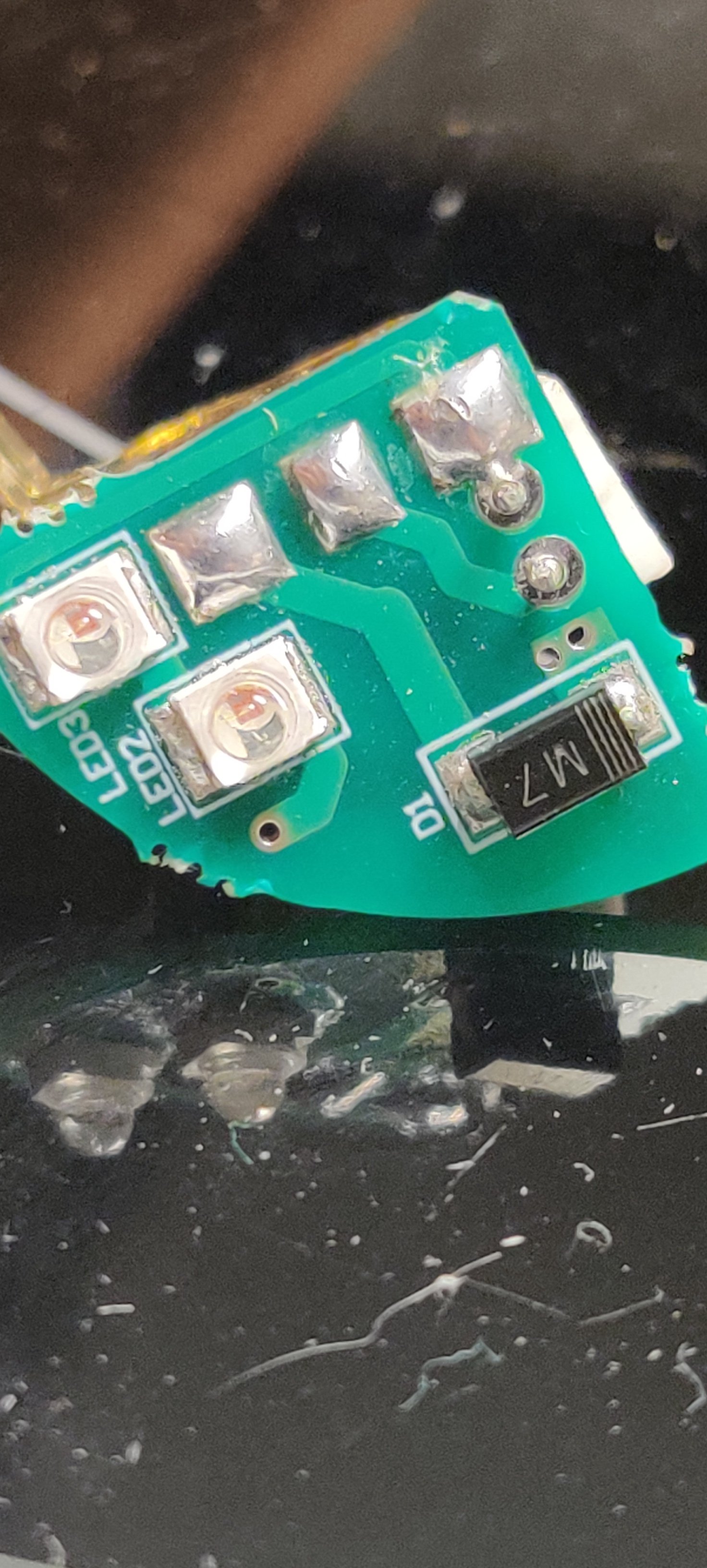

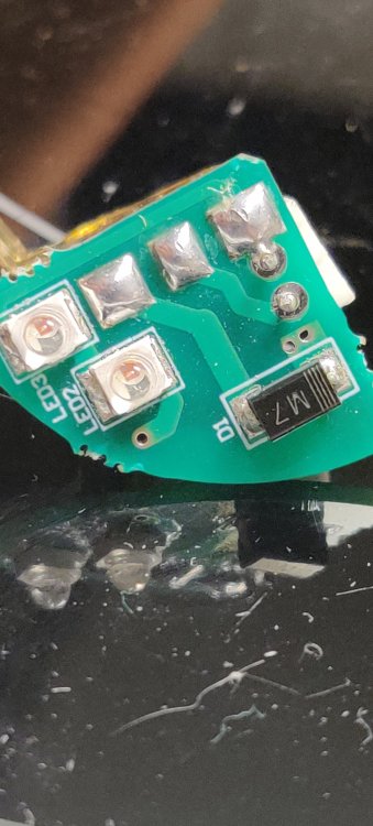

I have now sucessfully repaired the side indicators. I bought a new unit but it didn't have any puddle lights. So I butchered my new and old one, only to find that the power connector to the puddle light was nowhere to be found. So I desoldered it from the old one and soldered it to the new board. Works like a charm!
There was alot of oxidizing on the old board. I could only get one of the LEDs to shine very poorly.
