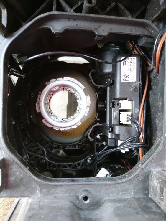

I live in UK, got a RHD car, but travel to countries that drive on the right (correct😋) side of the road often and am trying to figure out how to convert my xenon beams, as I'd rather know how to in advance than stand on a rainy dockside trying to figure this out!
I did lots of searching but am still clueless?
My car does not have the maxidot and no sat-nav, so I presumed the "it'll just do that automatically when it senses you're across the channel" option was not applicable to my vehicle?
So I took the headlight out to search for the magic beam-go-flat lever, but I can't see it?
I don't like the stickers, they don't work well imho.
I've (hopefully) attached a picture of my headlight
Cheers, Daniel
You need to use VCDS or similar to enable travel mode. A dealer can do it but may charge you 😕
The stickers aren't suitable as the AFS system moves the headlights around so although they'll be correct when you've fitted them, they won't be when driving.

With the factory fitted xenons comes a mandatory automatic leveling system, which means no amount of Cake in the front or bananas in the boot will change the angle of the light in relation to the road. There is no manual adjustment, no thumb wheel.
