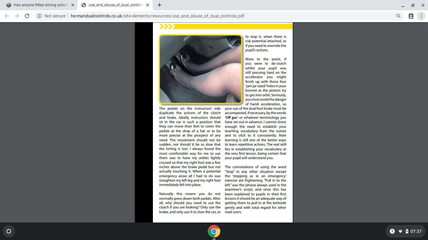

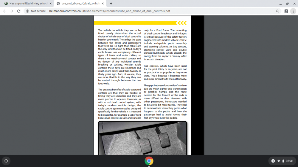

@Alex-W
It is indeed very relaxed in the UK for MOT's and Road Policing.
  The driver is responsible to be driving a safe car though. It said all about that when MOT certificates were issued. Bottom of the reverse side of the certificate.
Here the OP is talking about a radical modification where from the passengers seat they can take control and brake the car and not by using the Parking / Emergency brake that is standard on the car.
As to upgrading and modifying your brake system from standard or suspension then your insurer is interested and if you do not do the work competently like some muppets then there can be consequences.  Like for the guy that lifted his Land Rover badly and killed his children in the road accident.
If you  fit Dual Controls to your car for some one in a passenger seat you need to inform your Insurance Company and they might well want an Engineers inspection and report.
The UK MOT is relaxed as your backside needs to be or have soap on a rope if it all goes t!ts up.
In the UK you can hire a car with Dual Controls from around £9-£11 an hour.
http://blog.passmefast.co.uk/driving-instructors/dual-control-cars
http://he-mandualcontrols.co.uk/site-elements/resources/use_and_abuse_of_dual_controls.pdf
