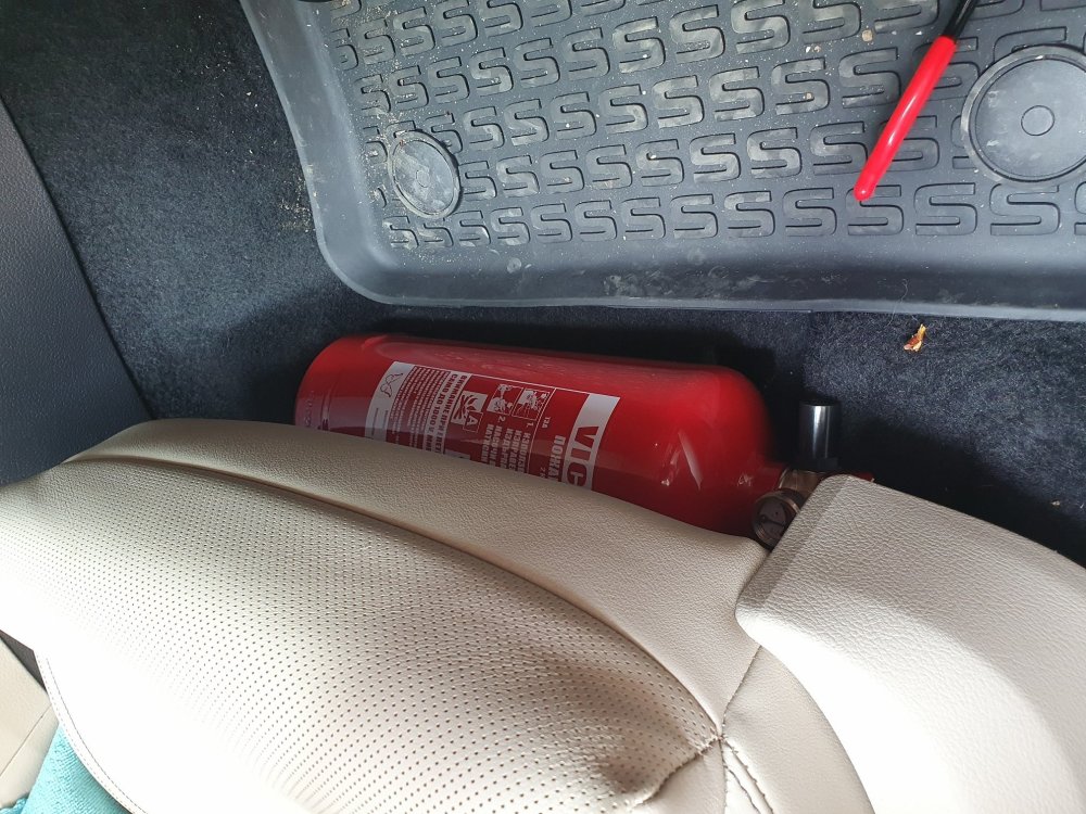

Check out this post from @leolito who mounted one under the passenger seat.
Unfortunately, my installation was with the OE/accessory 1kg bottle, whereas what fr1nklyn is mentioning is a new "particular" requirement from neighbour country Hellas, which I believe is the only nation in EU and Europe to require a 2kg fire extinguisher.
Now this is a hefty piece of metal, and not only you are required to have it, but it must be made "accessible" - this means not thrown randomly in the bottom of the luggage place 😁
I got myself yesterday a 2kg one as per requirements, and will try to see if it fits in the place where I set the OE one as shown, but I doubt it fits.

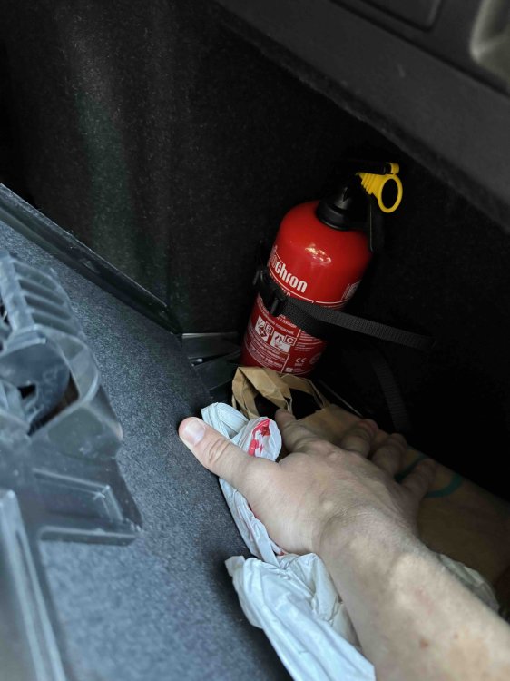

Thanks @leolito ! I was thinking about the boot "pockets" since on the estate there is plenty of room there.
Tricky ... on the left side Ihave the Canton sub, so not much space, except for gloves, folded shopping bags, and a rain-windbreaker.
On the right side the 1st aid kit, a bottle of water and one sprayer with 50/50 solution water/degreaser to clean the windshield from dirt and dead fauna when I travel ... I am always an attraction whenever I stop and pull out all this crap and clean the screen 😄
I will try to fit the FE there and see how it goes, but remember the rules state "it must be quickly accessible" so depending on how picky is the patrol stopping you, might be a tough sale to show that immediately you will react to get out of the car, open the electric boot - that might want not to work in that moment 🙃- and get to the pocket that must be free from the ton of luggage you are carrying 🤪

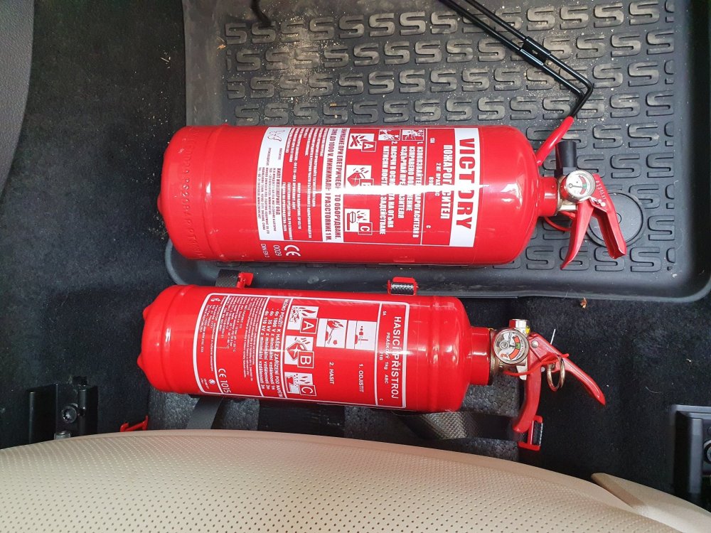

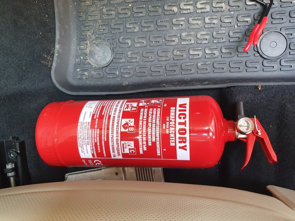

Nevertheless, I did try to compare the space and the two FEs, 1kg and 2kg:

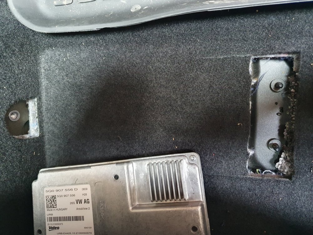

The 2kg one doe not fit at all, unless you remove the foam support for the ECU under the seat - in my car, at least.
Moving the ECU aside, and without the foam, frees access to a threaded rivnut on the left side, and two studs on the right one.
Without all this, the 2kg FE fits right, and does not foul the seat moving forward, even at its minimum height - mine is electric, if manual I do not know where the lever is located, it might bother.
So I am going to play making a contraption using the rivnut and the studs to fix the holder that came with the FE, and if it goes well, that will be my Fire Protection arrangement for any upcoming trip to Hellas ... 😜

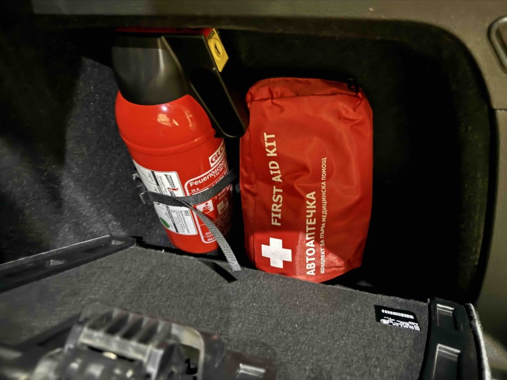

I don't have sub and I have a small belt on the right pocket, holding the current 1kg extinguisher. I've ordered this Gloria 2kg Fire Extinguisher made in Germany(not because it matters these days.. :D ) but with a bit shorter than the standard Tornado and other local brands sold in Bulgaria. I did this with the hope that it will fit and will be held in the right pocket with the built-in belt.
Should arrive some time next week and I'll provide an update. Even if it doesn't fit, I like it more than the local options in Bulgaria.

The 2 kg fire extinguisher arrived and fits just fine in the right side storage compartment in the trunk, held with the factory belt. I can close the compartment and leave my trunk space free 😄
Overall, I'm very happy with the purchase.
Since that FE model Gloria 2 kg P2GM isn't available in every country, for other guys wanting similar fit, look for a model with these dimensions:
Height → 322 mm (you cannot go more than that!)
Width → 111 mm (there is some room for more, but just a little)
Depth → 145 mm (same as above)
Diameter → 110 mm (maybe 115 would be the max)
