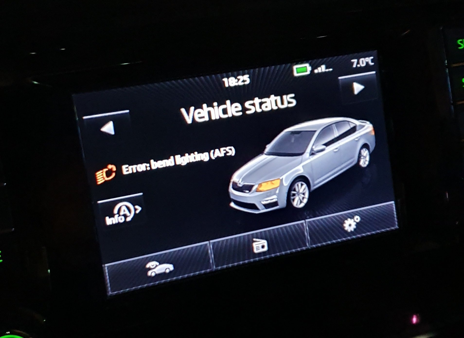

I've just took my car out of the service after a front crash. For one of the headlights i had to replace also the autoleveling unit.
I have an alarm for it and also it seems that when i start the car, the right headlight doesn't autolevel. The guys from the service said that they weren't able to transfer the settings...
What needs to be done ? Can it be reset from VCDS ?

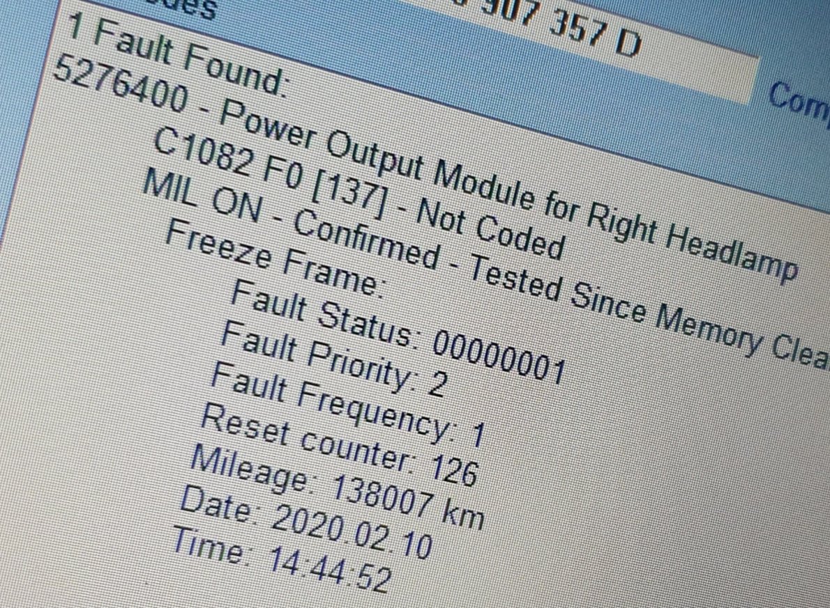

Yes, I will run a vcds check today.
Managed to get vcds. It seems that the control unit is not coded. The issue is that for a strange reason it doesn't show me the security code for module 55 Headlight range.
 Does anyone already tried this ?
