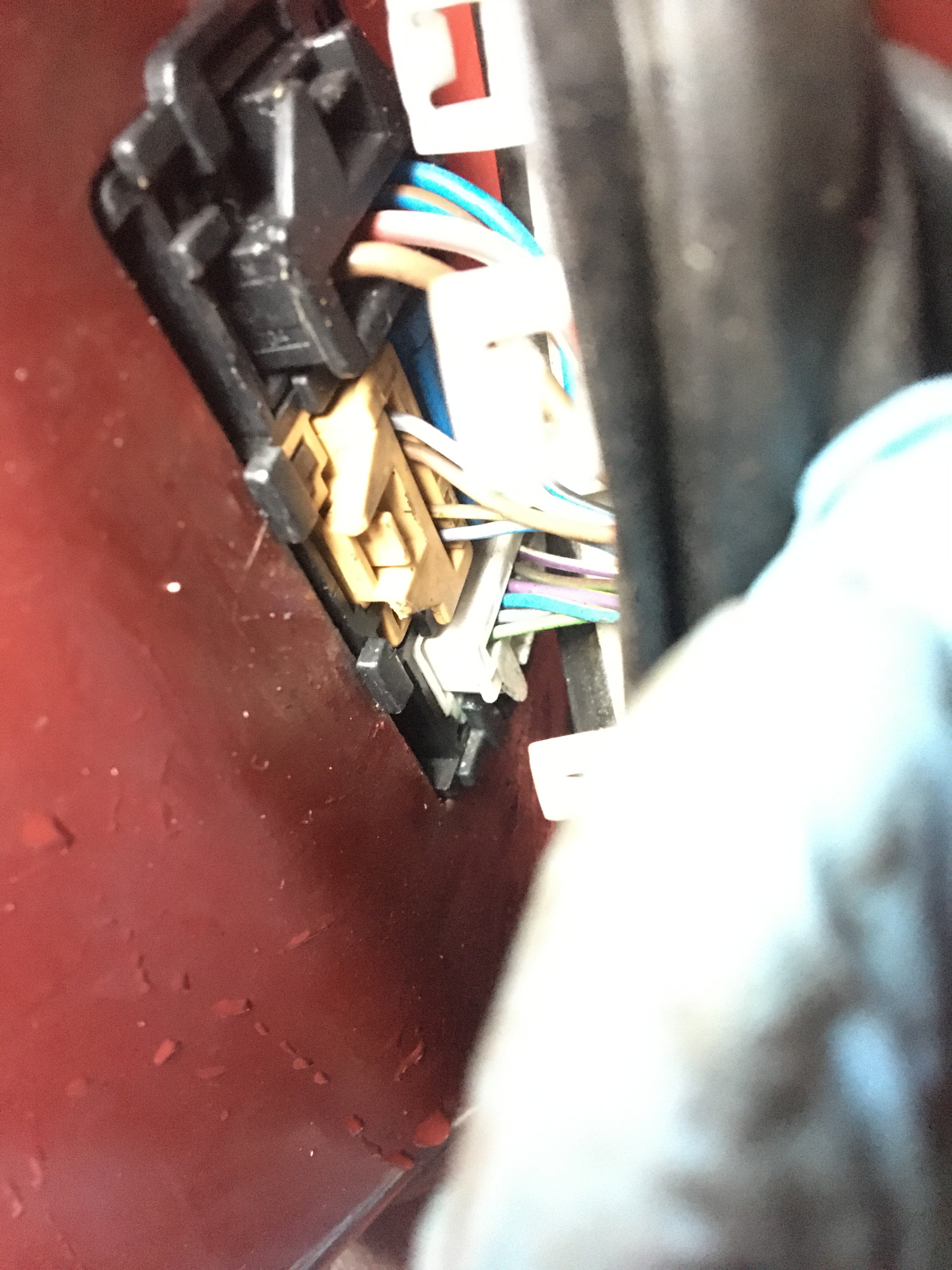

My first thought was the driver's side electrical harness although after a quick visual inspection, it looks okay. I saw pictures of cables with broken isolation online and I hoped to see that here too so the fault would be visible - but not this time.
I would like to gain a bit more understanding of what these wires are before I try to rip the doors apart to test conductivity.
  • What are the four plugs we can see here? There's black, white, blue and a yellow/beige one. I wonder what signals or voltages should be here and when? Anything measureable?
  • Am I right in thinking that the driver side door contains a controller module. What would happen if you unplugged the driver side door and tried to operate the passenger side window?
  • Any schematics/reads on that?

I just found this which explains that the plugs are:
1 -  Voltage supply, loudspeakers
2 -  Mirror, CAN-Bus
3 -  Door contact, warning lamps
4 -  Central locking system
The figure is of an european spec Fabia so they could be swapped 2-3 and 1-4. Anyone knows the colours please? :)
https://workshop-manuals.com/skoda/fabia-mk1/vehicle_electrics/electrical_system/wiring/fuse_holder_and_relay_carrier/connector_station_a_pillar/

Yes, it's always the same thing on both sides. On the days the windows work - both sides work reliably. Someone suggested I should find an electronic module inside the driver's side door and this needs to be replaced or resoldered as it might have cold joints.
I had similar problems to this, I ended up having to get a driver's side window motor/ECU and a new driver's door switch. New motor is expensive £170 from TPS, switch was £10 off eBay.
