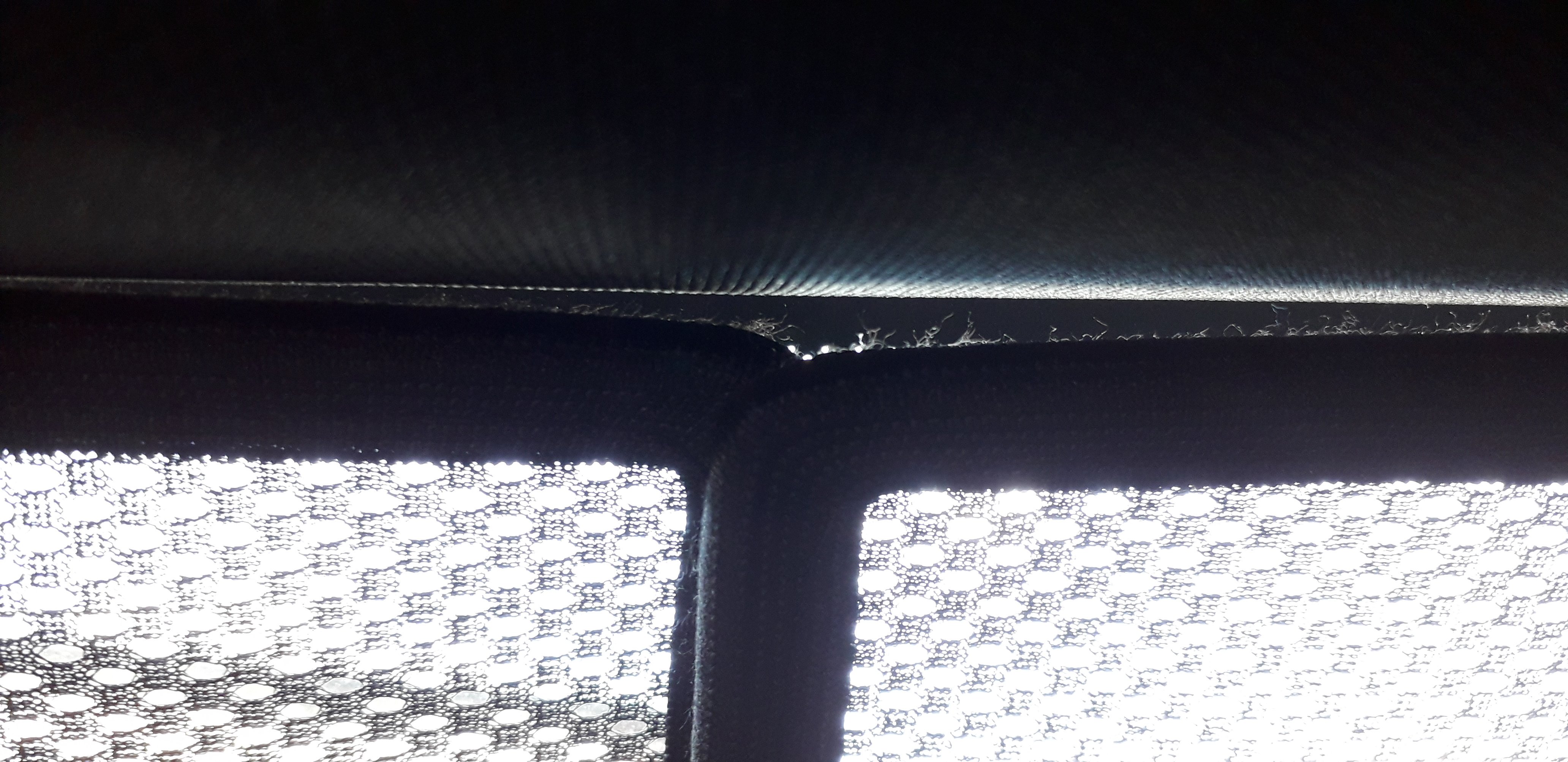

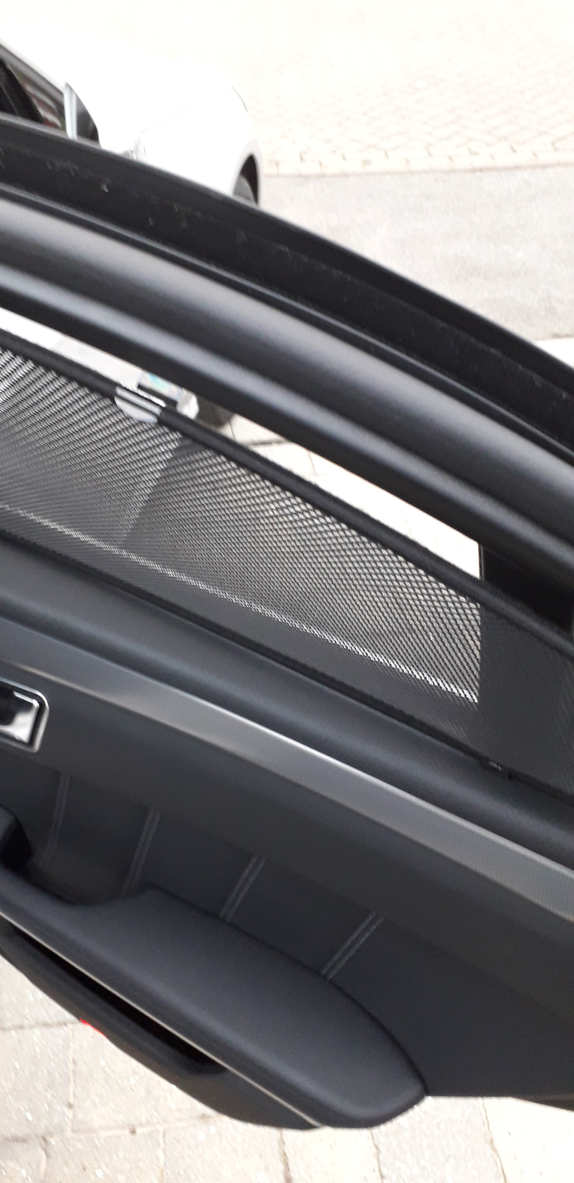

Hi all.  My offspring decided that the normal “straight” design of the blinds wasn’t to his liking.  The result is a bent blind!  Looking at them I think it’s an easy repair IF I can get a replacement bit of metal that runs through the top.  Failing that a cheap set of blinds from which I can remove the metal strip .
anyone had similar problems/fixes?

Other than that, as the OP said, it should be a relatively easy fix if done in situ as long as you're handy at unpicking (and resewing) the stitching on one end of the blind. It's a stiff piece of wire you'll need that's the same diameter as the current piece as it needs to pass through the little plastic handle that clips into the top of the window - I expect you already knew that.
Unless the current wire is badly bent, once you have it out, it may be possible to straighten it.
It seems that the current rod is 3mm in diameter, so an alternative to metal would be a 3mm fibreglass rod which can be purchased from E Bay. 3mm aluminium wire can also be purchased from E Bay but I prefer the fibreglass route as it will be straight, whereas the wire will have come from a roll and will be curved.
It also occurs to me that fibreglass would be a better replacement, because if said offspring grabs it again, it should spring back into shape rather than staying bent.

I think I will hunt down some 3mm fibreglass.  I'll report back!
