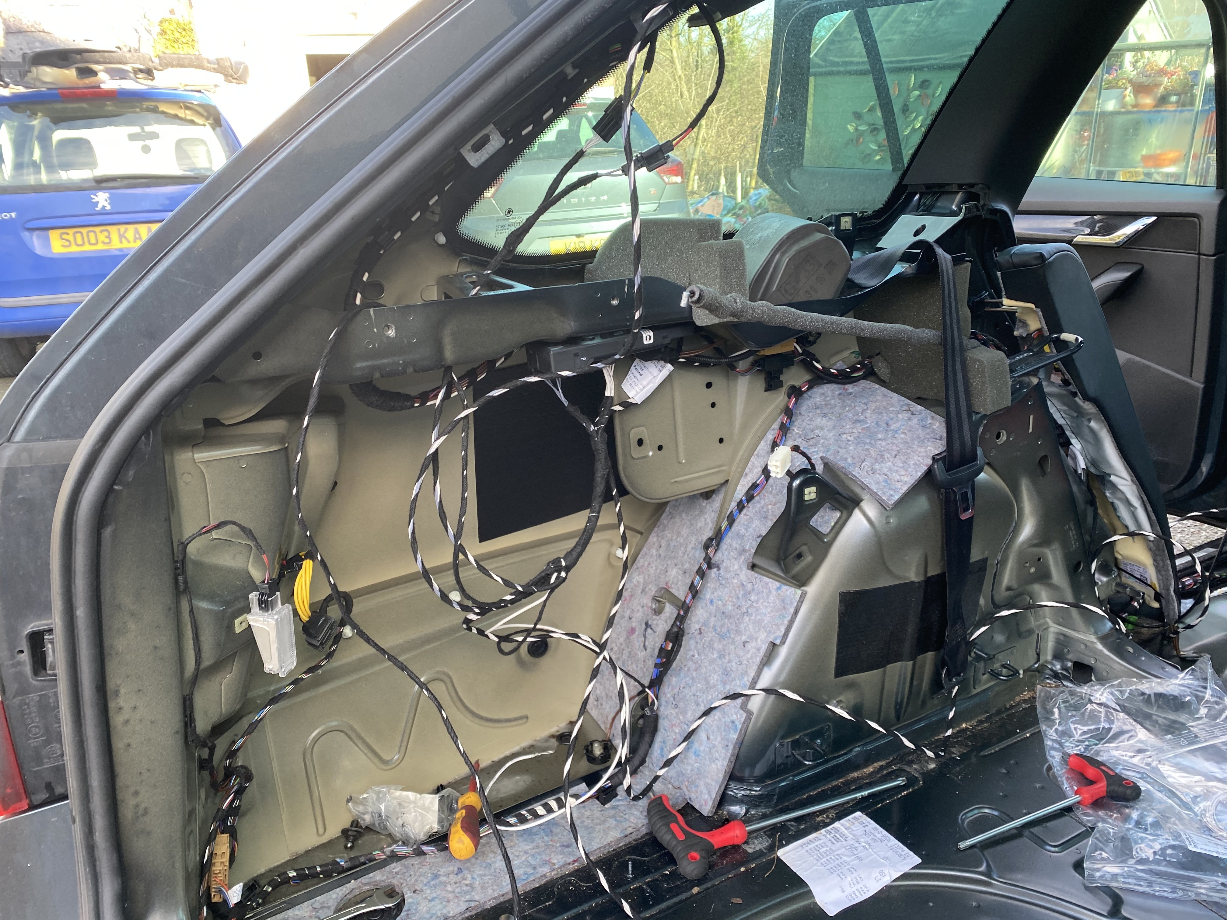

What project do you want to undertake? The space for the towbar module is behind the boot side carpet on the left side of the car (nearside UK) and it will not be there unless the car has a towbar. The BCM is responsible for lighting signals so there isn’t CAN wiring there for that but there are many CAN connection points around the BCM behind the trim panel with the bonnet release, I can provide wiring colours/pin layout for the CAN connection. You can see the wiring for the light cluster when you remove it. It will also be grouped in with the wires behind the boot side carpet as so...

There are no CAN connections in the boot area then it would seem? Any info you have would be useful, and if you could explain more what those wiring looms are for in your photo.

Interesting, please see below
If that’s unclear, the purple is for the power boot control unit, all of the white wires wrapped in cloth tape are for that (unfitted as that’s why I had this exposed for the photo), the red circle with the yellow wires is the left rear light. The yellow extension loom is a conversion loom for the FL tail lights. The blue circle shows the park sensor and right rear light signal loom that goes to the front with the power boot cables etc. The orange is the boot interior light circuit.
The CAN connections are below
You can connect to these circuits at various points. I recommend you make an account on ErWin, pay the €7 for an hour and download every diagram relating to this that you can.

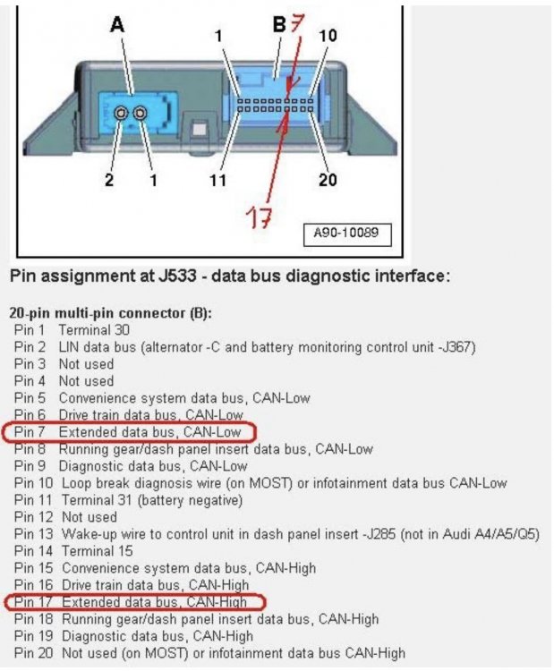

According to the linked can bus guide here and here, it looks like there are typically three can-bus networks  (drive/convenience/infotainment). It seems the lighting is on the convenience can-bus which runs at low speed 100kbps (orange/green & orange/brown wiring). So maybe I would need to connect to the J533 pin 5 & 15 to check this all out first.
I was kind of hoping that the convenience can-bus wiring ran into the boot somewhere, as it would be easier to connect everything there, and would ultimately be closer to the remote tailboard so communication would be better.
Also, I think all of this can be accessed via the normal obd2 port, in which case do all of the can-bus's terminate there somehow?

That’s interesting, hope you can find a way to make it work. I had to add the power boot CAN connection to the drivers footwell which is the best place to splice on that circuit where it comes out of the drivers door. Positive is Pin 15, orange/green and Negative is Pin 5, orange/brown. The Bus Gateway is in the drivers footwell, not far from the steering column, everything terminates there.
