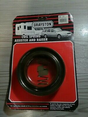

I have to access an address with a private drive which my Superb Greenline catches the underside, is there a cheap easy way to gain 1" lift?
Airride might be too expensive
spring assisters? air balls? adjustable shockers?
had the car on a 4 post lift and theres no visible reason why its low
