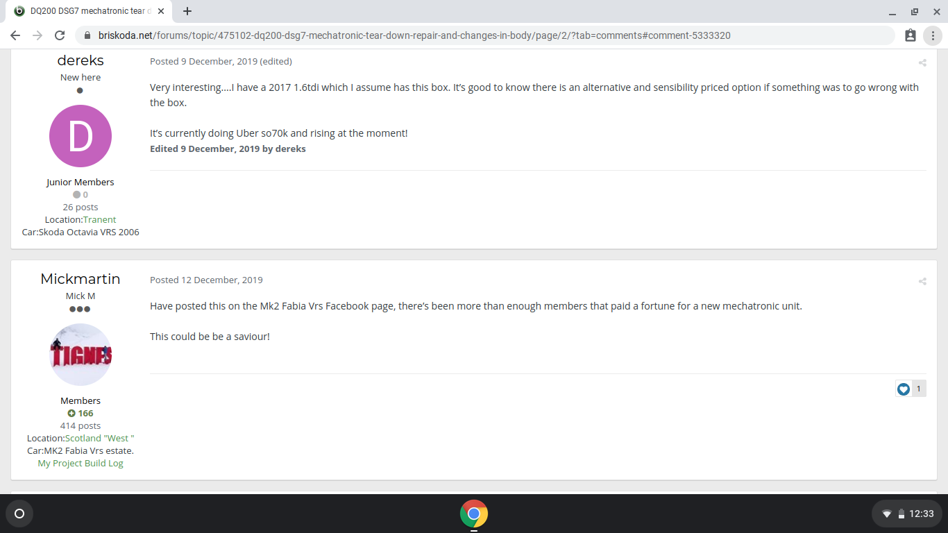

When was it last getting 10 mpg more than it is now?
How many miles has the car done and when was the Air Filter last checked or replaced and has the Fuel Filter been replaced?
EDIT.
I see over 70,000 miles and DSG.
Has there been a change of tyres over the winter?

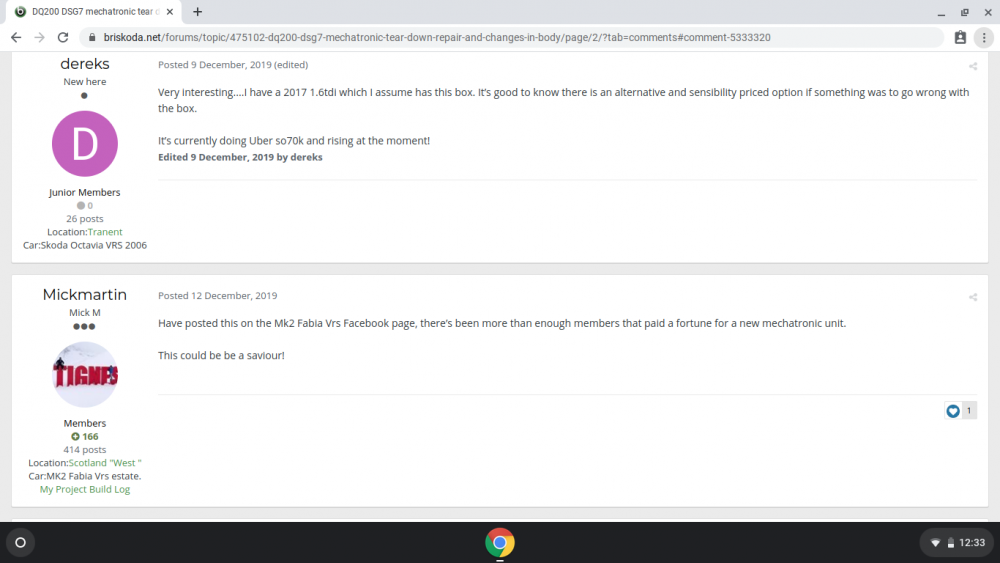

You may be on to something regarding the service no service book as it must be digital.
The car counting down to a service just now so that is due, I’ve found a couple of maintenance lists in the book pack and it looks like the last service was 28/8/18 but the mileage then was 36413 it’s now on 62000 can’t see anything being done in between.
the list don’t seem to indicate if the air/fuel has been changed only mentions the oil.
The tyres haven’t been changed.
The MPG drop was noticeable not long after the rough cold running started.
Guessing a full service is in order to see if that makes a difference the car is used for private hire but it’s only done a few thousand so far with that. I was thinking it was something to do with not getting a decent run but it’s had a few of these in the last week with no difference.
