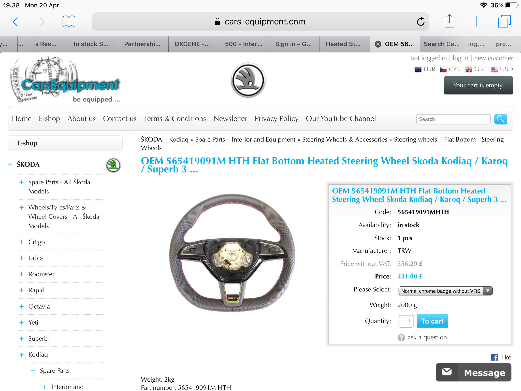

Try https://www.ebay.co.uk/itm/Skoda-Scala-Kodiaq-Karoq-Kamiq-original-MFA-Lederlenkrad-heizbar-Schaltwippen-/143449813070
Or cars-equipment.com (see attached photo).
I have one in my Karoq and I wouldn't be without it.  I am now looking to upgrade to a 2019 Kodiaq but unfortunately it doesn't come with the Sport Line spec in the UK and I can't find 2.0 Tsi 190 4x4 DSG SEL 7 seat with it already fitted.  So I might have to buy the steering wheel and get it retrofitted, if I can find someone to do it.  The wiring is already there but it has to be coded to work with the display screen.  Anyone know a Skoda dealer in the south of England who would take this on?

I’m sure many VAG independent specialists would be happy to do the work.
Thanks, I will have a look for one near me.
