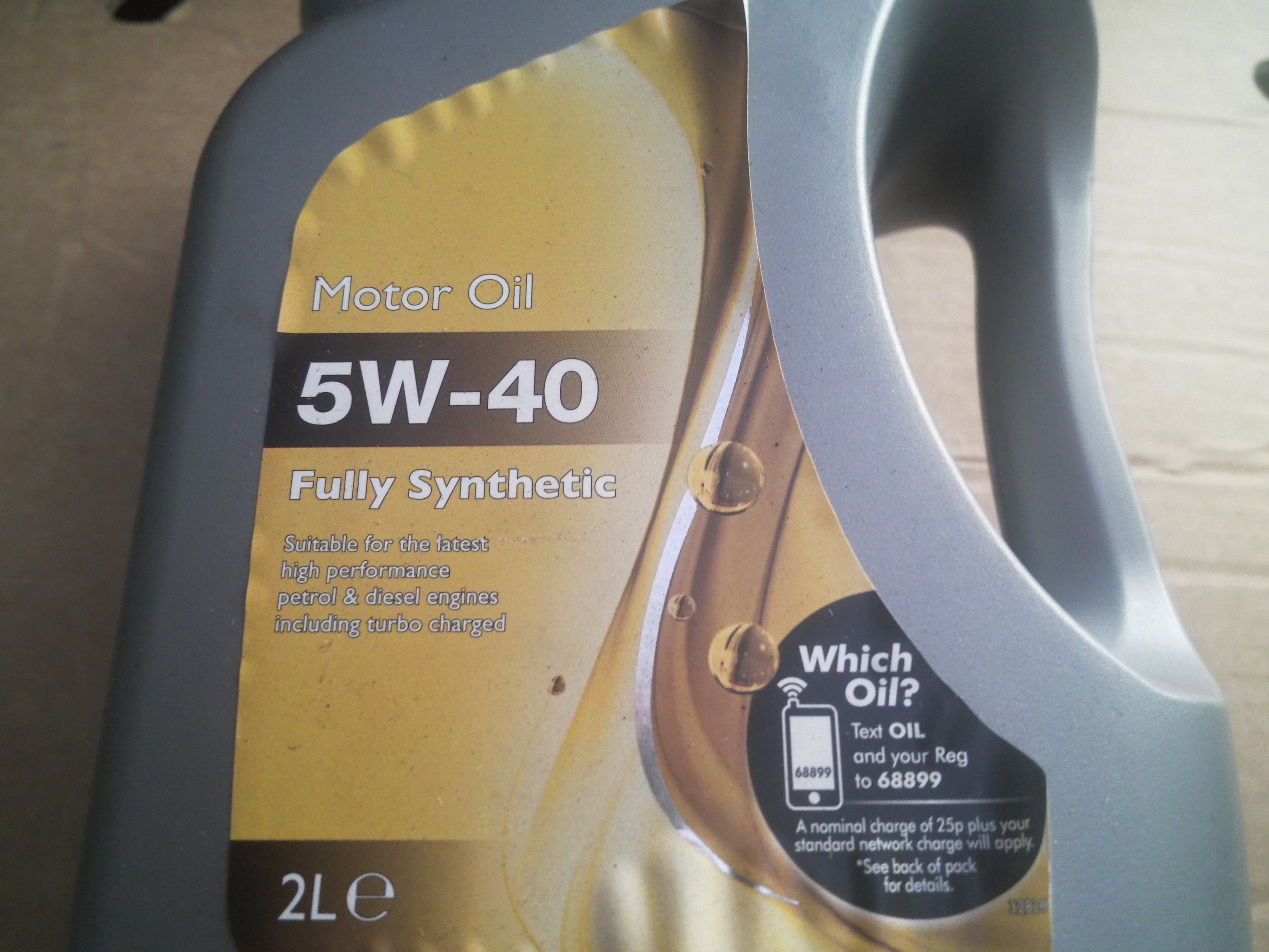

@Giff
Just 5w 40 FS
to VW 502 00.
(In the UK you can collect it in Super Markets like Asda or Tesco, Home Bargains, B&M etc, or a Motor Factors.
No need to spend more than £25 for 5 Litres in the UK, often less than that.)
