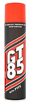

Remove the plastic wedge and squirt a very small amount of a lubrication spray down the side of the button, ideally one containing PTFE such as GT85...
