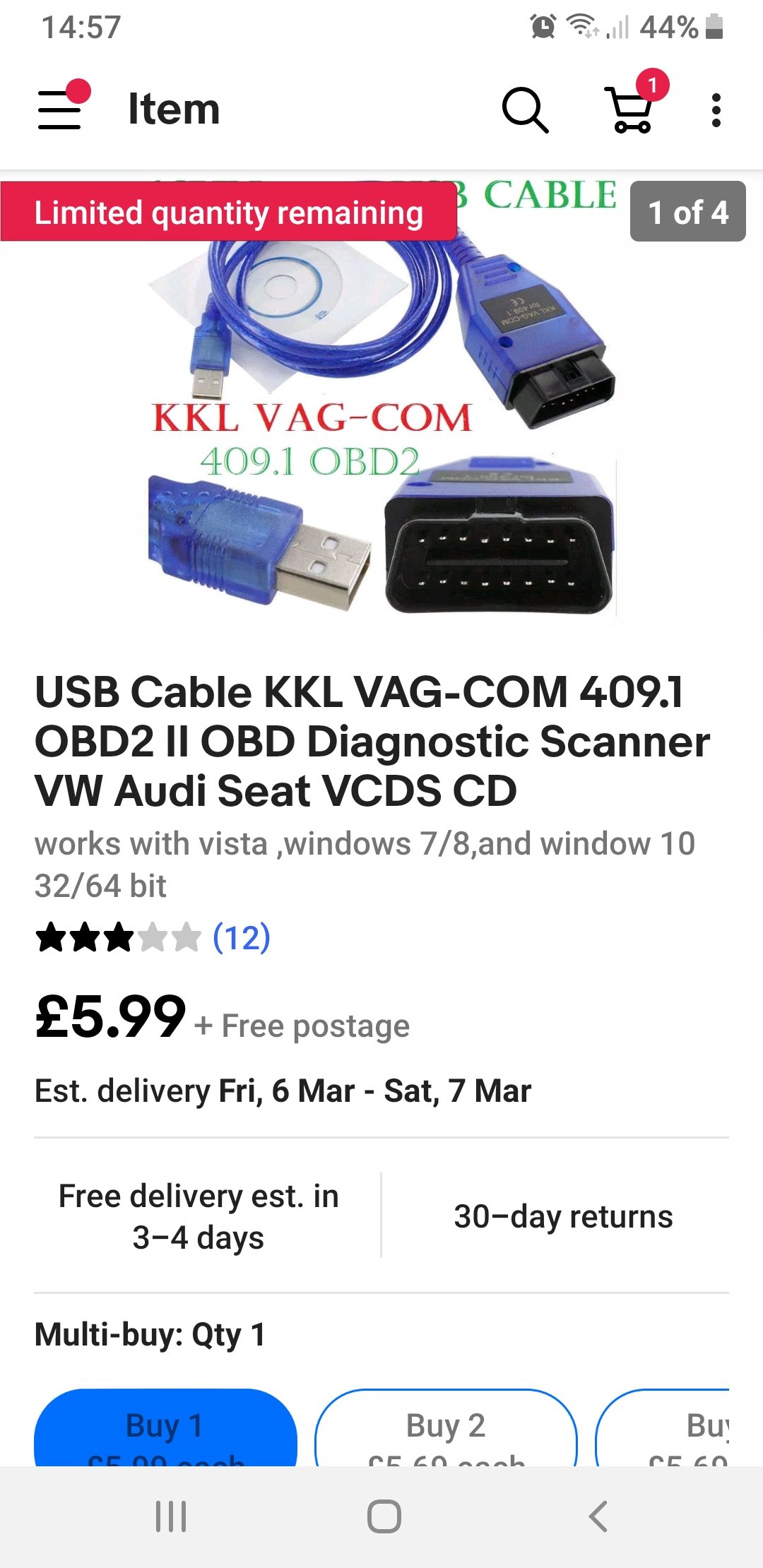

Ok thankyou, where is this map located?
45 minutes ago, Wino said:
The cheap handheld scanners won't usually scan the PAS module, which is what you need to scan.
You can buy a lead for <£20 that connects a laptop to the car and then download VCDS Lite which is free software. Or find a local member who already has this gear to scan it for you.
If you search "VCDS owners map" or something like that on here you may find someone near that you could contact.
Is this what u mean wino
Yeah that sort of thing, but I'd be tempted to download the software from the Ross-tech website rather than use that CD which might have all sorts of malware on it, and an out of date version.

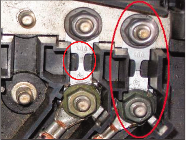

Have you checked very carefully the strip fuses on top of the battery? They can develop very tiny cracks that are hard to see but can cause intermittent connection.
Example...

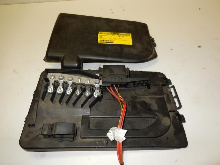

2 hours ago, StevesTruck said:
Lift the bonnet up and behind the passenger headlight, you'll see the box the battery sits in. On top of that is a small flap about the size of a fag packet
It's a lot bigger than a fag packet.

You don't need any more diagnostics, the pump is definitely failing, it's falling over once it's warmed up, a failing angle sensor gives you a code, a failing pump does not.

@TMB, the later covers are different, less 'covery everything'.
