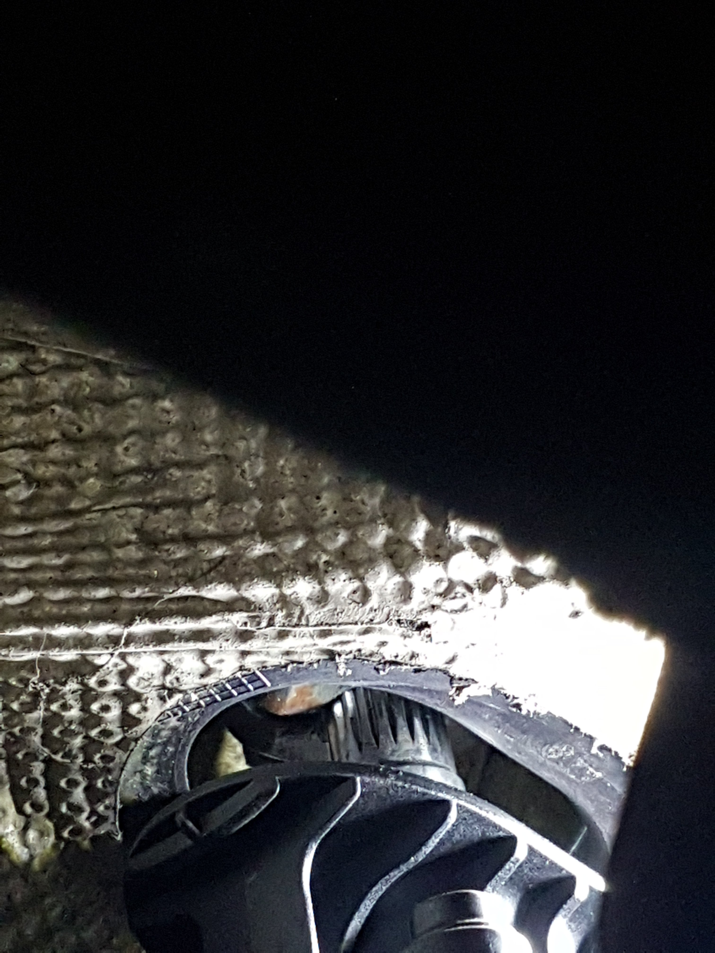

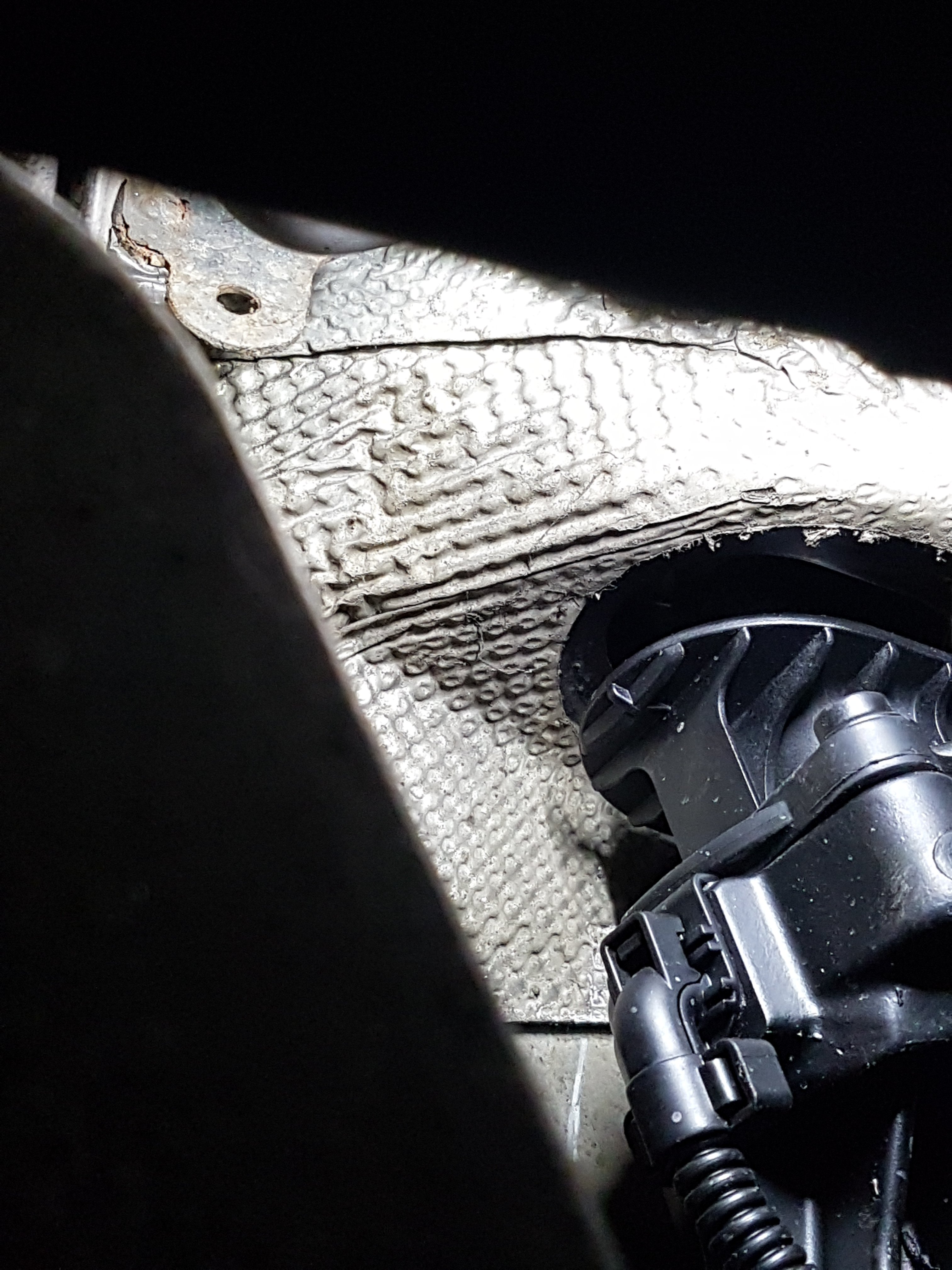

Got home tonight and put the car up on ramps to take a look.
I've attached the best photos I can which seem to suggest the reason for the added noise intrusion.
What I would like is to hear your opinions on what I should do  and say to the garage when I take the car back - that is assuming that what you see in the photos is incorrect.
Would greatly appreciate your feedbackas to me it seems like it's not the correct rack

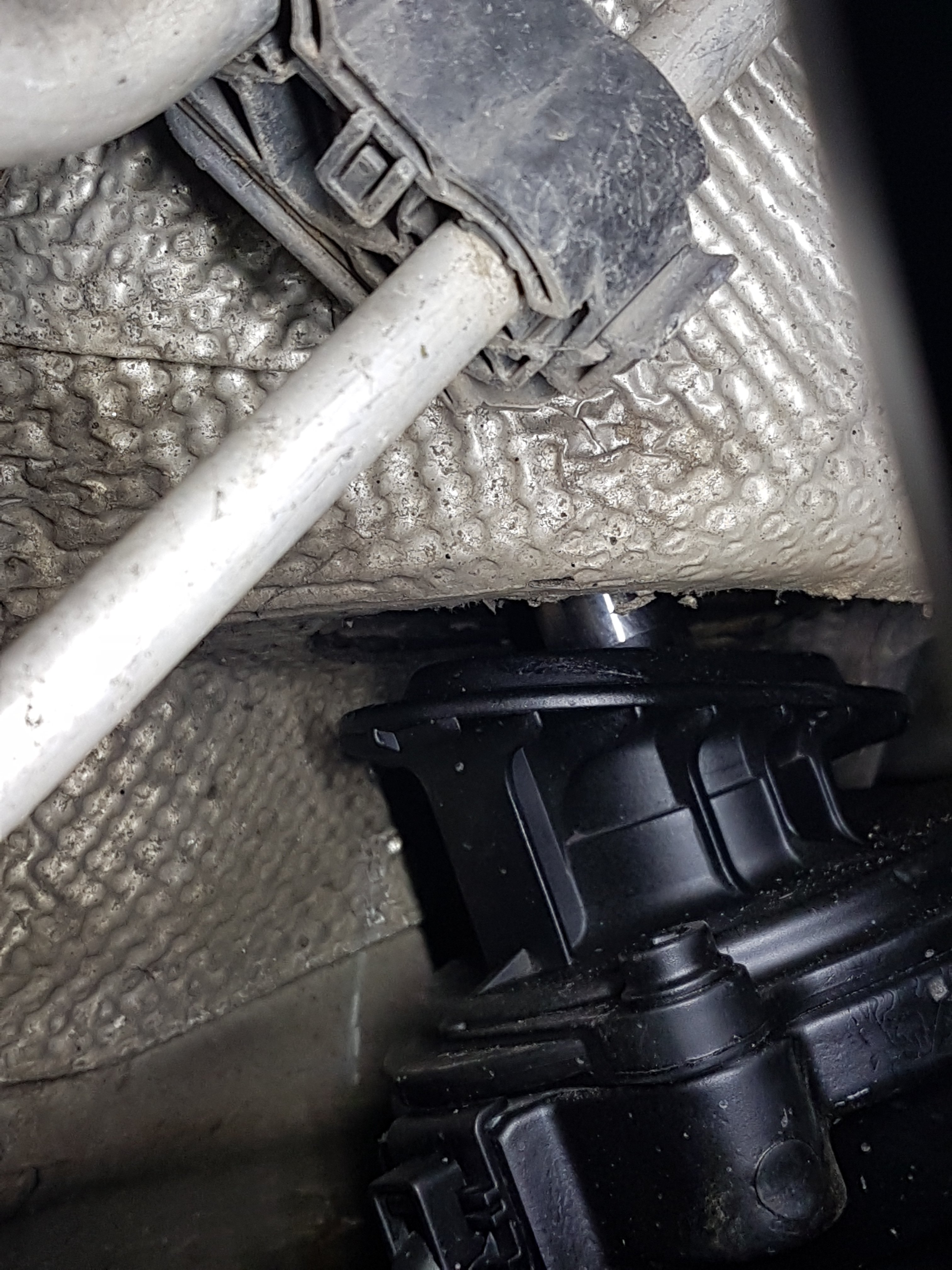

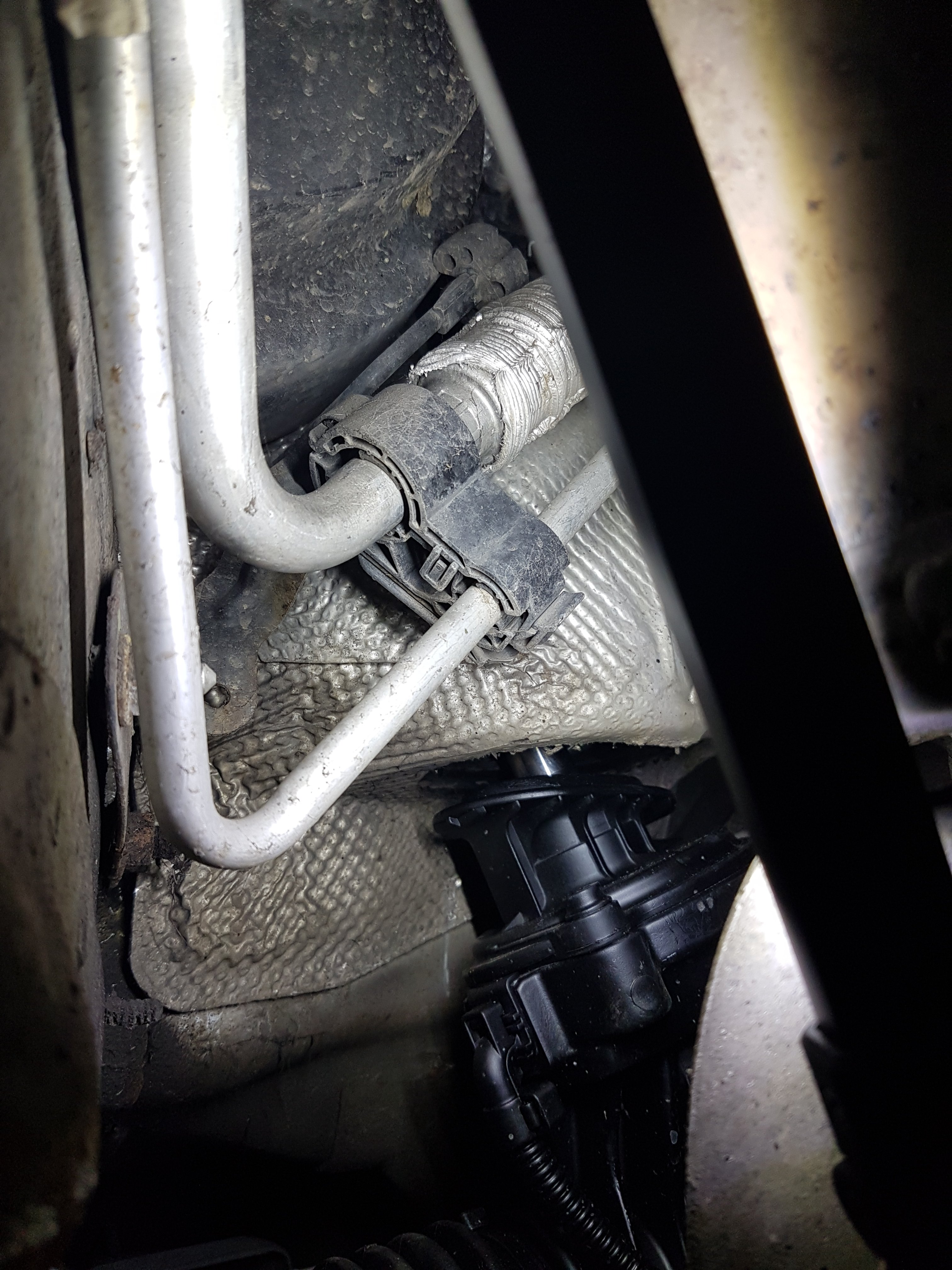

Added one more photo...
Is there something missing like the large rubber seal which sits between the rack and body..?
Something definitely isn't right there.
No wonder it is noisier in the cabin, I reckon after a weekend off the beer I could squeeze my whole body through that gap between the rack and bulkhead!

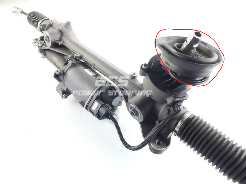

Thanks @silver1011
Looking like the original seal hasn't been refitted.
Notwithstanding the fact that it hasn't been fitted..
Would you say that it's a fire and emissions risk..?
Yeah, I'd say they've forgotten to replace the rubber boot...
And yes, I'd say that is a potential fire risk. The rack extends through the heat shields, and judging by the inner and outer seals on the rubber boot it looks pretty robust and therefore not something you'd simply not bother to replace.
