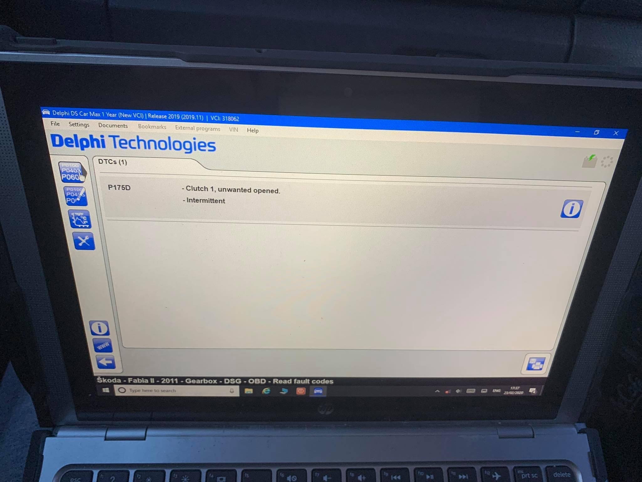

Sorry I was a little out on the code I didn’t have it too hand when I wrote the post but here is an image of the diagnostic page
P175
So a knew mech unit then and maybe a new clutch Skoda have priced the clutch at £1400-£1500 and the new mech at £1968 😂😂 thanks for the help guys think it’s new car time seen as the car is a 60 plate and done 88000 miles the help is very much appreciated thought you guys have been awesome finding all this out much obliged 👍👍
P175D - Have you noticed any oil leaks in around the box? Have a look underneath for hydraulic oil, that codes shows up quite often when the oil accumulator housing cracks and you slowly lose the litre of hydraulic oil in the oil accumulator and it loses pressure.
Also could be dead solenoid,bent/stuck selector forks as that also throws up P175D, best to look for the cracked housing that’s the most common however either way the box will need to come out to get looked at with that code.
You handy with a tool set? It’s doable on your own if you ain’t shy of taking things apart.
P17BF is the code that you can fix for £200
If yours housing is cracked you can get the full housing kit,screws and gaskets from china(unlikely at the moment due to corona) for £50, It’s around £80 from Germany without the gaskets etc but if yours are in good nick they’ll be reusable.
